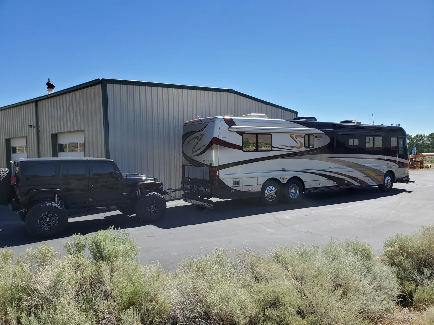

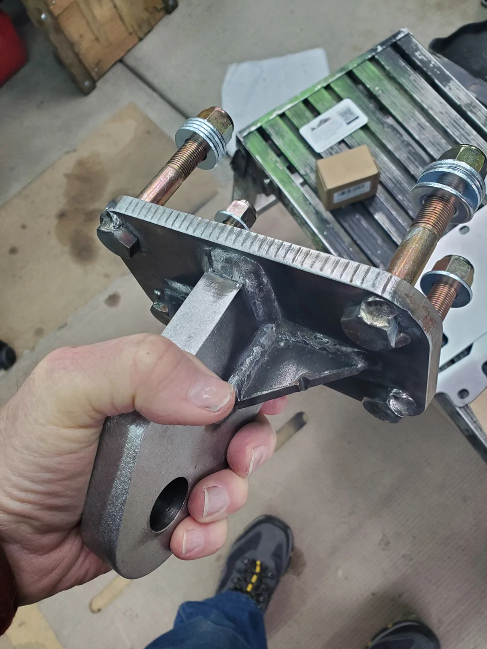

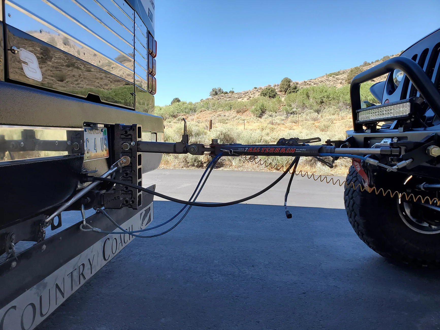

Here is what I used on the JKU and now on the JT. I bought the RVI3 used for $500 works great 60 sec install. I bought a Blackhawk 2 all terrain used for $300. Use a GenY hitch extension $350 and I braced it with some DOM to the tow frame. JKU had a poison spyder bumper so attacked to its shackle mounts. On the JT as it came with a Rubicon steel bumper I used HK Offroads tow shackles $400 which also spaced out the bumper 1" which allows installing a Zeon 12s without removing the bumper and removing the grill easily.
JT used a Curt tow harness $110 easy install.
On both the JKU and the JT used a RVI Towed battery charger with I got with the RVI3.
Curt Tow Bar 7-Way Coiled Power Cord w/ 7-Way Socket - 8' Long $90
Everything works as it should takes 5 min to hook up the jeep and tows like its not there.

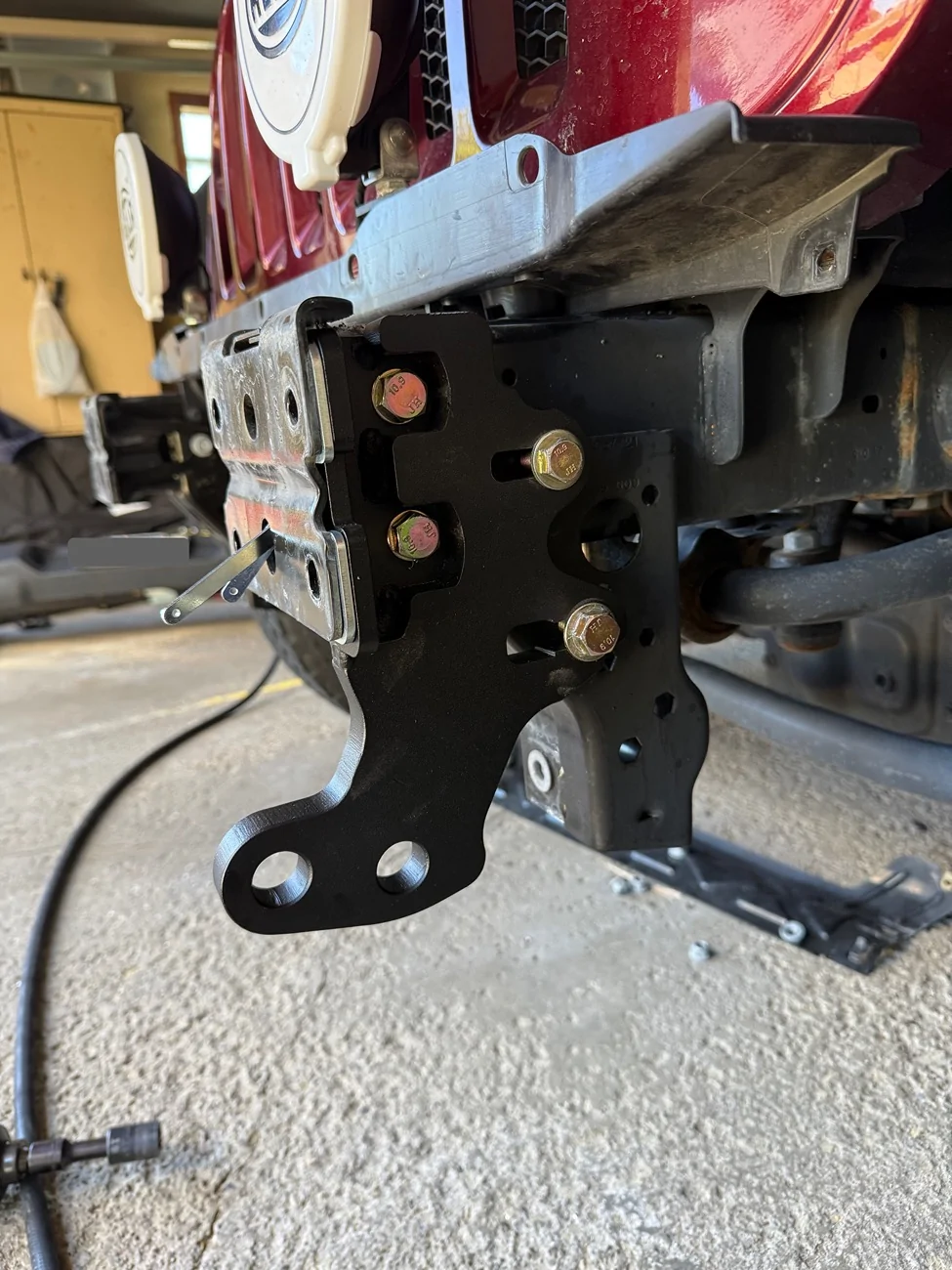

Maximus 3 tow loops on the Jeep. They bolt to the frame, but require either cutting some small holes in the lower air dam, or you could leave that part off, which a lot of Jeepers do. I cut the holes, as I wanted to keep the Jeep looking stock. (See pic)

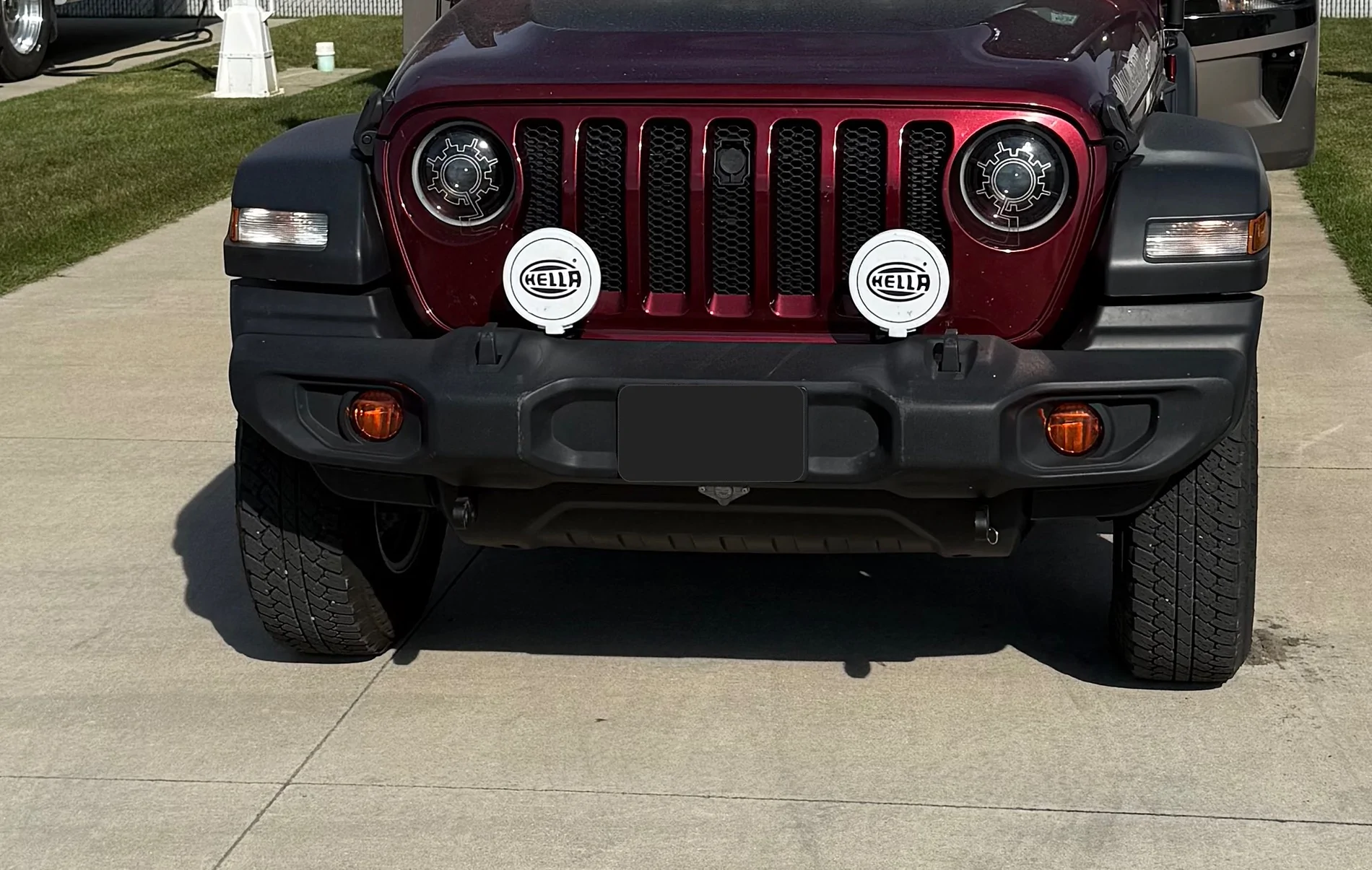

I’ve considered the Maximus tow loops but didn’t want to cut holes in my front skid. Please elaborate on what parts you mentioned Jeepers leave off. Doesn’t affect the towing?
au176
Mar 18, 2021
677
837
WNY
2021 Islander, 2020 Newmar Ventana, 2014 HD Road King
Tired again

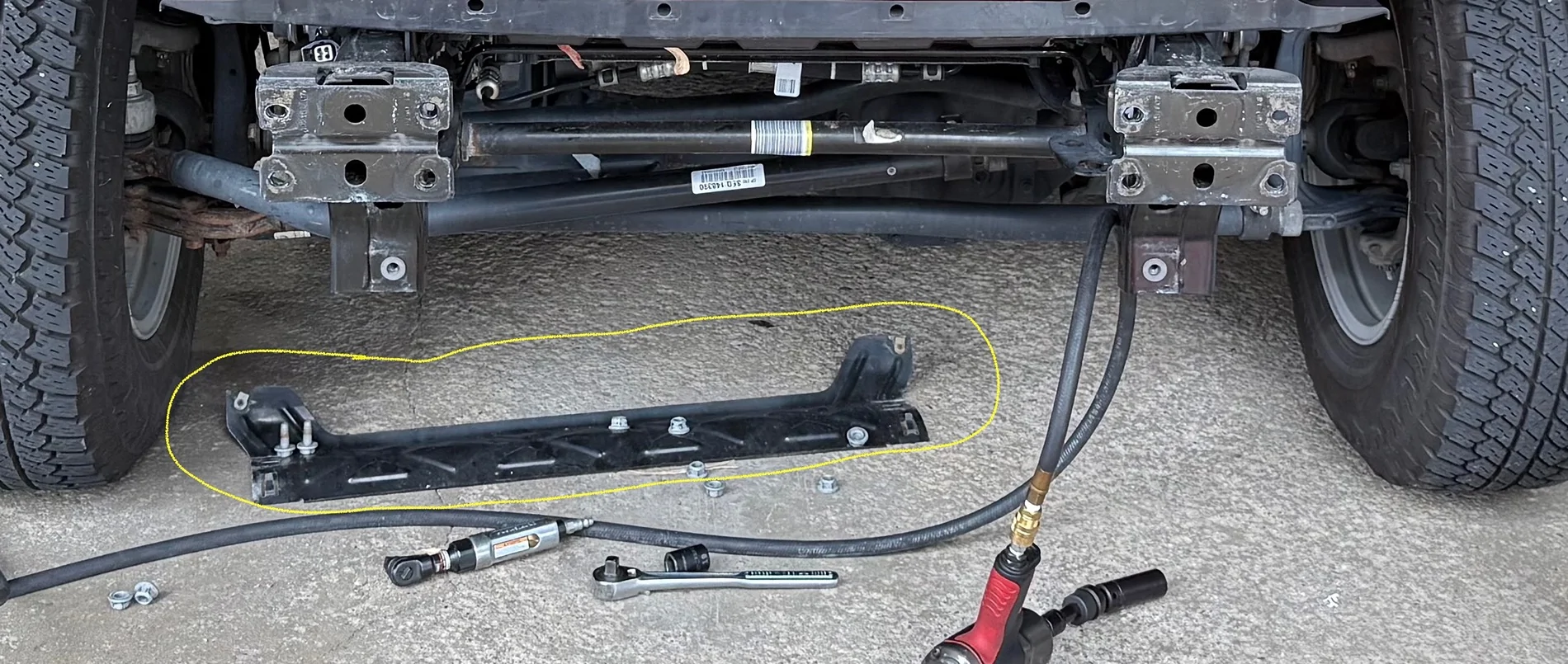

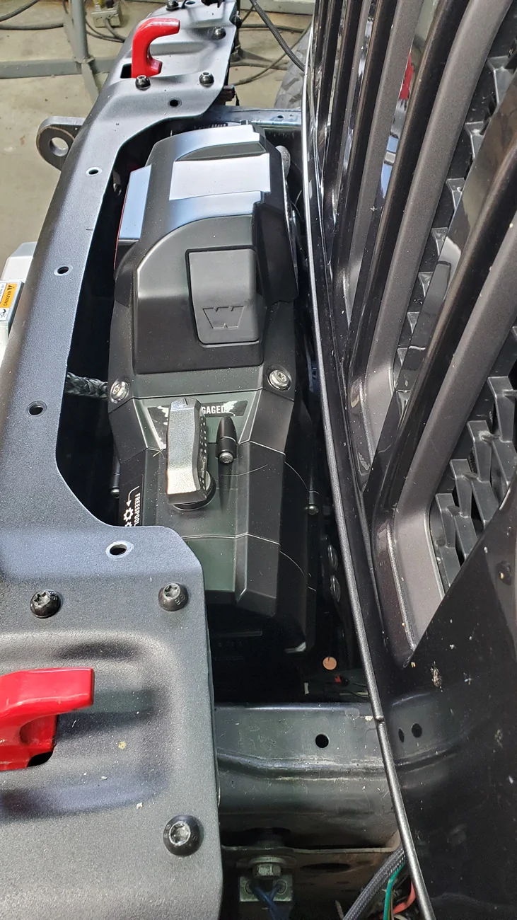

I'm referring to the big plastic air dam under the bumper in my original pic. Also, there's a smaller metal plate behind that (see 1st pic below) that I had to notch. Neither of those would qualify as a skid plate.
When people start to do any mods to their Jeeps, that air dam is often the first thing to go.
In the other pic, you can see the tow loop mounted to the outside of the frame rail, and there are other supporting plates on the interior the frame rail itself. Everything between the frame rails is stock, so as long as your skid plate is between the rails, you are probably ok.
My suspension and bodywork is pretty much stock, so YMMV if you have any modifications...
