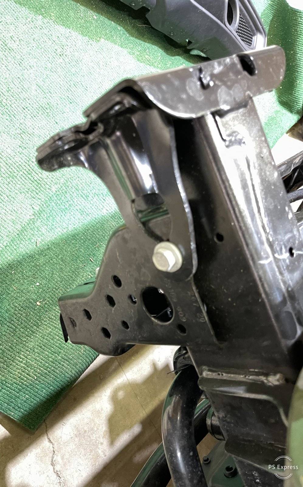

If that is you, I have an update for those with newer JL's. My '21 Rubicon came with the plastic bumpers, and after doing a good deal of research, I decided on an aluminum RockHard mid-width. I was fully prepared to order the LOD brackets, but after talking to the great folks at Rockhard, they said I didn't need them since Jeep has already added the additional bracing. Took my old bumper apart, and they were right. See the attached pic.
Where is the additional bracing that bracket has been there from day one and Mopar still says you cannot tow from the bumpers mounting points.

My question is if a LOD bumper fails what will LOD pay for or take care of. If a weld breaks and damages your RV will they pay for it. If your jeep breaks loose and hit another vehicle is LOD responsible.
It is more likely the connection to the Jeeps frame mount will fail before the bumper itself. Which is Why Mopar says to not tow from any Bumper as the connection is only sheet metal. However if you use the frame Tie in bracket you are likely OK.
Get the Maximus 3 Tow Loop, best available and attaches exclusively to the frame.
