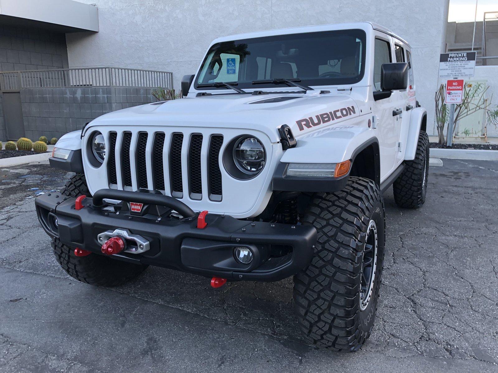

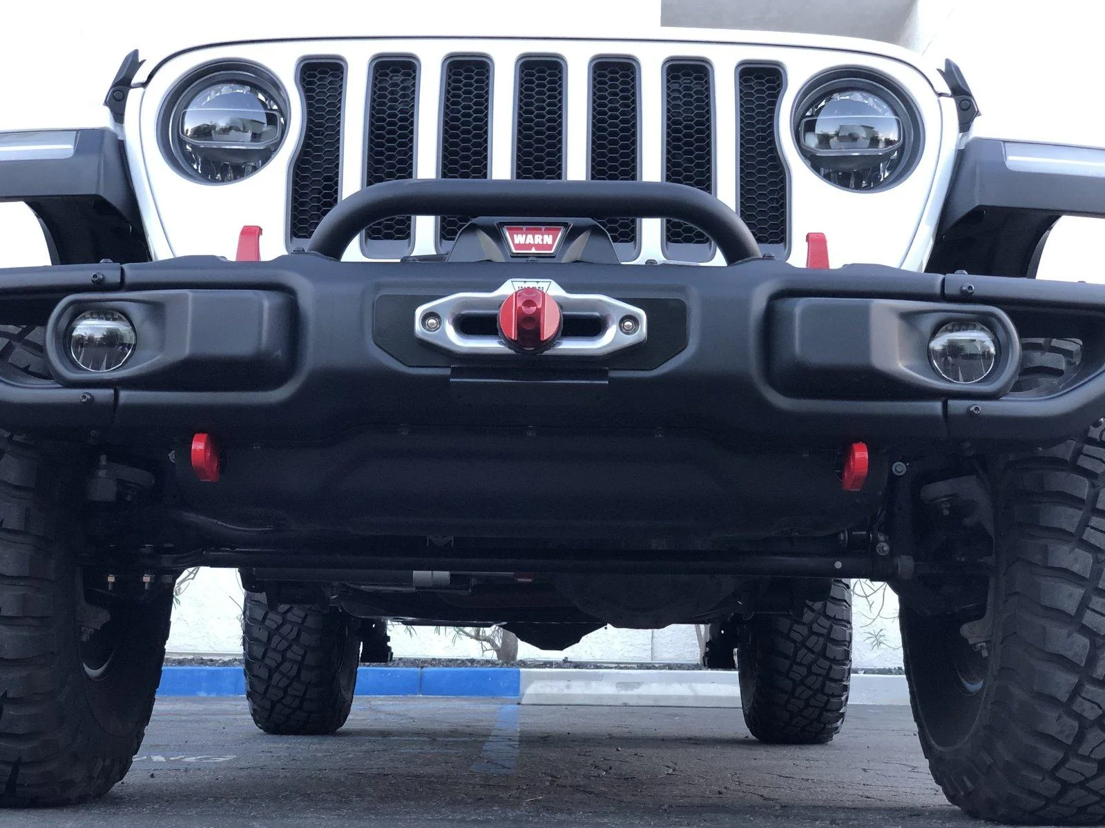

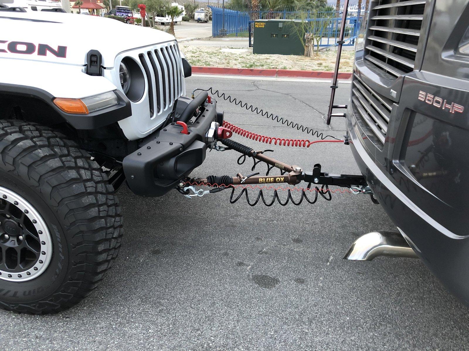

Or you could go this route. Bear in mind I have yet to hook it up to the RV so I can't comment on the differences between these (Maximus-3 Tow Loops) or they typical base plates on the market. What I will say tho is that this is a much cleaner install which omits the sightly bar below the bumper.
That looks good. How soon before you connect with the RV? Very interested to hear how it works.

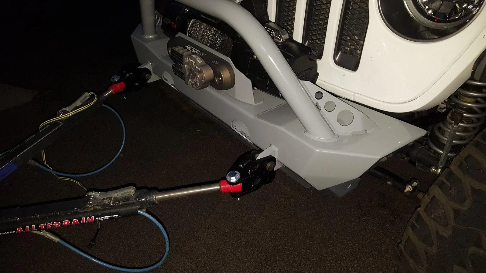

I connected the my Jeep to the RV this weekend and towed for about 200 miles. All aspects of the towing setup worked flawlessly. The Maximus-3 tow loops combined with their Blue Ox adapters, fit together like an expensive Italian suit. I couldn't be happier with the set up and love the stealth nature of how I have it all configured. When the breakaway cable is tucked away behind the bumper, there is nothing that screams this is a toad! It's been quite the journey getting it all set up but it's been worth it!

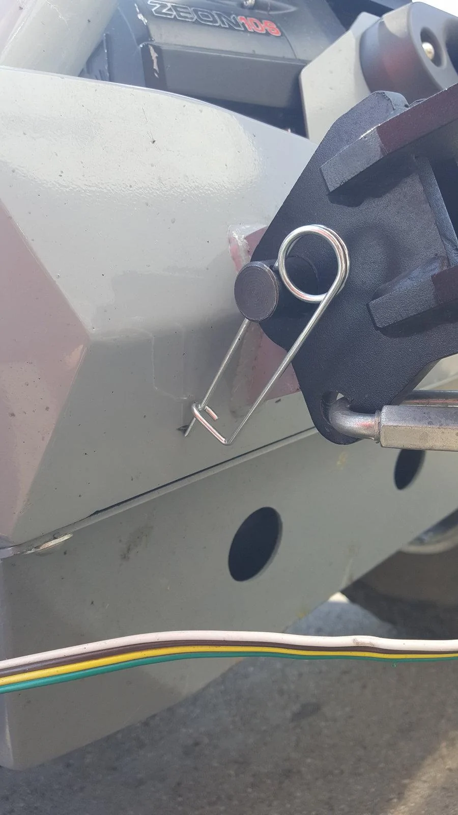

This is working pretty well. We just ended a 10,000 mile trip across the country, towing all the way. I have had 2 small issues to deal with - neither of which is very serious and absolutely not a safety issue.
1 The safety pins that LoD sends with their tow bar brackets are very long and tend to rub against the bumper. Mine wore a bare spot in my powder coat. Pic attached I replaced these pins with 3/16" round safety clips from Ace Hardware.
2 The tow bar brackets fit very well onto the d-ring brackets when they are new. However after many thousands of towing miles, they have spread open just a little (maybe 1/8") causing a little slop in that connection.
This is the same setup with our new JLUR we want to do. I currently have the plastic bumper. And was planning on purchasing the steel and Maximus-3 tow hooks.

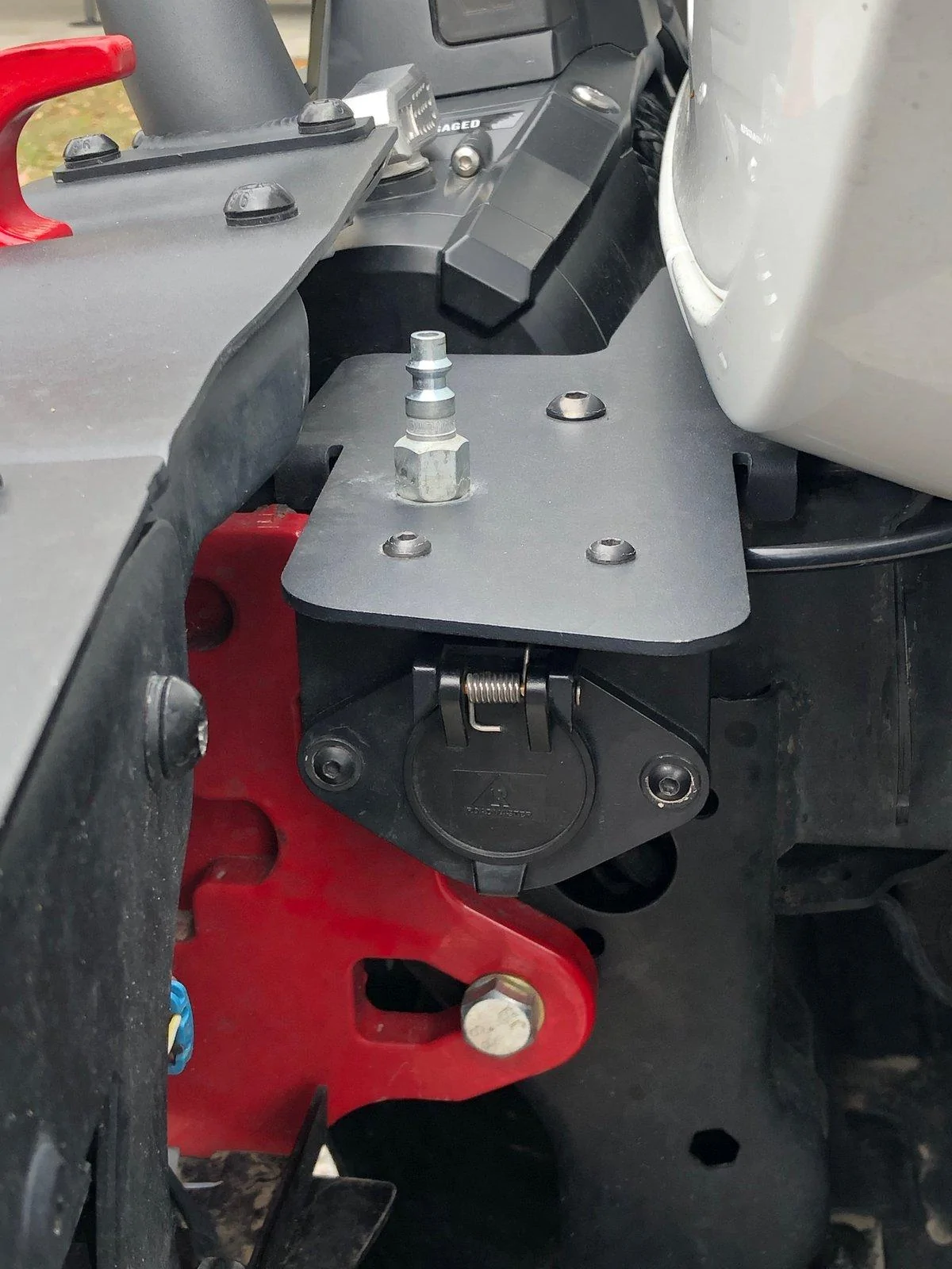

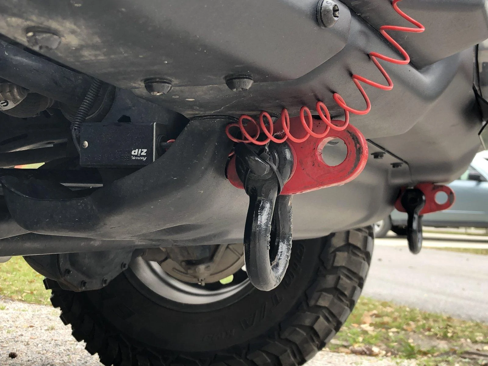

There are 2 holes on the Maximus 3 Tow Loops. The front hole is used for the tow bar and the rear for the safety cables. Ive got D rings attached to the rear hole and simply clip in the hooks when towing. After a 1700 mile drive across the country I noticed that one D ring was unscrewed and inches away from falling off so now I have some zip ties attached to the bolts that go through them.
As for the lines, the red one is to tie the brake/lights to the toad and the other (black) is for my supplemental air brake system (M&G 2.0). Both lines are routed to a (semi) hidden section on the drivers side of the front bumper. I used a Maximus filler plate for Zeon Winchs and fabricated a supporting bracket underneath to combat the forces the air and wire lines place on it. My goal was to hide the connection points as best as I could so the Jeep doesn't look like every other toad on the road. Mission accomplished ;)
And yes, your pretty red tow loops WILL get beaten up after a few hundred miles of towing.
