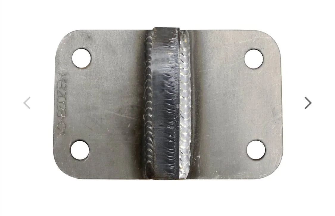

Edit: Now that I look at it, it looks like the front of the frame where the tow hooks mount isn’t a flat surface?
I was thinking something like this mount with the LOD frame tie ins.
Jeep Wrangler JL Flat tow mount options IMG_3492
Or some other form of similar frame reinforcement.

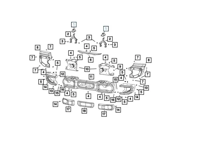

The Jeep bumpers have metal cans welded on the mounting plate the precludes using the frame horns as a place to mount tow brackets. I tried to modify a plastic bumper and it looked like poop. Even if you get the tow brackets on the bumper somehow, you still need a place for the safety chains. Rockhard has been my go-to solution.
Part #10 is the mounting plate for the metal bumpers. Isn't it hilarious how many parts are used to make the bumper?
