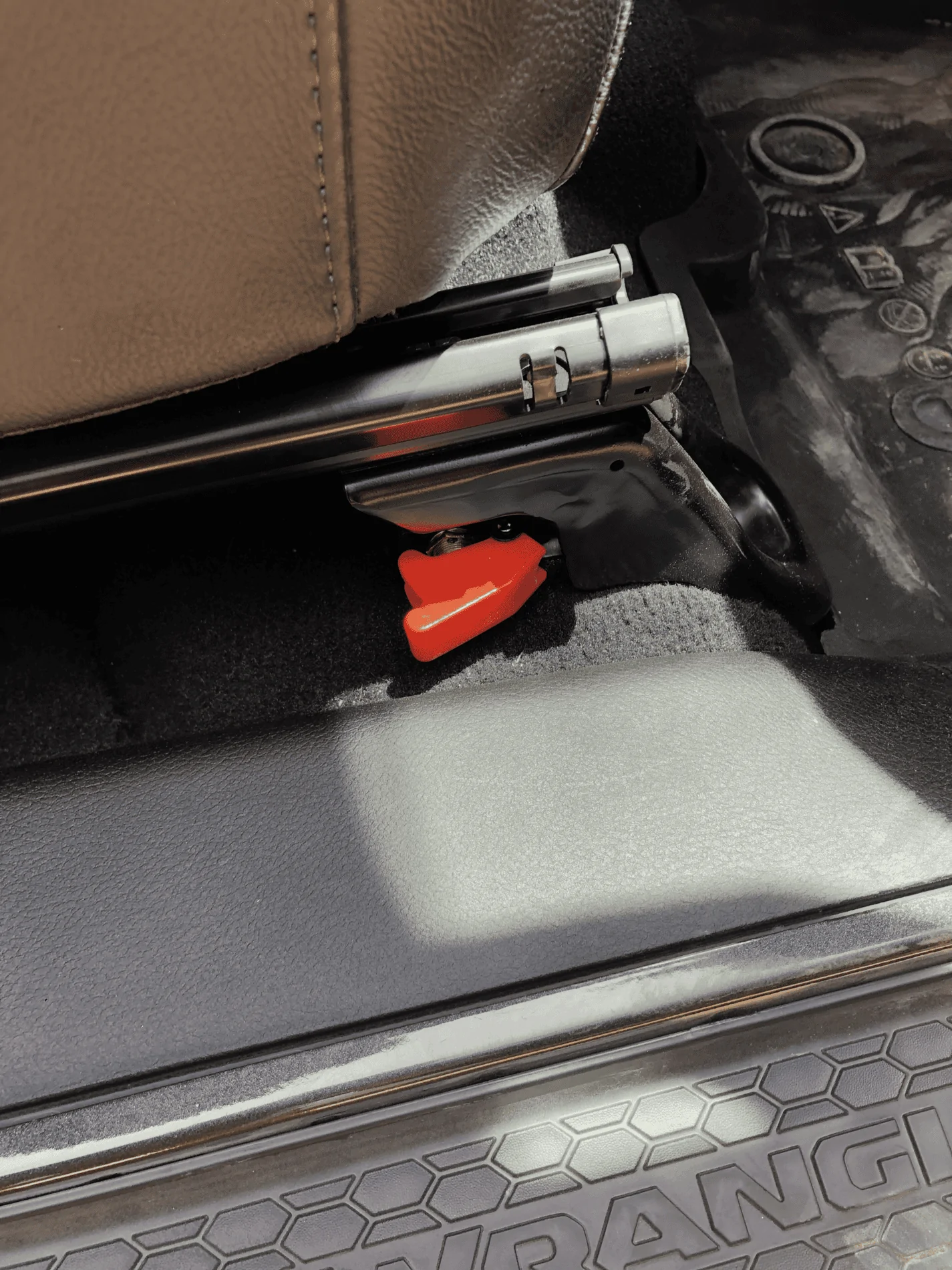

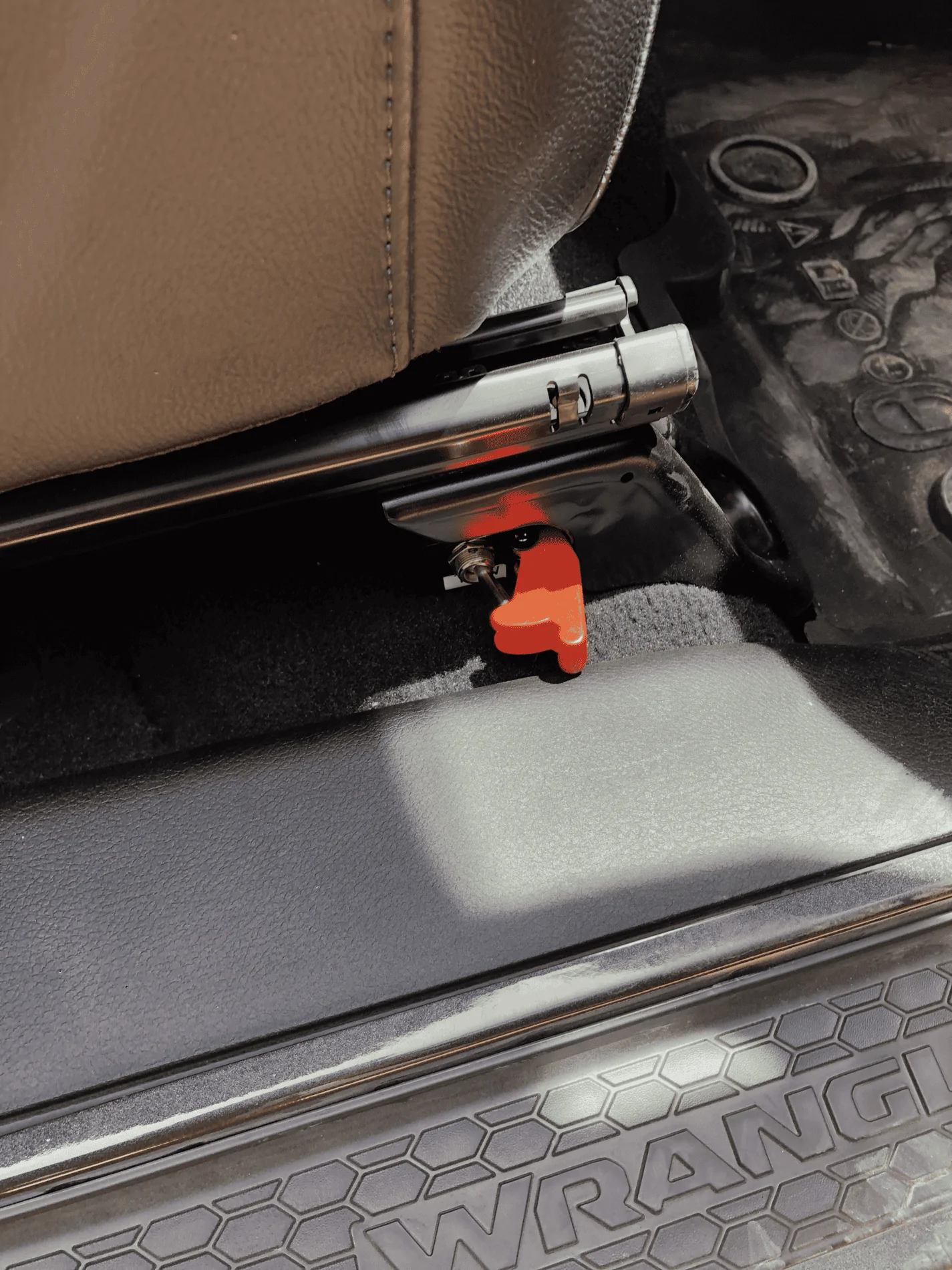

For anyone else interested, we've had a few instances where the switch was accidentally flipped to "Tow" when someone was entering the Jeep on the passenger side. Our harness came with "Jeep" being in the upward position and "Tow" being down, which seemed kinda odd given I'd rather have it accidentally in "Jeep" if anything. Regardless, I ordered one of these switch covers, rotated the switch 90 degrees, and set it up so the cover protects the switch when it is in "Jeep" mode.

Are there any more protected locations to install the switch?
Perhaps up behind glove box or under the seat?
My harness is coming this week.

The way the harness and wiring is set up, it's designed for the switch to mount under the seat bracket on the passenger side and all the wiring is under the plastic cover you see between the switch and the door sill. I'd assume you could route the switch elsewhere, but you'd have to add your own wiring extensions to do so. I like having the switch where it is, but I didn't like the accidental switching of it. The cover I added was < $7, which seemed cheaper than buying wire to move it elsewhere.

Very nice, sensible, functional, clean mod to the Cool Tech offering. Looks good!
I'm sure Kendal, @CoolTech, LLC would say the same.

Perhaps you could take a minute to post here what was involved in the placement/install of that switch cover for those that are interested..
