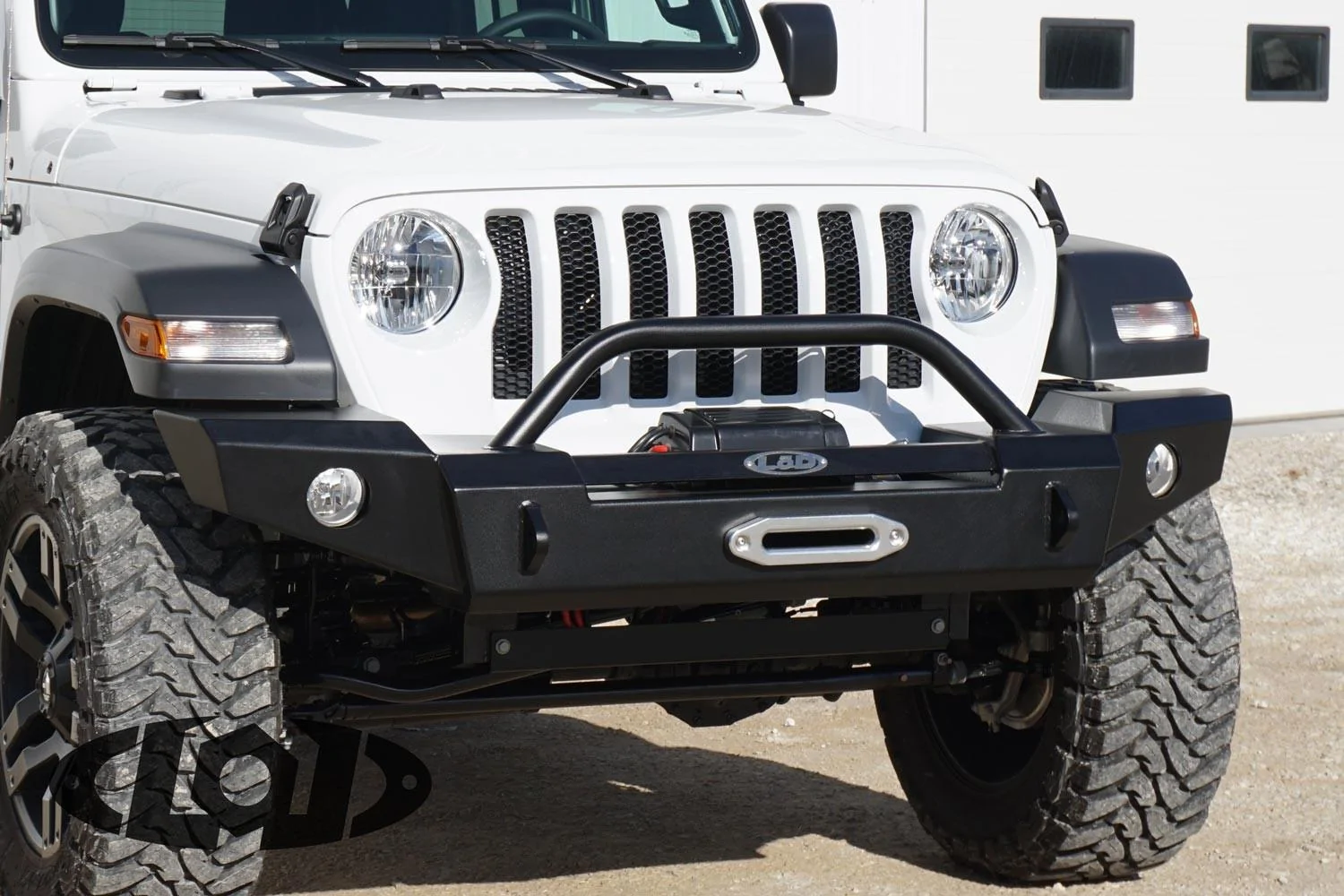

I Love My LOD bumper. I will be flat towing across Canada this summer. I have full confidence that my LOD bumper will work fine.
The bumpers are fine it is the wrangler frame mount that is weak which is why LOD created the OPTIONAL support brackets they announced on the previous page.

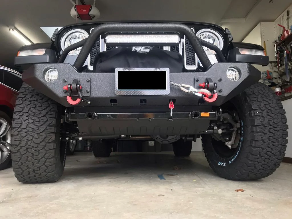

I ordered the Rock Hard 4x4 Patriot Full Width in Aluminum, as well as the LOD frame tie in brackets. This should give me the light weight awesome bumper I want, as well as make it safe for towing behind my RV.
Bumper rated for flat towing - check
Frame to bumper mount reinforcement - check
Will let everyone know how well the brackets work with a non LOD bumper. (looks like they should work with any bumper)

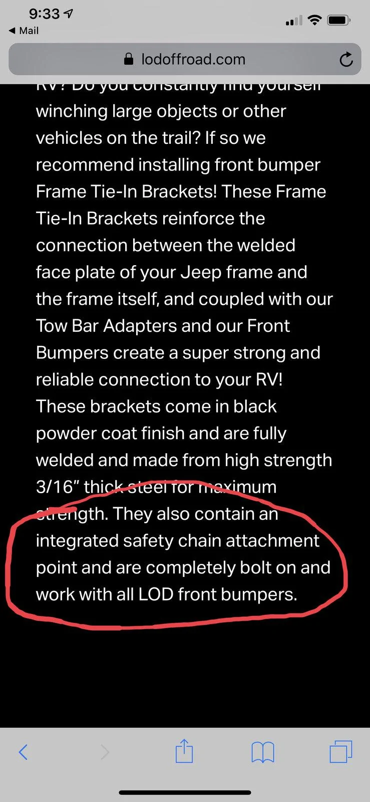

you should be good to go, that is the route I would have gone had it existed last year., With that said though where would you attached the safety cables since the aluminum bumper on its own is not strong enough for that. It is too bad the Tie in brackets does not have a added safety cable attachment so they too tie to the frame...
LOD brackets do have a spot for the safety cables.

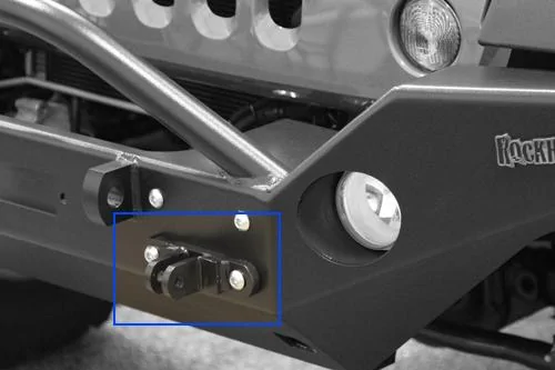

The other issue I had with the Rock Hard is the tow connection on attached to two of the 4 bumper bolts making it an even weaker unbalanced connection (pictured below

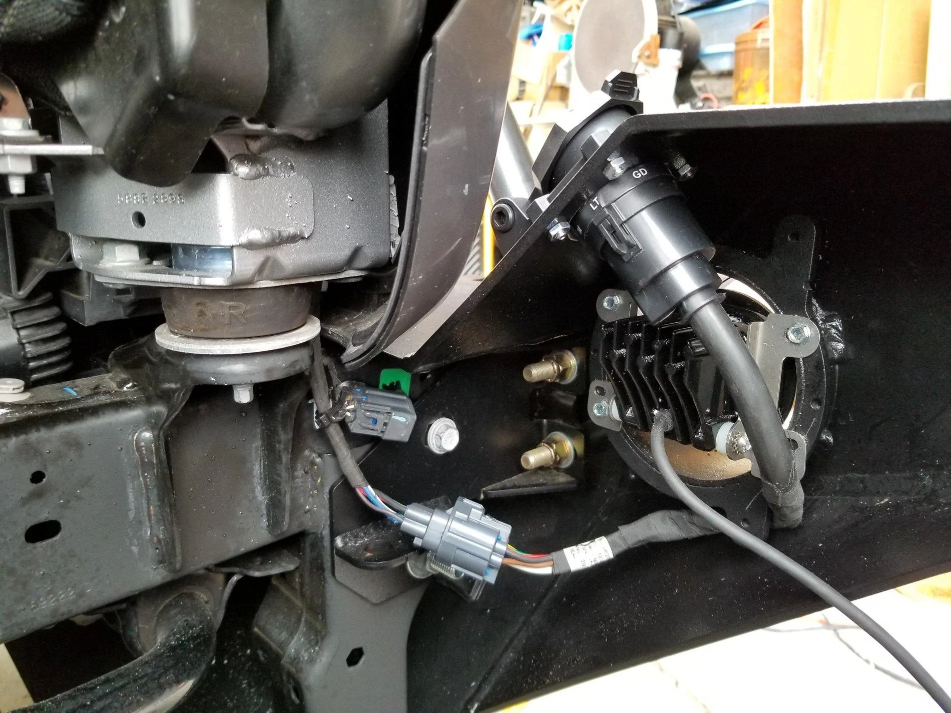

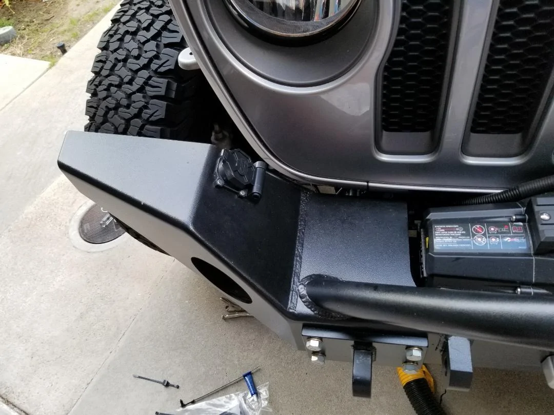

Loved the idea of the socket in the bumper so i added one to mine in the same location. Only difference is that i soldered mine to the jl flat tow harness so that i can connect to either.

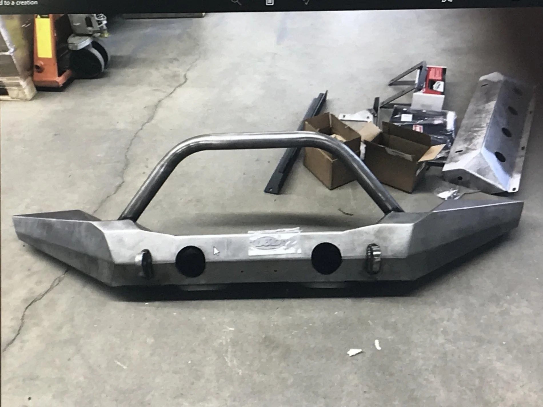

What bumper is that ? I don't see it on their website
