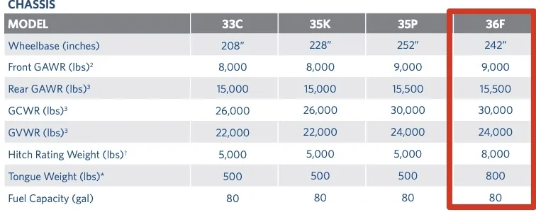

I would suggest you have equal or bigger issues, assuming that Gasser motorhome in the background of your picture is what you tow with, and considering you have many upgrades to your Rubicon including skids, your Wrangler exceeds the towing limitations of your RV. With that said it is clear safety is not a concern to you.
It is unfortunate some to not take these issues seriously.
@AFfiredawg - he’s insulting your motorhome. It’s all out war now!
Making assumptions about my setup that he has never laid eyes on just makes himself look even more like a moron than he already has...
Jeep Wrangler JL Flat Tow winch bumper options upload_2019-3-4_18-4-8
