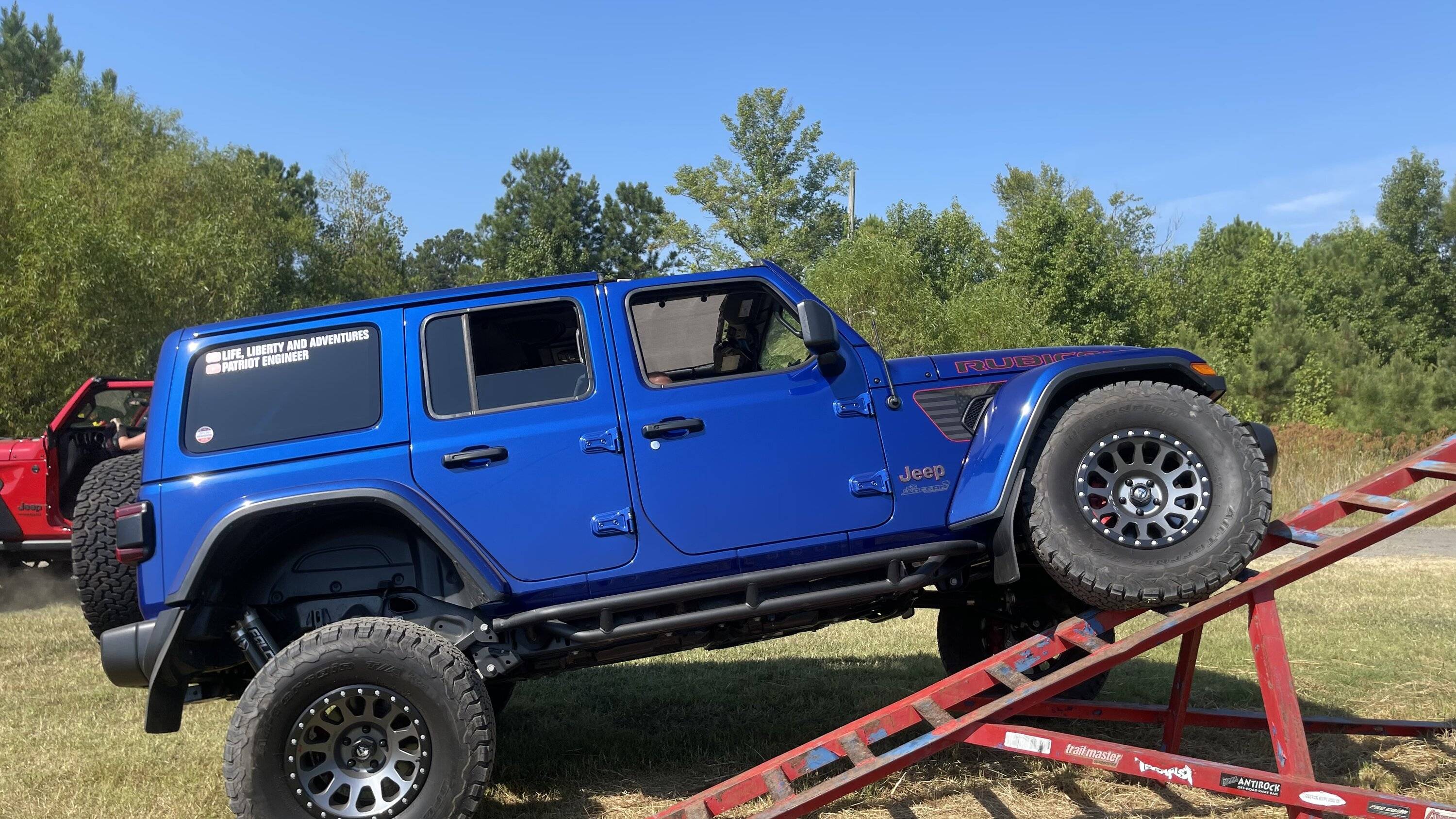

At the Ocean City Jeep Week at the end of August, I went up the articulation ramp they had setup at the Jeep Jam playground. I’ve never done this yet, so I’m curious if this articulation is good or does it suck? I believe I could have gone up farther since all the tires weren’t off the ground.

Looks good to me, tucking up in there. What lift are you running and did you get a pic of the driver side?

Looks good to me. It probably has a ways to go in real trail articulation.
I don't have a kit, but I am using the parts below. I may have a drivers side pic, but will have to go back through the pics and videos. My girlfriend was being photographer and videographer. :) There was a line of other Jeepers waiting to get on the ramp, so I didn't want to waste too much time.

Do you have a pic of the other side on the ramp ? You mentioned you’re using the sway links from the Mopar lift, your shocks extend 2 ish inches more than the Mopar lift shocks. If you’re using the electronic disconnect you might be getting to straightened out and have a chance of sway bar inverting….
I'll have to check all the pics and vids for something on the drivers side. I did use the electronic disconnect. I'll have to look into that. Thanks!
