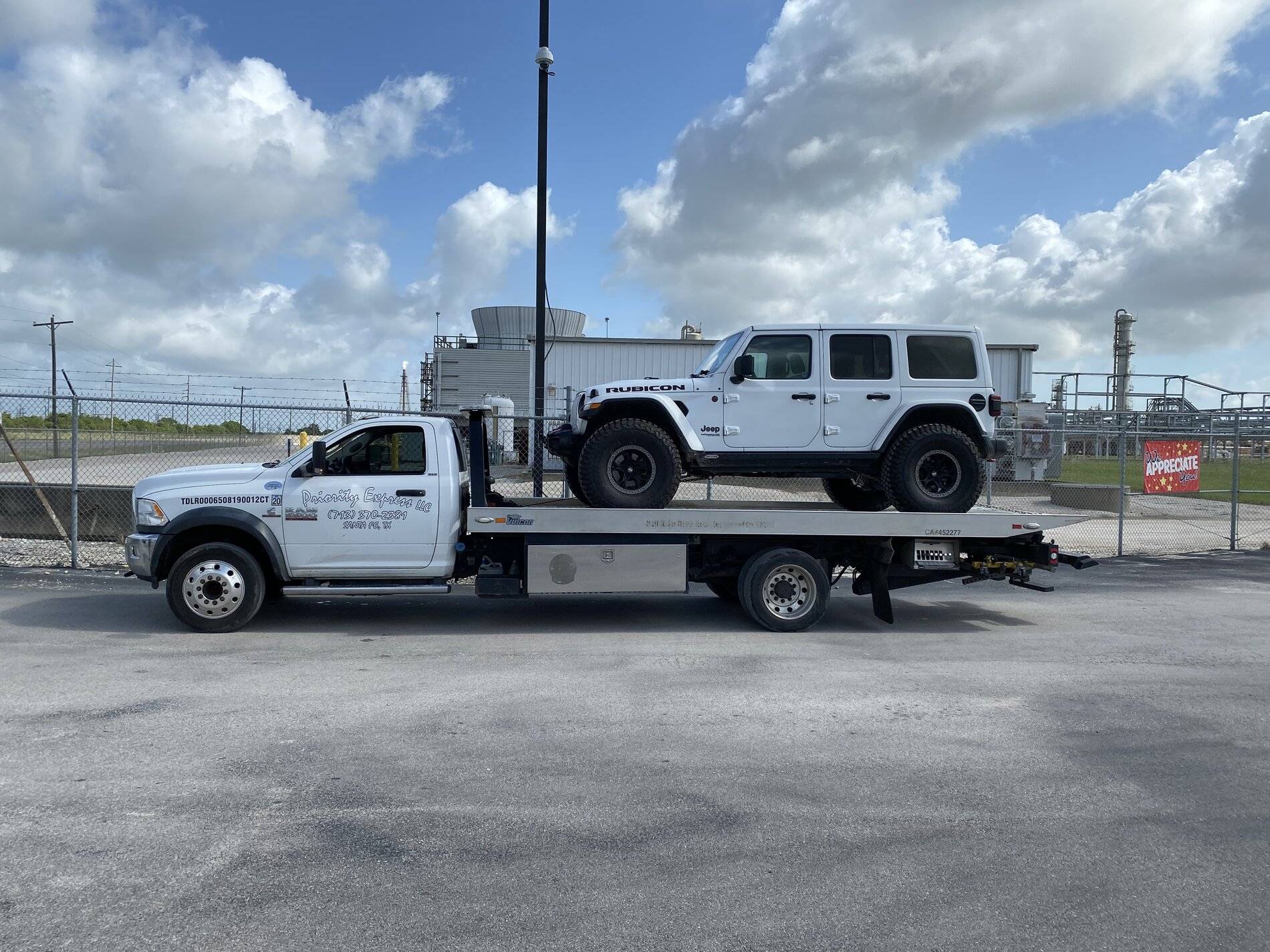

I let it restart a few times. I tried cold start and a few things. Nothing worked.
im thinking it might not be related to the tazer, and just be a coincidence that it happened while I was unmarrying it for an update. I’m reading it’s happened before due to wiring harness issues, and when I got mine, all my fuses were loose.
I’m going to let the dealership try and figure out what happened, and fix it. I’ll update when I find out what happened or when it is fixed.
