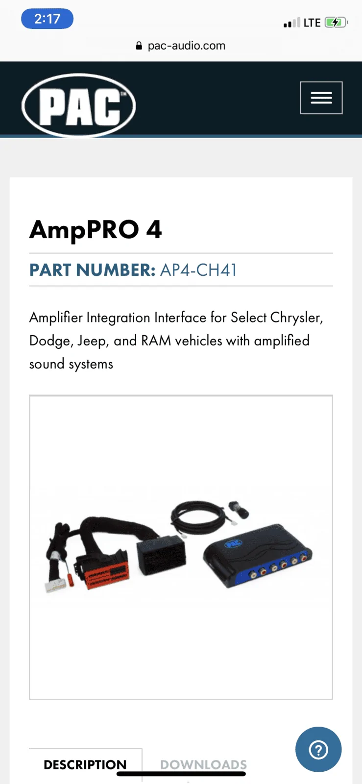

I’ve been searching all morning for information reguarding the factory Amplifier Location. I apologize if this has been answered, But I’ve been searching and can’t find the answer I need.
I have a 2018 Sahara WITHOUT the premium audio. It is equipped with the 7” Screen.
My question is, does my system have a factory amplifier/Data Canbus setup? Or does the signal come directly from the Headunit.
I plan on running a Audio Control DSP in our Jeep and wanted to utilize the Optical in, but I can find the answer I need.
I really don’t want to splice into the factory harness and add Resistors, and saw that PAC now carries this handy unit, and wanted to be assured I have an amp before I purchase, because obviously it’ll only work with and amplified setup.
https://pac-audio.com/catalog/amppro-amplifier-interfaces/ap4-ch41
