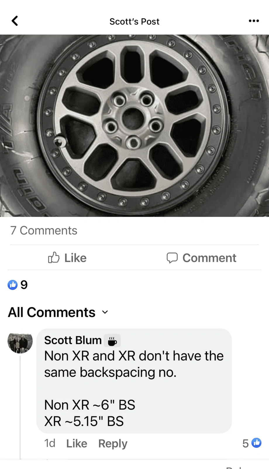

It's not the same part number as the Mopar beadlock capable wheels. Are you sure the offset is the same? https://www.jlwranglerforums.com/forum/threads/part-for-xtreme-recon-wheels.81311/4.4" BS
17 x 8
-12mm offset (if truly identical to 77072466AB)
My understanding is that it's the same wheel as 77072466AB colored slightly different. I am not sure if there's been a clear confirmation on that though.
On the positive note, you can easily now run 37's or 40's without wheel spacers.
It's a different part number because the finish is different, but my understanding is that the offset is, indeed the same. I am not 100% certain though, and we'll need someone with the vehicle to confirm measurement. That said, it would have to be close -- as 35's from the factory are wider than the 33's and we know that it sticks out further thus the flare extensions.It's not the same part number as the Mopar beadlock capable wheels. Are you sure the offset is the same? https://www.jlwranglerforums.com/forum/threads/part-for-xtreme-recon-wheels.81311/
the axles are also wider though.It's a different part number because the finish is different, but my understanding is that the offset is, indeed the same. I am not 100% certain though, and we'll need someone with the vehicle to confirm measurement. That said, it would have to be close -- as 35's from the factory are wider than the 33's and we know that it sticks out further thus the flare extensions.
392 XR axles (and have flare extensions) are not wider than the regular 392 (does not have flare extensions). Both vehicles have beadlock capable wheels. The width has shifted from 17x7.5 to 17x8 for those wheels, and at least someone measured the BS at 4.4" I am just not sure of the offset.the axles are also wider though.
Interesting, that's different than another member's measurements. But nonetheless if true, still provide enough backspacing to clear a 12.50 wide tire.XR wheels are 5.15” backspacing.
pretty reliable sourceInteresting, that's different than another member's measurements. But nonetheless if true, still provide enough backspacing to clear a 12.50 wide tire.
Cool! Either way should have no issue clearing 37’s on the wheels. The diff between the 33’s and 35’s are 0.95”. AEV uses 5.75” BS and they still clear ( not all 37’s) so this is a good sign.pretty reliable source
