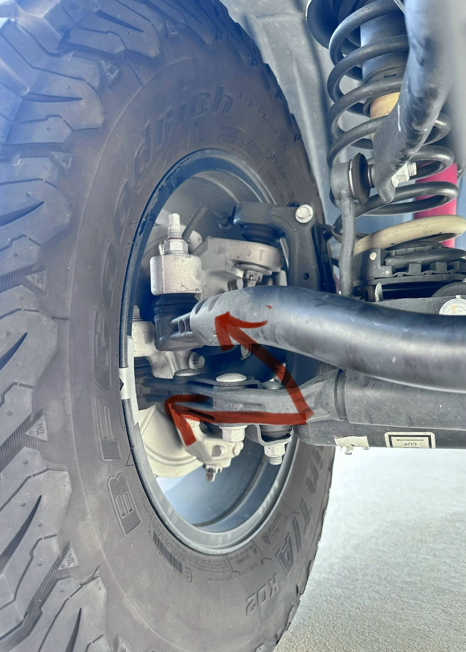

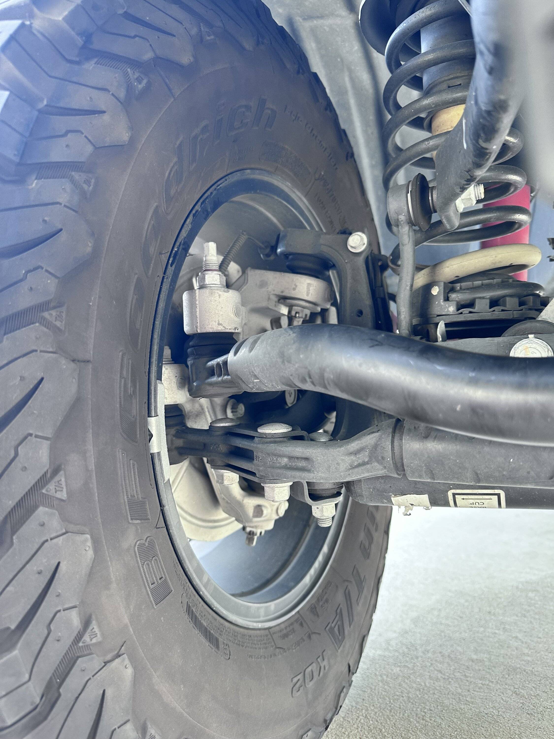

I have death wobble 2020JL with 32k miles so I know it’s probably my ball joints but this part has (top left) has play the other side has play but very little is this normal? Everything thing else is tight.
If you’re referring to the drag link or tie rod , then yes a little rotational movement is normal……

Yes tie rod thank you.

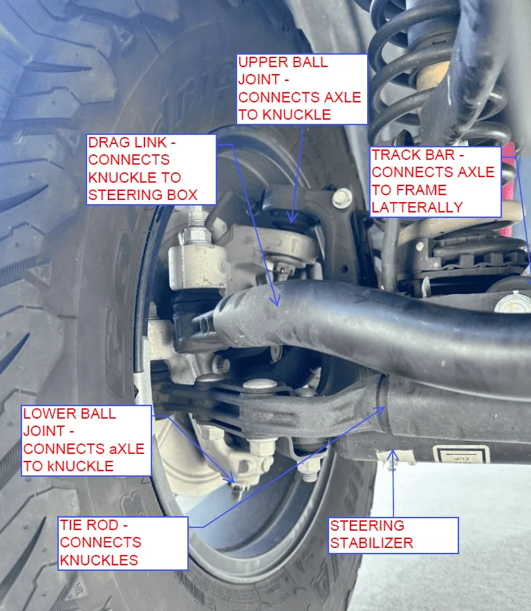

@JHTS Just a note on both the drag link and the tie rod. It’s normal to have a little forced rotational play, like if you turn the bar like a motorcycle throttle. That’s the ball joints being ball joints.
If you have lateral play, like if you jerk the bar like a shake weight, definitely could be the death wobble source.
EDIT: So I was thinking that's a shitty analogy for checking for lateral play, but the next thing I thought of was like plunging a toilet. Throwing a hotdog down a hallway? Churning butter? I give up.
I have lateral play. Where should I start? Ball joints seem to be the most common problem. Your post identifying the parts was most helpful. Nwe to solid front axles. I’m not sure I understand the interaction of the parts.
