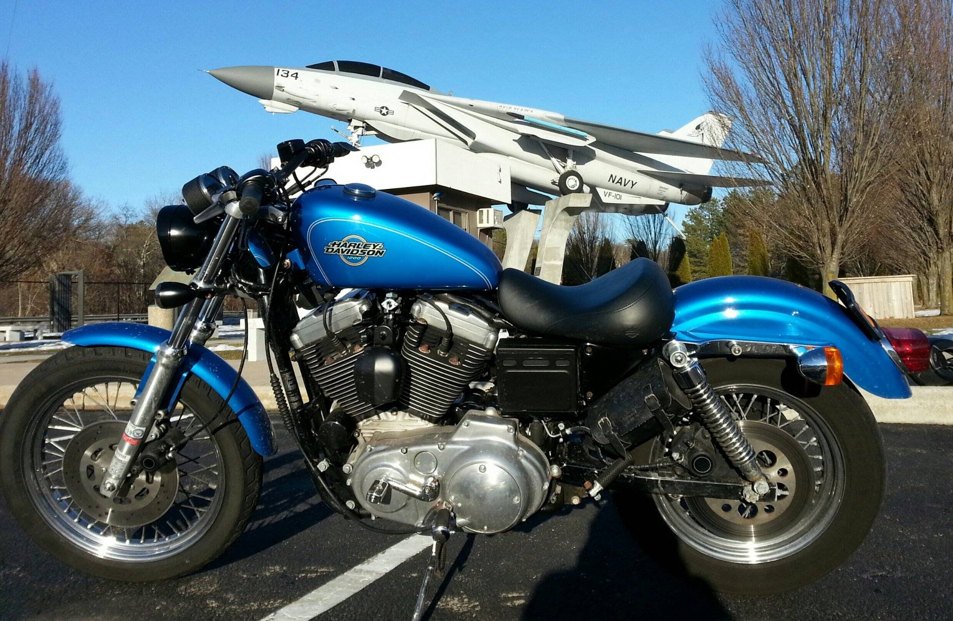

I hear ya, buddy! Due to bad head bearings, I had a nasty tank slapper at about 75mph. There was no salvaging that pair of pants. Lol!

damn. Glad youre ok. I managed to stay up somehow.

Oh yeah, I should've mentioned that it stopped after 2 or 3 seconds. I never went down, but I pulled over for a well needed cigarette right after it calmed down.
