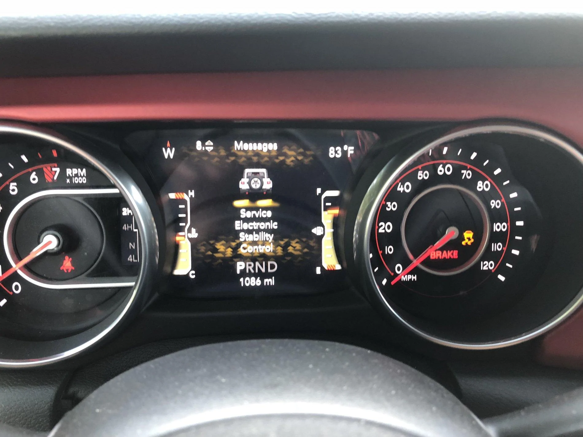

Thank you so much for your feedback. I have only driven the car locally since I got it back. The light usually goes on when I am driving longer distances which I will be doing later this week. .I will keep you posted!
Spoken too soon!! After approximately a 40 minute trip the light went on again!! Will be back at the dealership Monday!!!

@lovemyjeep ouch. Ask them to check the vacuum pump to see if it’s running hot if you’re so inclined to offer a suggestion. If it is, have them check the vacuum hose coming off the vacuum pump to see if it’s allowing it to pull vacuum. I never got the diagnosis on mine but when they hooked up to the system (engineer) with a computer, they found it wasn’t pulling enough vacuum causing the pump to run constantly and overheat. The engineer swapped the hose with another JL on the lot and it’s been fine since. He hooked mine up to that Jeep and it threw the code. My other service manager found the valve or whatever in that hose to be installed backward when he had one come in with similar symptoms. Mine kept getting C125292 last year (vacuum pump circuit control performance).

my service ESC light has been coming on the last few months. Its increased in frequency to where now its coming on every time I drive. Ive been waiting about 4 months to get it into the local dealer but they always say they have no rentals available. Why are these dealerships so hard to deal with? Never return calls or emails or texts, I have to show up in person to talk to anybody and then get fed a bunch of b.s.....I love my jeep but I hate the service experience so far....and this sounds like it may be a multiiple visit fix :headbang:

@skrubi12 thanks a lot, totally saved my day.... had ESC light on most of the time, or max. 20 minutes into a ride on my Pacifica (which uses the same parts as Jeep). Got both batteries changed, vacuum pump changed, various software updates, ESC ECU changed, till we finally focused on that hose (and valve) you mentioned... looks like it's fixed now!

So my ESC malfunction indicator light seems to come on pretty randomly. I can drive and drive with no issues. If I park and idle for a few minutes, BAM, it comes on. Turn the Jeep off, turn it back on, light is off. Anyone experience this situation of the light and message coming on, but disappearing upon next start, only to come on randomly later?
I have the same problem with our 2018 JLRU, in researching the vacuum pump operation i was able to feel that the vacuum line that Tees off the line from the vacuum pump to the intake manifold had vacuum on it when disconnect from the intake. I added a check valve to inhibit the flow of vacuum from the pump to the intake, but allow vacuum flow from the intake to the vacuum system. One test drive down and no issues. I guess i will just order a new vacuum line set and see what happens.
