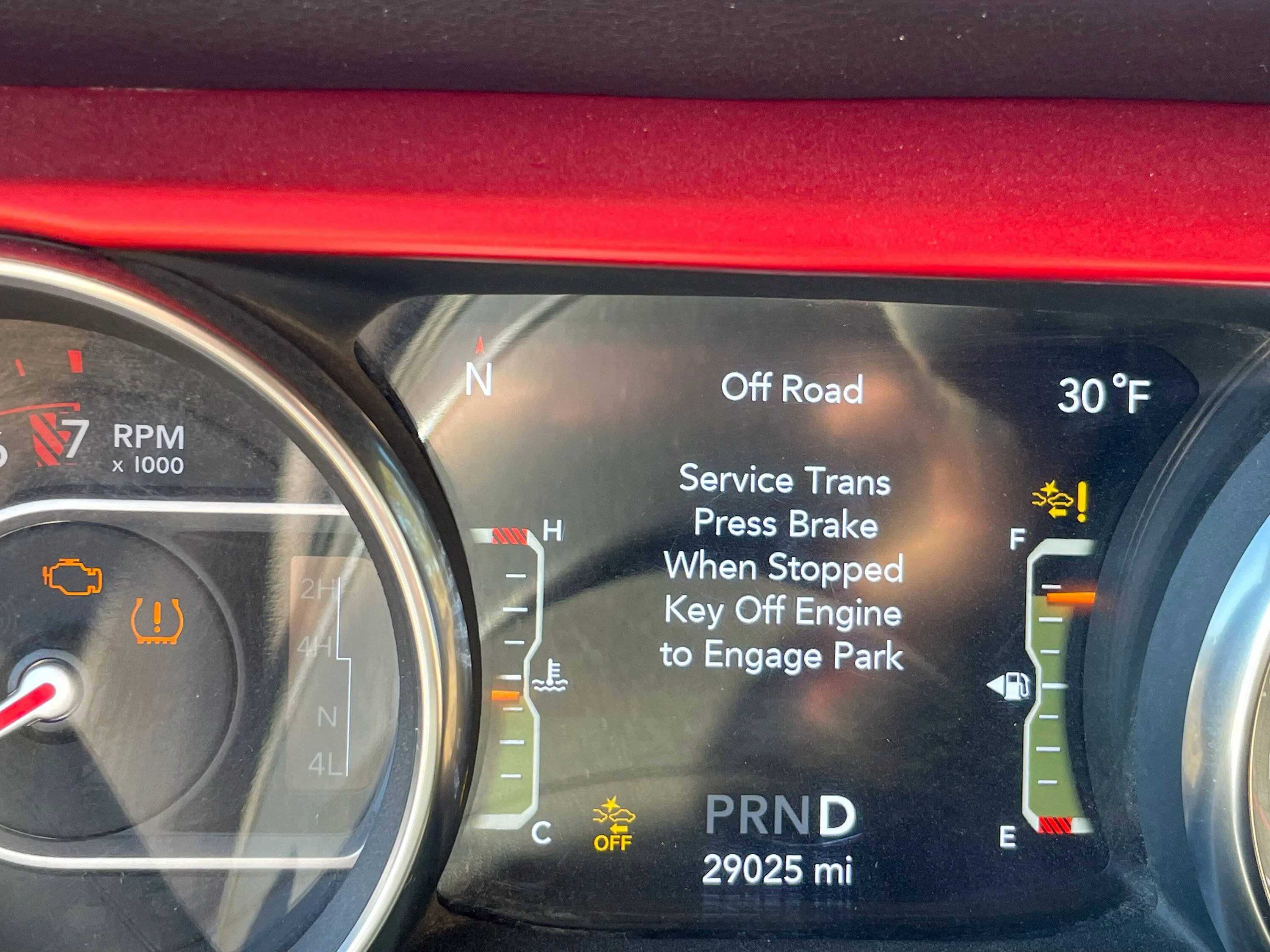

Thank you all for the comments. Same thing here -- Indicator goes out, 4WD Service light, Swaybar connects, traction control locks rear brakes. Turn vehicle off and on and Ok for short while and happens again. It doesn't think it is in 4WD.
2019 Rubicon with 28K miles. Happened on Cliffhanger in Moab after shipping it from AL cutting the trip to Moab short and only wheeling 1 1/2 days. No codes, extremely aggravating.
After 2 weeks waiting to get into the dealer back home it is being looked at now. Want it fixed once and for all at it will not show up driving in 2WD and only at the worst times.

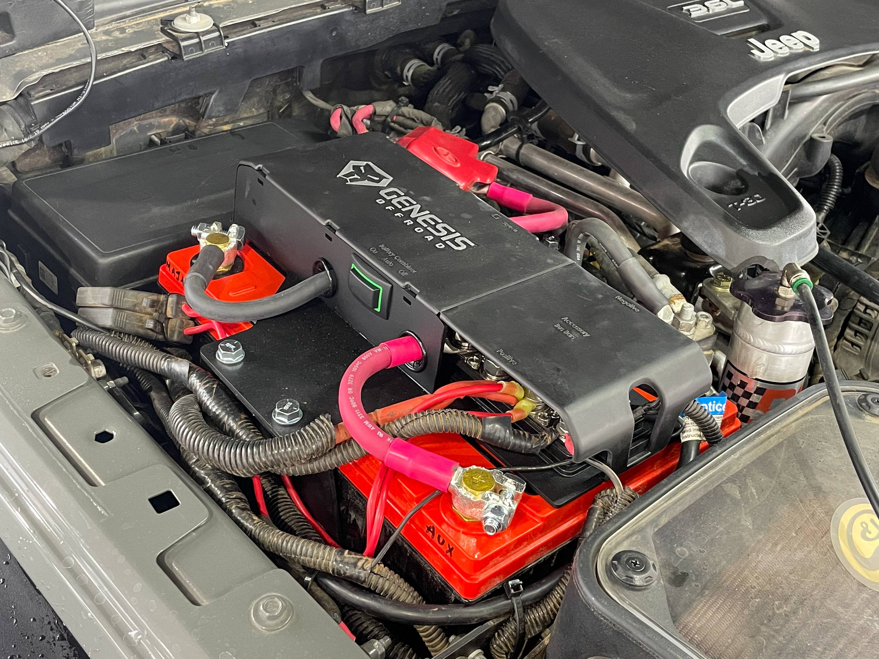

Correction / Update as of 2/9/2023
Closure -- I hope. After several weeks, emails, pictures, discussions they solve to the not knowing in 4WD was the Transfer Case Position Sensor and Drivetrain Control Module (DCM). The DCM was likely more of an insurance policy as don't want to happen again. Also found was a connector to the power steering not taped up (replaced with PSC non-electrical steering box) and wondered if water got in causing the system to trip. Very likely since can-bus is sensitive. But who knows as feel for the dealer as could not replicate the issue and had to do more of a process of elimination.
Update --
Forget what is written above, what I thought was closure wasn't.
Went to Texas and 6 hours into off-roading in 4 low in tough conditions it happened again. The $2,200 spent did nothing and looks as if they threw parts at it. I took to another dealer in TX (remember I am in AL) and they found the issue.
It was the battery. If the battery dips below a certain level the computer doesn't know what to do. My 2019 battery was going bad and by the next AM was 100% dead. During the outing it threw 38 electrical codes. This makes sense as sensitive the computer is and the load is higher in 4WD as so many systems at work. Could also see it in cold weather (I was at the Pola Bear Run in Jan) as a drain on the battery. So to ensure would not happen again I had them put in a Genesis Dual Battery kit.
So I know others will have this issue if they use their Jeep in 4WD Low -- this thread is evidence. Do not let them throw parts at it as feel so taken advantage of costing so much money. The dealer will not be able to replicate so educate them.
That's my story. Hope it helps others who experience the same issue.
