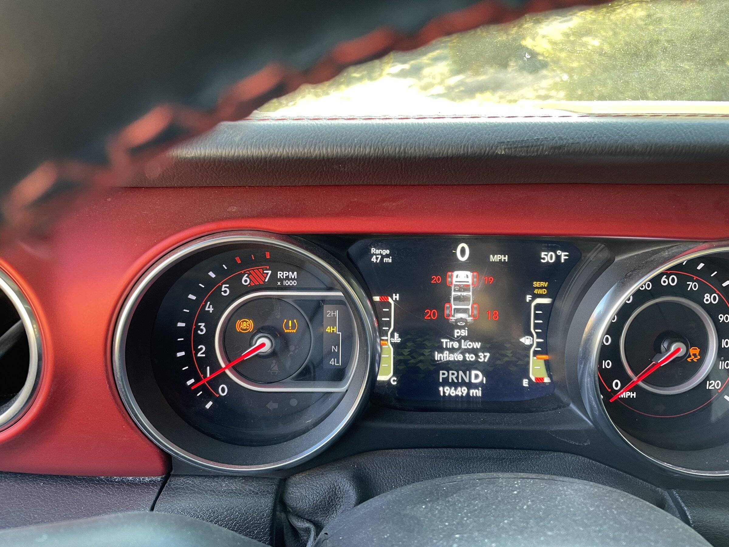

In the image I am in 4-lo. The service 4wd and the left indicator doesn't show that I am in 4-lo. I will check my fuses for sure, but if anyone is having this issue I would like to understand when it happens and if you have a fix,

Hi - did you ever get a fix for this issue? I too have the Serv 4wd light come on (also with the ABS and ECS lights). It seems to happen sporadically, typically while wheeling and not on road. Most of the time I can just switch off the ignition and restart, warning lights go out. Taken back to dealer once who tightened battery terminals and uploaded an ABS module update - took out off road and same issue, starts with ECS warning then ABS and then Serv4wd.

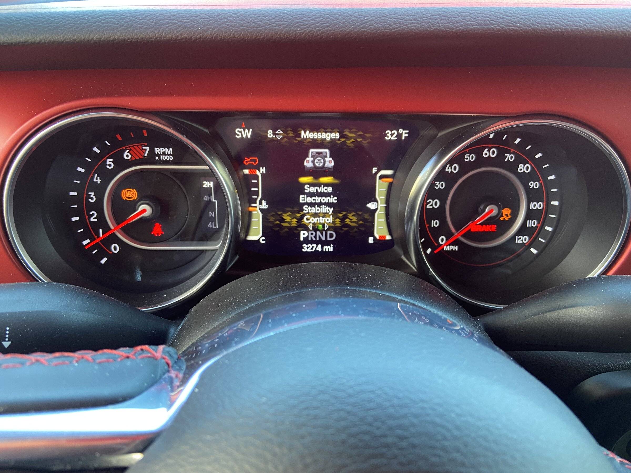

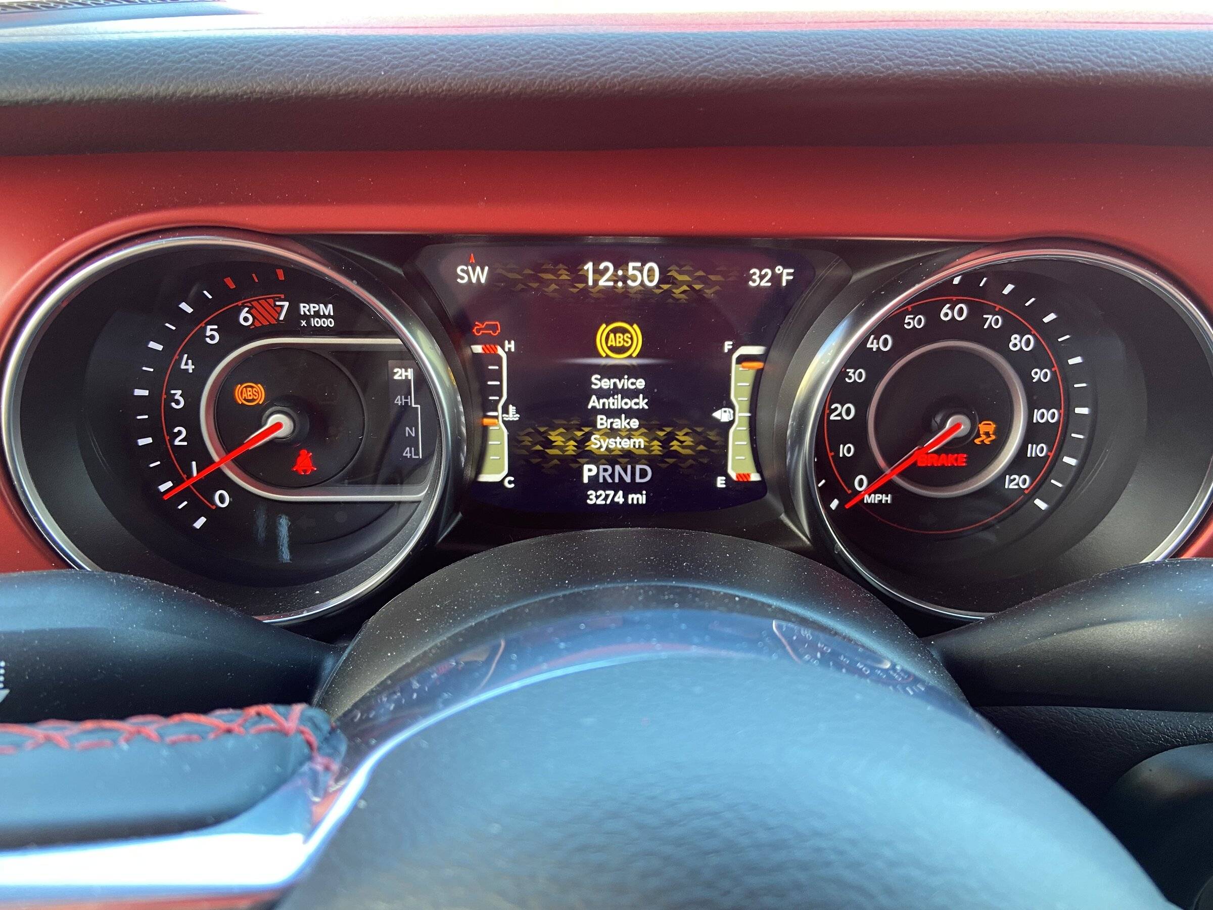

Well… after popping my “Off Road” Cherry this morning in my ‘22 JLUR, I get the dreaded ABS Light and “Serv 4WD” indicator on the Cluster 40 miles afterwards.
Jeep Wrangler JL "Service 4wd system" indicator light 417539B4-6C81-4B3D-9A8A-C1DCD820BBE8
Jeep Wrangler JL "Service 4wd system" indicator light C8558A7D-E14C-4F0E-9303-425FA7C50274
My assumption would be a loose ABS Speed Sensor Wire, as stated by many. But I guess it’s a Trip to the Dealer very soon… ?

Can we place bets on what’s wrong? I’ll guess front wheel speed sensor reading implausible.

Yup, that's exactly what it was. The ABS came on upon arriving to the Ballet Studio for Class. Once I left for Class, everything all went away. Two days, and nothing has come back again (knock on wood).
Yes, it dawned on me at how extremely sensitive these ABS Sensors are. Ironic for something that's designed for off road capabilities.
