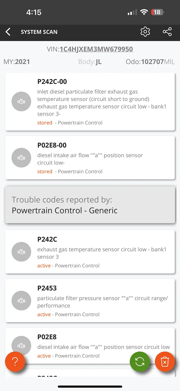

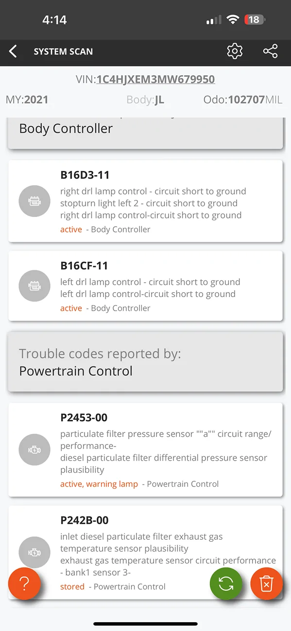

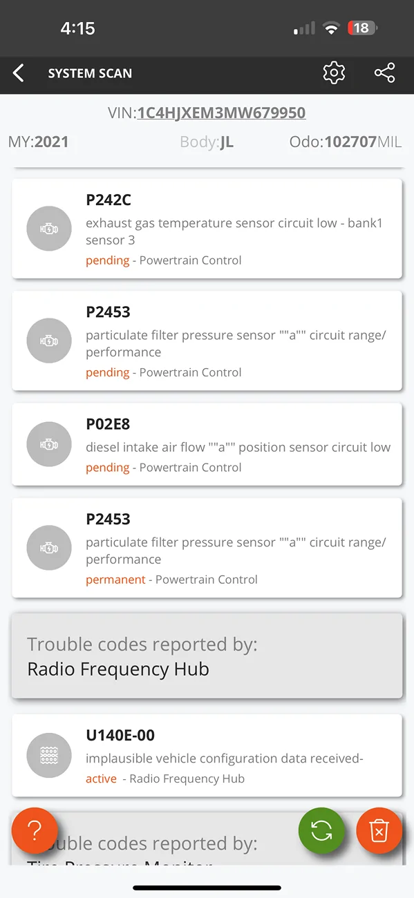

Not sure if I am in the right place for this so, please move if needed. We have a 2021 Sarah with the ecodiesel and we are running into issues with it cranking and stalling when stopped. At time when we go to crank and hit the push start it will not start the first time doesn't even turn over. once we try a second time it will crank like normal. The jeep also cuts off randomly when coming to a stop, the auto start-stop is turned over. along with all this we are throwing a check engine light. I have scanned the vehicle and received the following codes P2453-00, P242B-00, P02E8-00, P242C. I'm torn between DPF issues or electrical issues.
