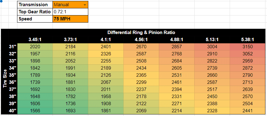

4LO.com has a calculator where you can play around with gear ratios vs. engine RPM at certain speeds. Here some of my comments.
Believe the 6 speed manual 6th gear ratio is 0.72:1 and using a stock Rubicon size tire of around 33" and running 75 mph. (Please keep in mind that the "true" tire sizes can fluctuate a little and cause small differences in RPM, but this gives you the idea the difference.
4.10 = 2,250
4.56 = 2,500
4.88 = 2,680
5.13 = 2,820
Not completely sure on the options available, but did quick look at the Jeep website. Looks like both the Willy's and Rubicon come standard with 4.10. 4.88 is an option for Rubicons you can pick by itself. For the Willy's, it shows 4.56 as an option but it forces to add the XR package if you select it.
With that said, I don't think 4.88's would be too bad with the stock size tires.

Having owned 2 JLURs and a JT I'll give my 2 cents. Granted these were all autos. If you're only going to 35s I'd stick with 4.56s. If you are going to 37s 4.88s would be better. Both will be geared lower than I'd like running stock 33s. Not terrible, I drive quite a bit faster than 75mph regularly. I believe you can order a Rubicon with 4.88s so that's the route I'd go with a manual.

I ran 5.13’s with 35’s for nearly a year and it was awesome, almost go-kart like. Now with 37’s I still have no complaints.
Fuel economy took about a 5% hit with the new gears then another 5% with the 37’s.
I do usually limit my speed to about 70-75 MPH.
4.10 = 2,250
4.56 = 2,500
4.88 = 2,680
5.13 = 2,820
