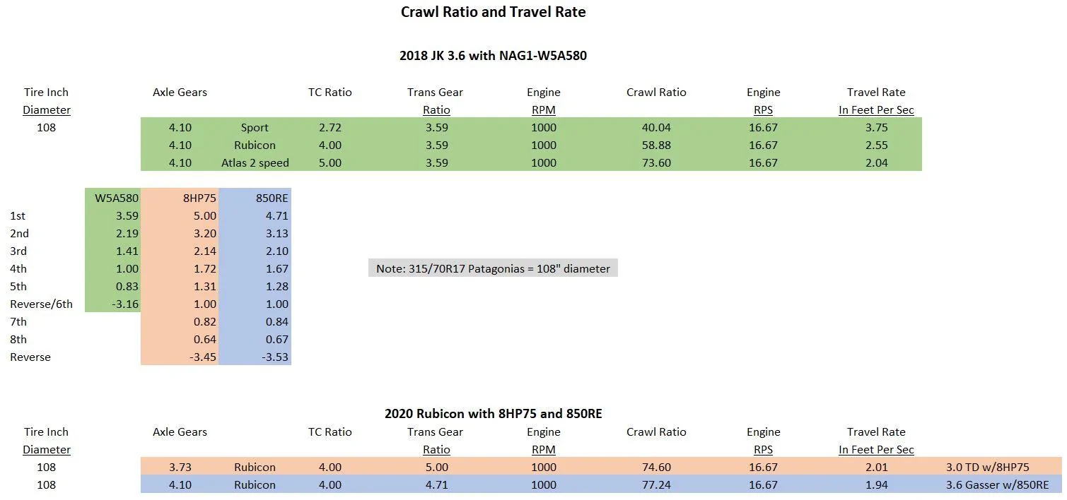

Holy mackerels! The crawl ratios of the 8-speed transmissions are near to a porcupine walk. Better than the old NAG1 used in the JK's.

...and that's on 35's.
On 33's it's even better.(less clearance but better ratios)
Which is why people re-gear a lot with larger tires like 37" or bigger.
Engine is the other half of the equation, but let's keep it simple.

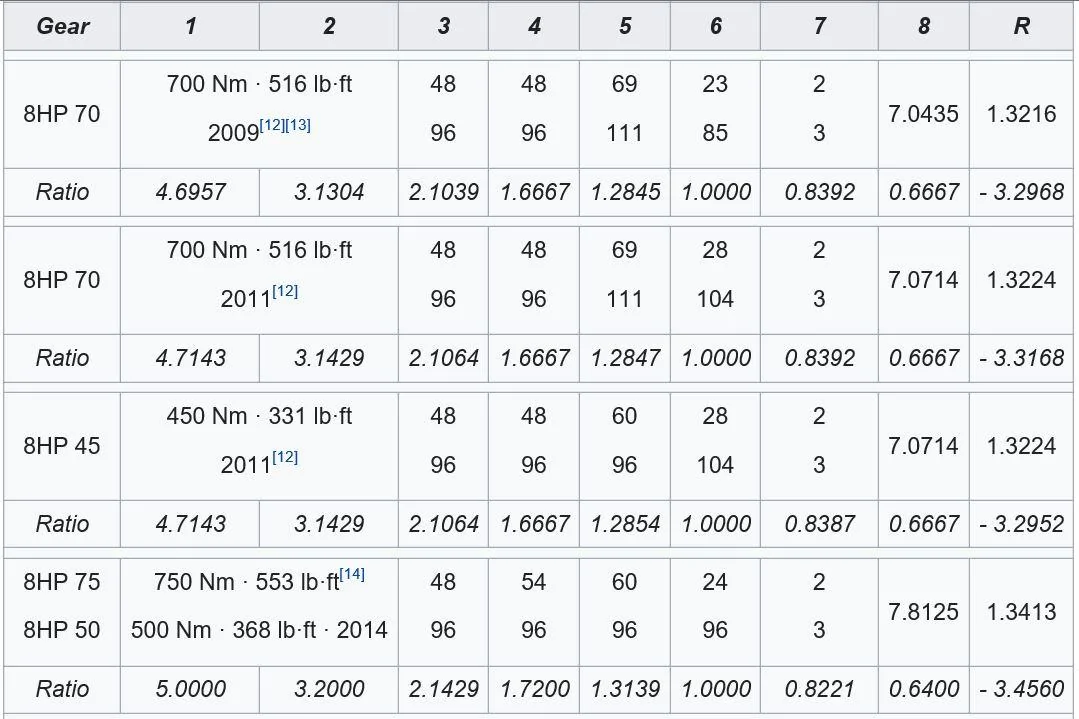

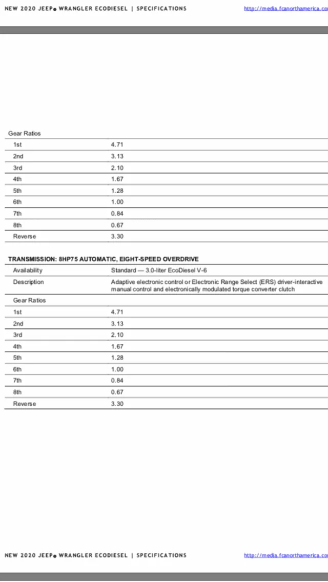

Yep, the 4.71:1 first gear is also steeper than JK’s manual trans too!
That chart has the wrong gear ratios listed for 8HP75, they are the same as 850RE

Don't forget---the CRAWL RATIO is a MECHANICAL DRIVETRAIN FIGURE--
Has nothing to do with TIRE SIZE !
W.E.
JIMBO
It's a linear relationship.
...I understand your point.
W.E.
JIMBO
I agree with your statements. However, including tire size when calculating the crawl rate (= distance in time) is imperative. Four feet per second has its place as well as one foot per second, different terrains for sure.
The new version of automatic transmissions has given consumers increased crawling control, quicker acceleration and a little bit at the long end in the 8th gear. Having experienced the days of old, I am glad to see these improvements and welcome them to my rig.
Oh YEAH, I agree, but the phrase "CRAWL RATIO" is used for ENGENEERING to design/compare tranny 1st gear/difff. gearing/xfer case gears, for construction/article--
Of course the TIRE SIZE will finalize the RATIO-INDIVIDUALLY !

@SecondTJ Thanks for taking the time to post the website of your reference. Unfortunately the article is 5+ years old. Why in the bee geezuz won't they disclose that information more readily. In any event, the information presently out there is close enough to aid in planning gears and such.
