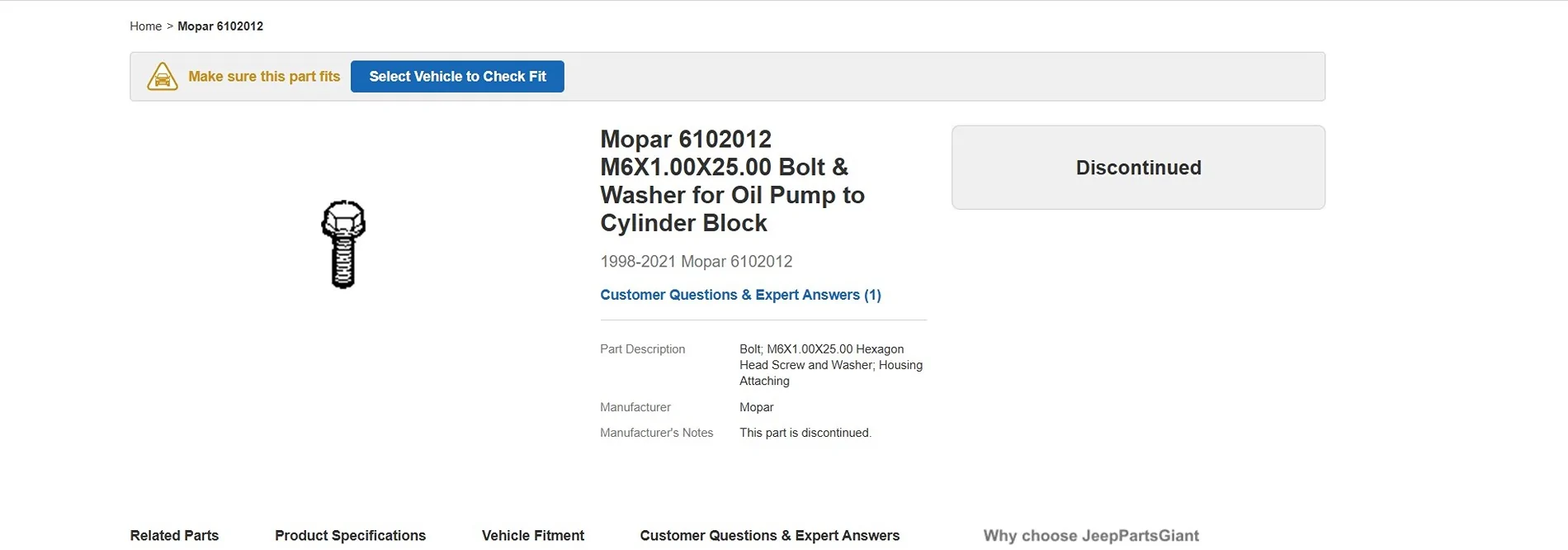

Seems I’ve misplaced the oil pump mounting bolts, can’t seem to find a part number anywhere. Or I head to pick apart
Anyone know?
It's listed as a M6x1.0 x 25mm long. It's very likely an 8.8 or 10.8 grade flanged bolt. It's shown as discontinued per my sources.

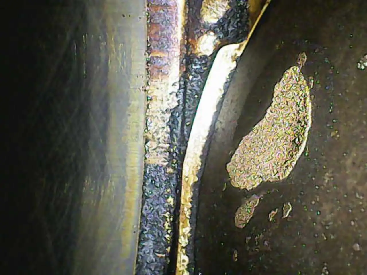

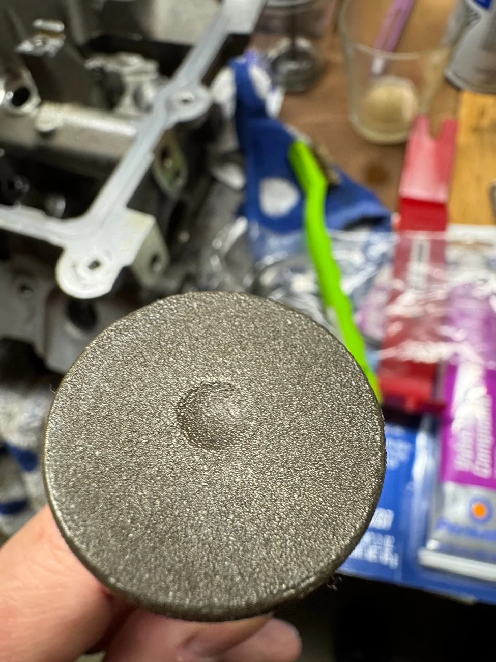

Are the Mopar exhaust valves coated or it out carbon, shouldn’t it look like regular steel like the intakes?
this is an intake that has a sea barnacle growing on it lol, what the heck is it? I’m going to buy new exhaust valves rather deal with it
Looks like some kind of combustion deposits

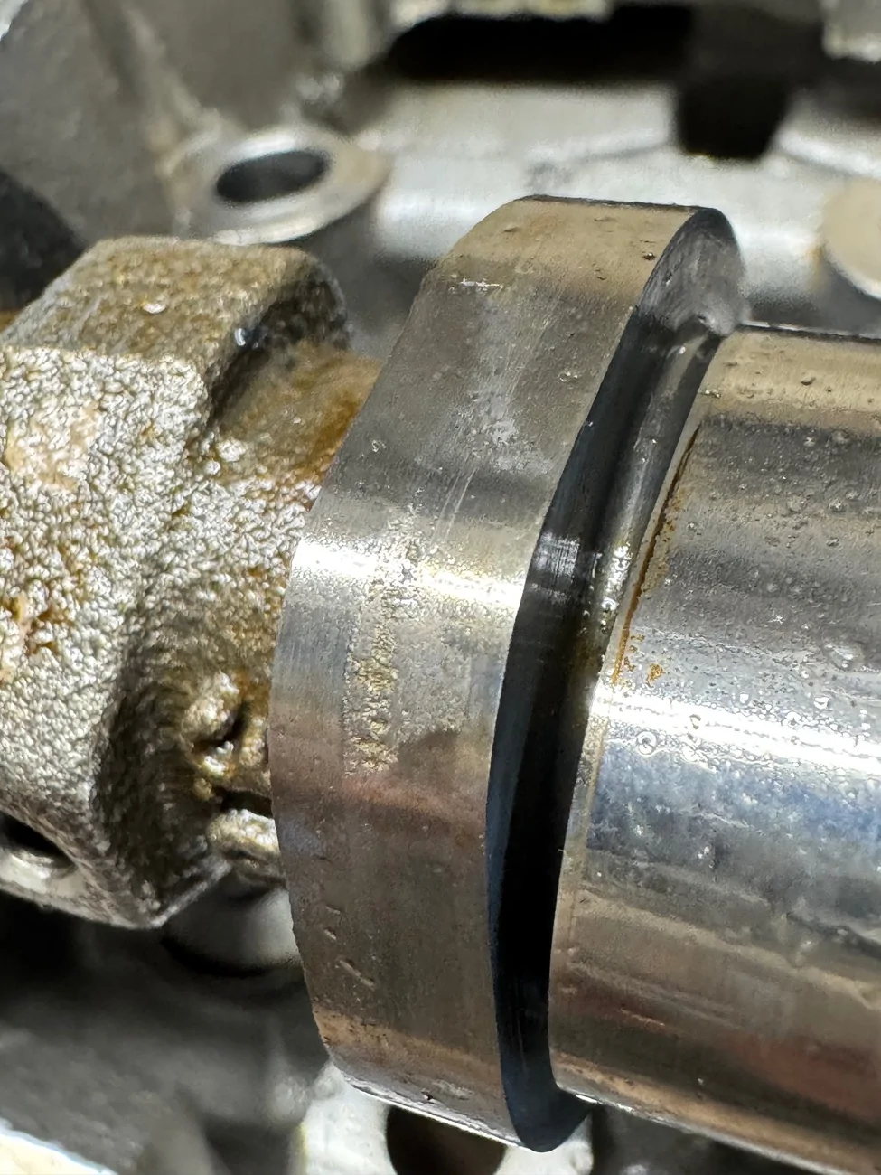

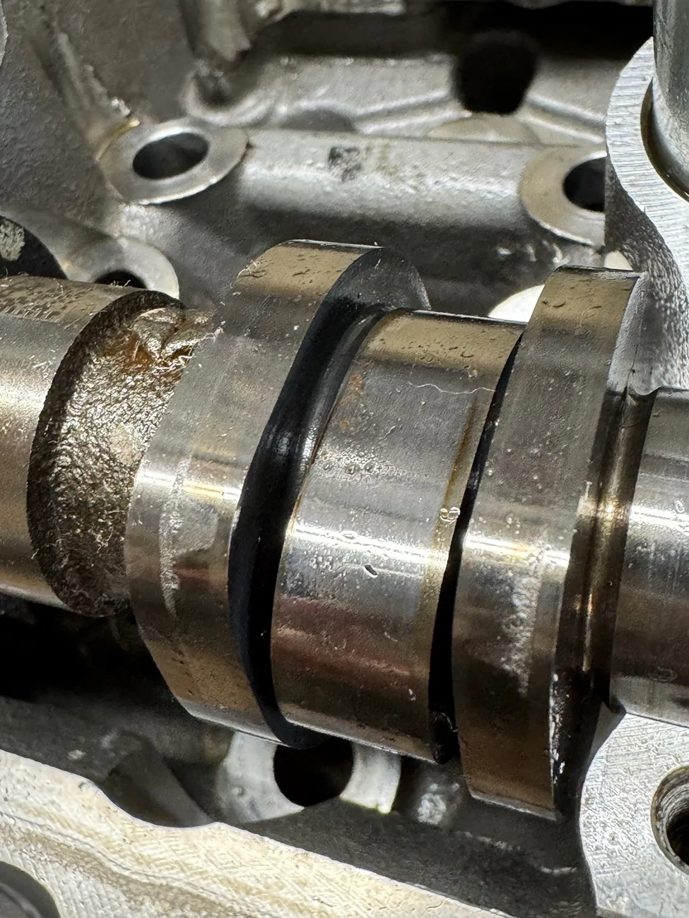

The left intake cam is missing material on the lobes for the rollers not valve lobes, I assume it and the new style vvl rocker arms will need replaced?
Jeep Wrangler JL Engine Noise - afraid to ask IMG_3793
Jeep Wrangler JL Engine Noise - afraid to ask IMG_3791
