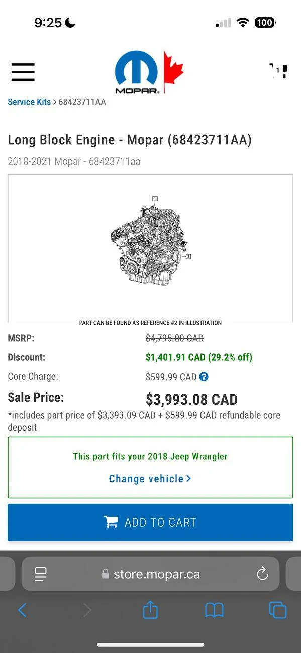

If you buy a new long block they’ll generally have a significant core charge.

Looks to be ~600$ CAD 420$ USD, have to do more research of course. Not sure this is the correct engine but should be similar
Hey that’s not bad if it’s the correct/current part number. GM cores are crazy. $2000 for a transmission started a few years ago.
