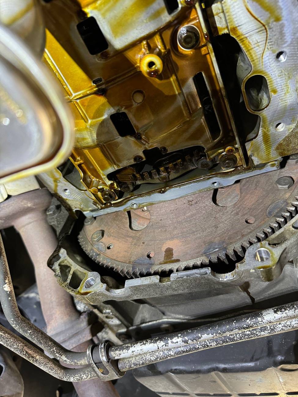

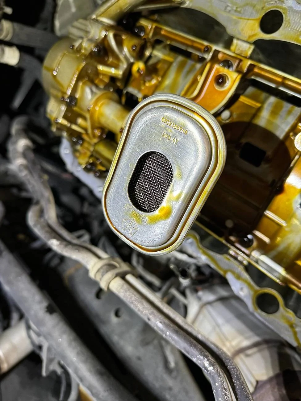

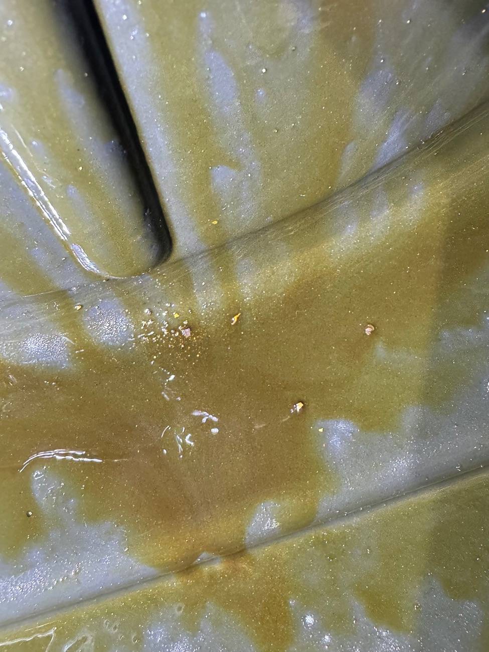

A few fine flecks in the pan, oil pump sump screen is clear. More varnish that I thought. Holy dip stick, yesh.
Any suggestions from here? Thinking oil pump chain or cam chains / tensioners.
was wondering if I’d find an oil galley bolt down there….

It would be a good idea to Inspect the flywheel while you have access. Turn the engine over 1/2 turn.

Dang. Those are large pieces, looks like bearing material.

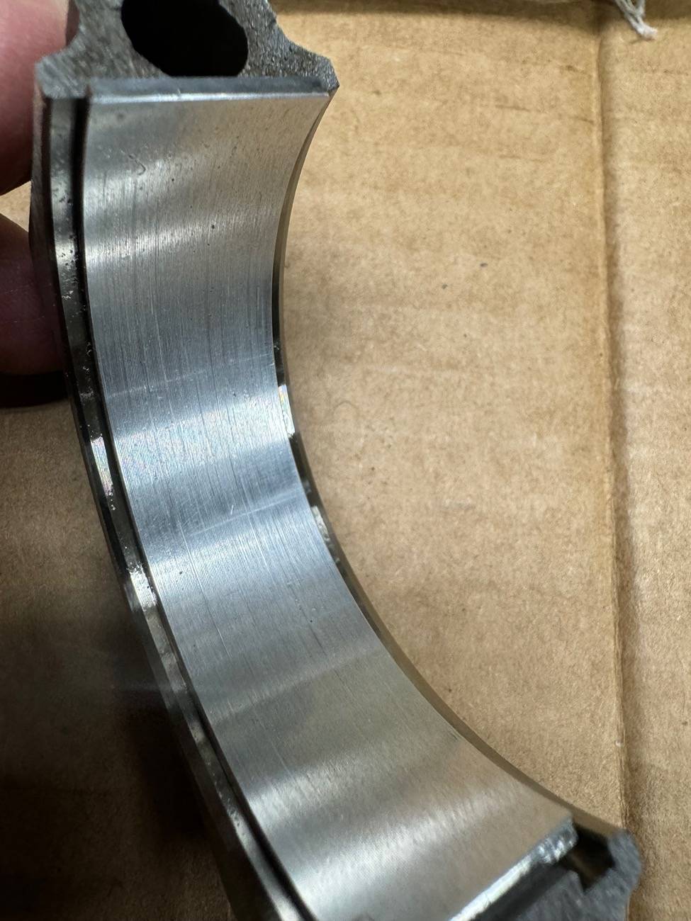

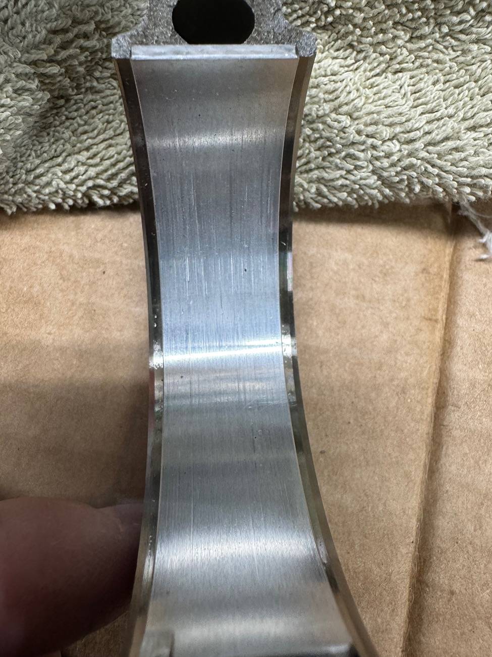

Pulled the rod bearing lowers tonite, some wear but certainly not catastrophic. The rods look fine, nothing out of place.
Thinking I’ll pull the head covers check the cams. If nothing there do I consider pulling the crank mains…. Not feeling good about that one.

I dunno, that looks like a lot of scratch marks to me. But, I'm not a professional mechanic. My guess would be cam/lifter being the culprit, as others have guessed.

Our rule with bearings is that if the lead of a mechanical pencil can be caught by it, then it's scratched and should be replaced. Used to be fingernail, but we went finer for the tighter tolerances.

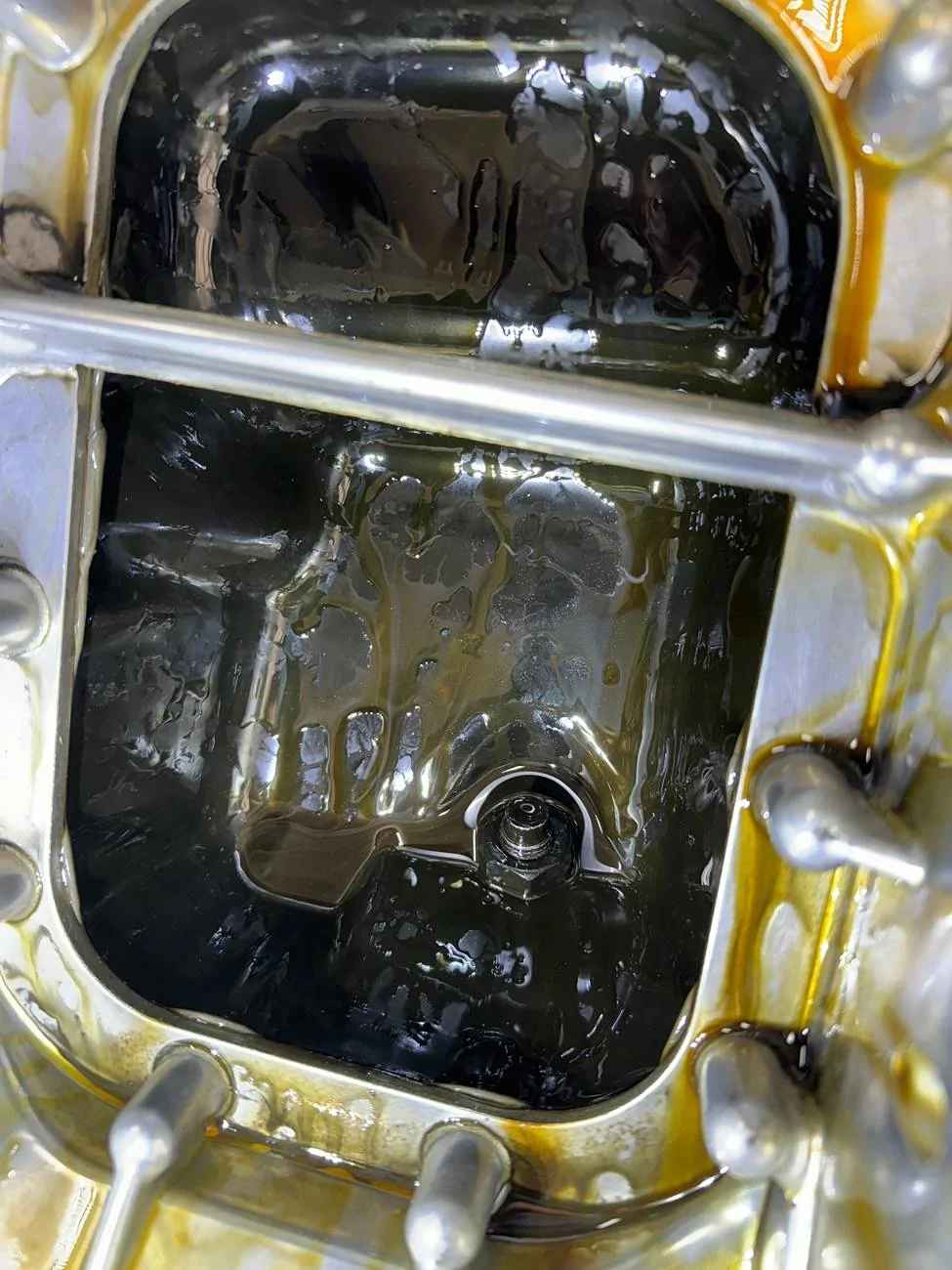

Noticed metal when cleaning out the oil this am, looks like a lot to me, but frankly it’s the 1st oil pan I’ve removed? will pull the oil pump and windage tray and do some borescoping.
That's a lot of glitter. You are going to need to do a thorough teardown and inspection. It's hard to tell from the picture what kind of metal that is. If you can, I'd send a sample to the lab, at very least check if it's magnetic. Does the oil feel thin between your fingers? You can do the old paper test for possible fuel dilution. take a piece of sheet paper and lay the edge on a drop of oil vertically. If there is fuel in the oil it will wick up the paper.

One piece was magnetic, the others probably aluminum. Fuel dilution - thinking there’s an injector stuck open?
Hard to say at this point. Just checking for potential signs of loss of lubricity to account for the damage shown.
