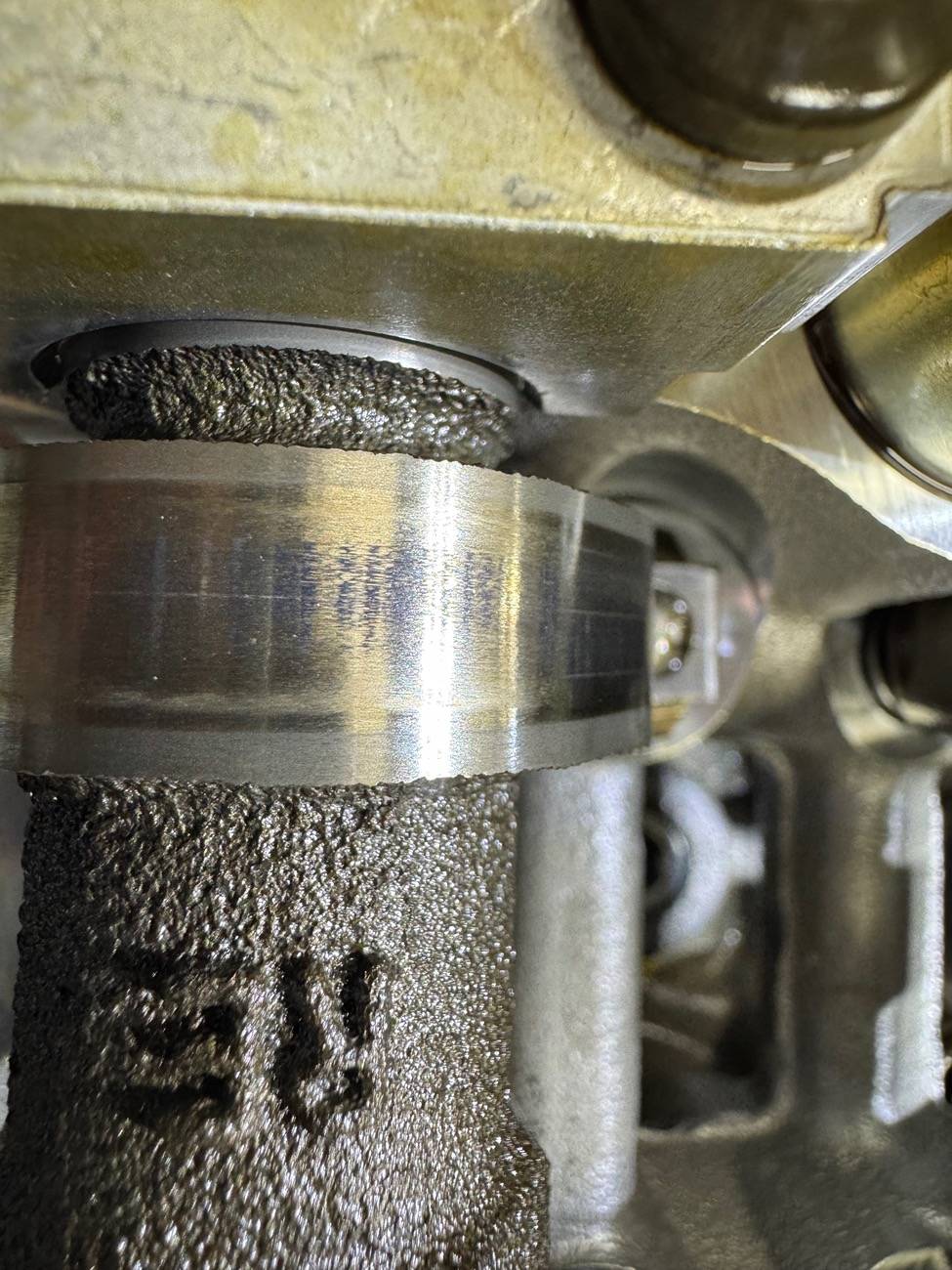

Do you have any leaks between the air filter and the throttle body? Do you drive a lot of miles on dusty or sandy dirt roads? Those bearings are finely scoured.

Finger nail doesn’t catch, will try the pencil method maybe this weekend. If I were to swap do I :
- measure the crank, or swap in stock?
- Is there a bearing you recommend besides Mopar?
- how would I ensure the crank and oil passages are clear of debris?
Maybe there’s an existing thread
I'm not even aware of anyone besides Mopar offering bearings for our engines. There was a company that offered them for the JK era of Pentastar, but supposedly the bearings from then to now have been upgraded with some coatings or such. If the journals on the crank look good, and don't have scratches deep enough to catch, I would put some new bearings in. My concern is that you have some decently large metal particles in your pan, but still haven't been able to find a component that identifies as the root cause for that damage and where it came from. That's why I recommended going through the engine. The funny noise, and glitter in the pan are telling you that something failed.

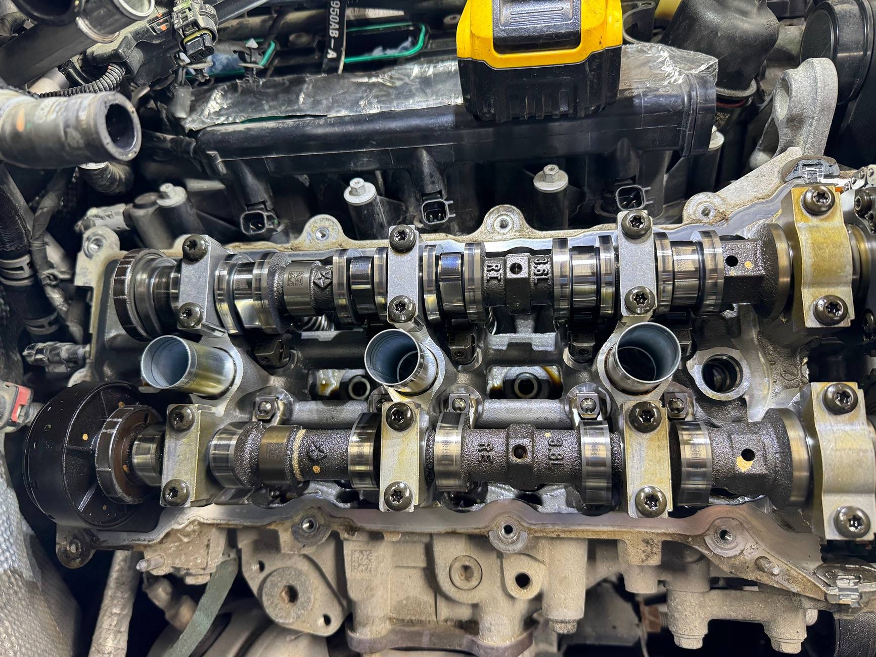

Nothing obvious on Bank 1 cams looks like min wear, some chatter. Not seeing any metal. Bank 2 next
The camshafts have a magnetic reluctor wheel. Yours have some metallic buildup. Clean them.

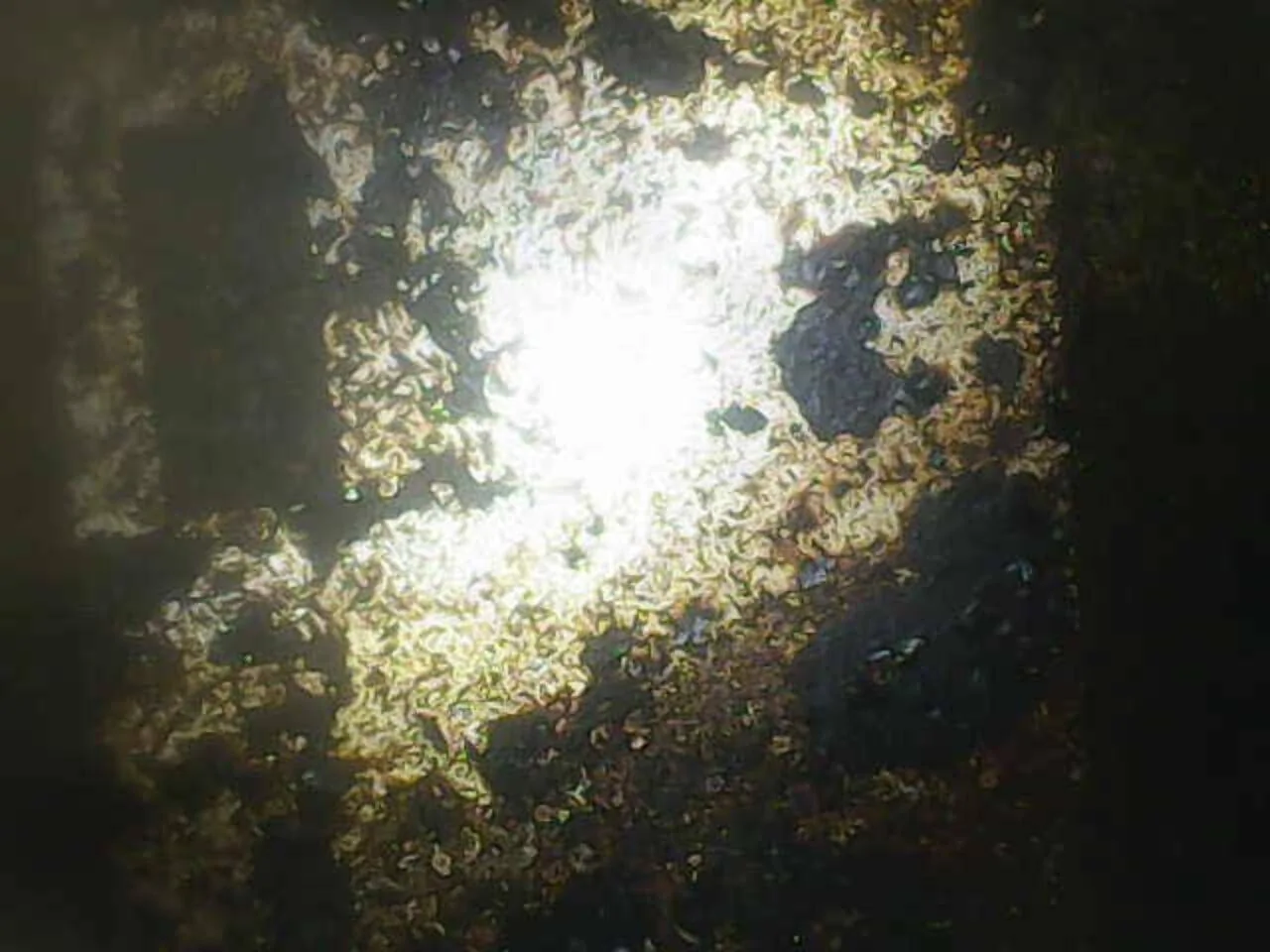

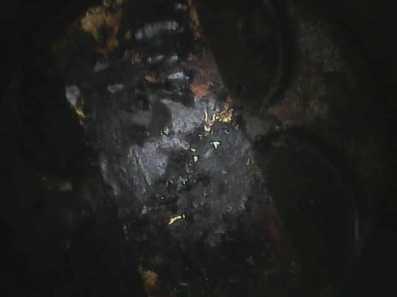

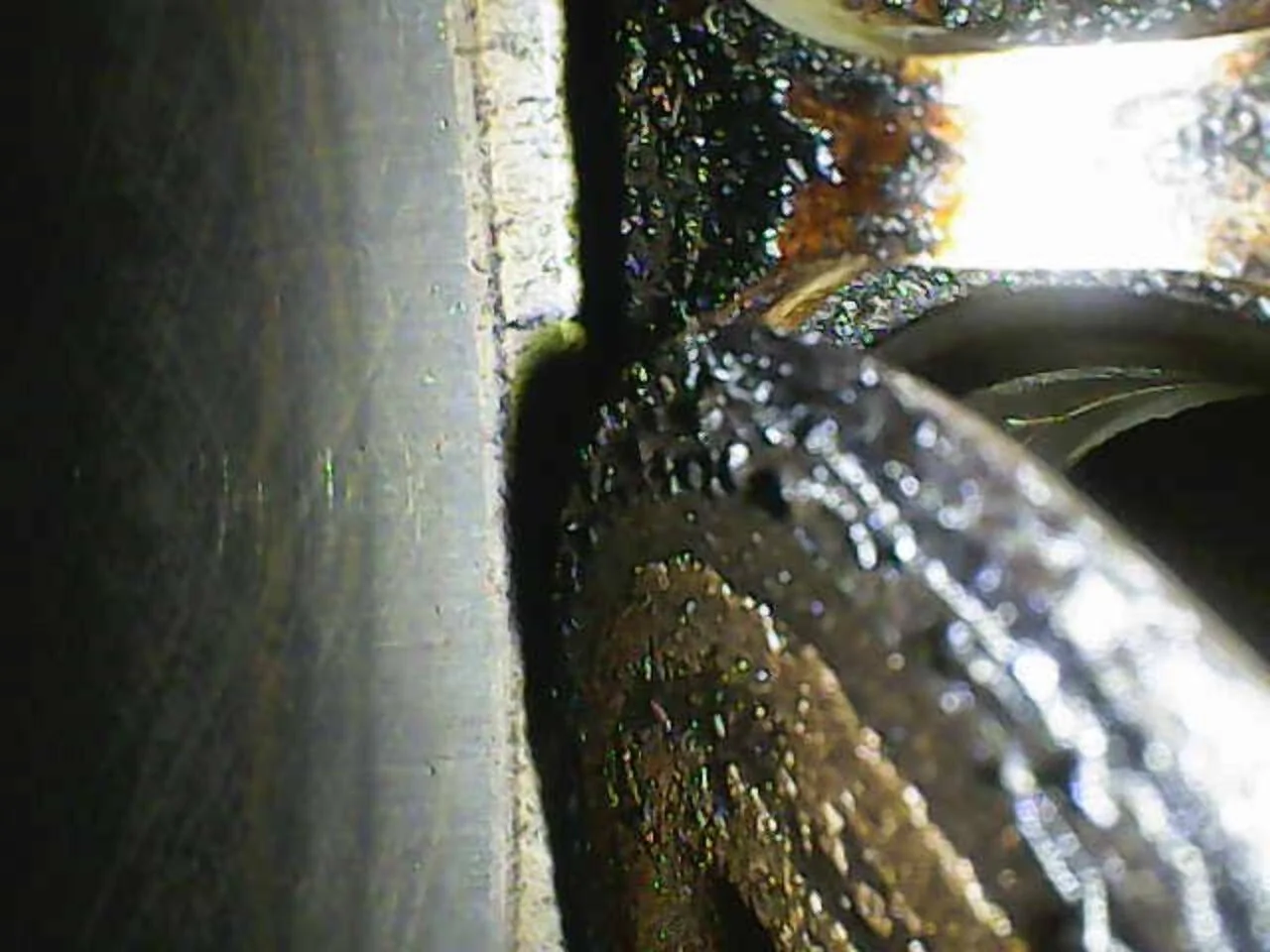

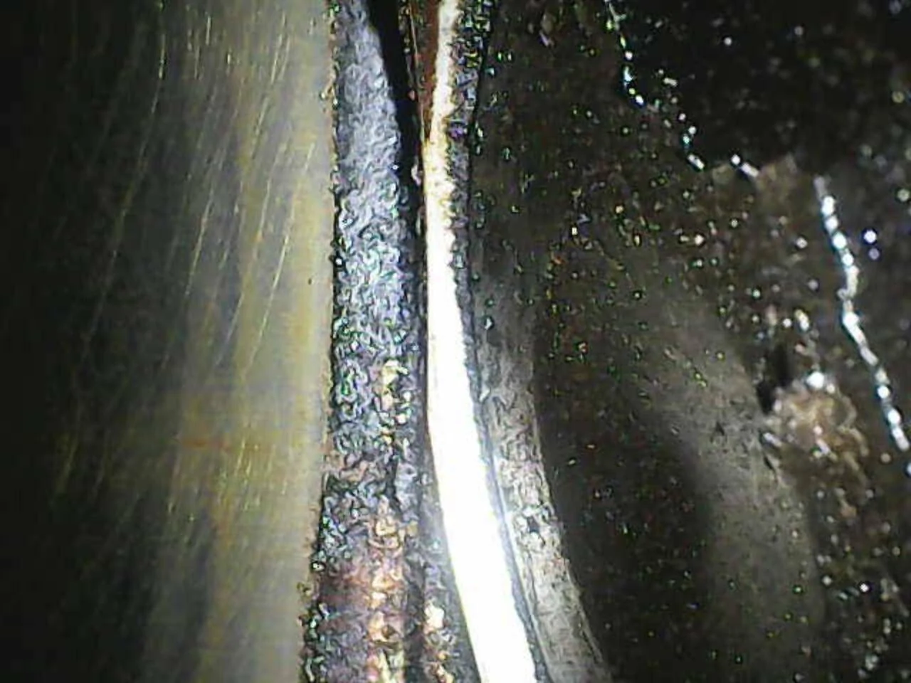

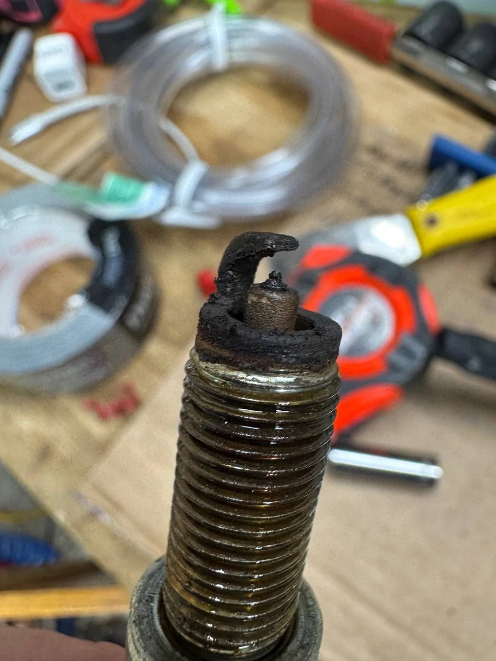

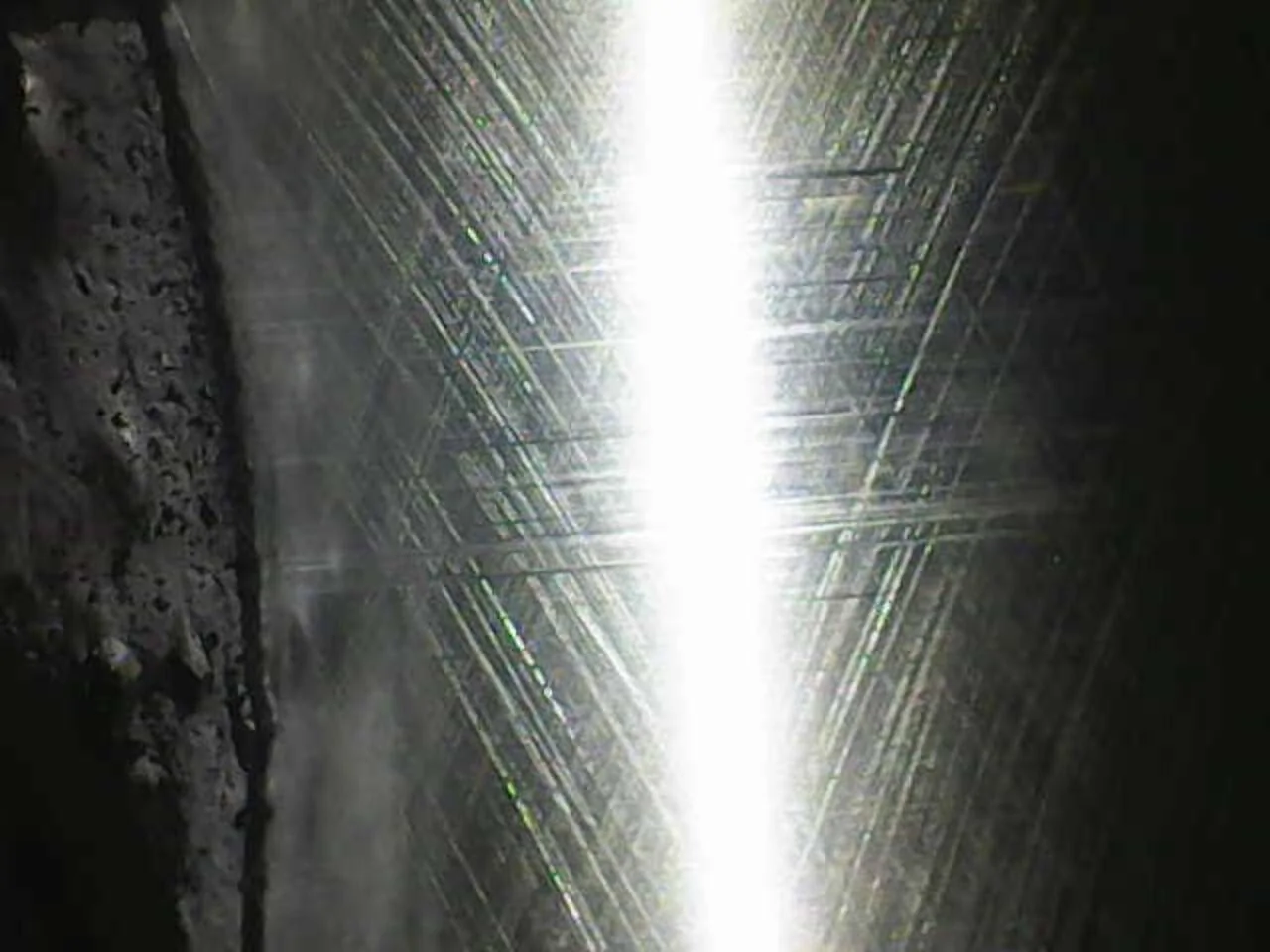

Cylinders 1 3 5 Lots of fouling, some bore wear, no metal or holes in pistons

Cylinders 1 3 6 Lots of fouling, some bore wear, no metal or holes in positions.

That bore scuffing would be a concern to me. I'd probably drop the pan and look for ring/piston debris in the oil pump pickup and pan. Quite a bit of oil is coming up the bore.

cyl 2, 4 maybe less bore wear. 6 is oddly cleaner, head gasket?
Leaning toward pulling it, strip down, cleaned, hone bores, new bearings wrist pins rings, have heads checked & whatever else makes sense.
