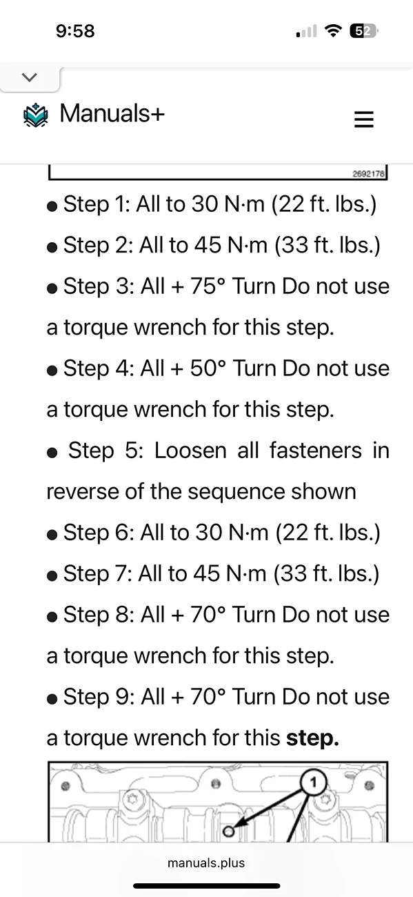

Sorry to ask the same question here, started a thread about head torq, a gentleman said 25, 40, 41 +180 deg, has it
changed from 22, 33 + 140 deg? Didn’t want to second guess him
If you wait an hour or two, i will get back from dinner and check my factory Mopar service manual and post it.

That’s great I didn’t know pm was an option lol, do you have an online subscription?
Also,
I have a full manual from 2018 when you could buy it outright.
