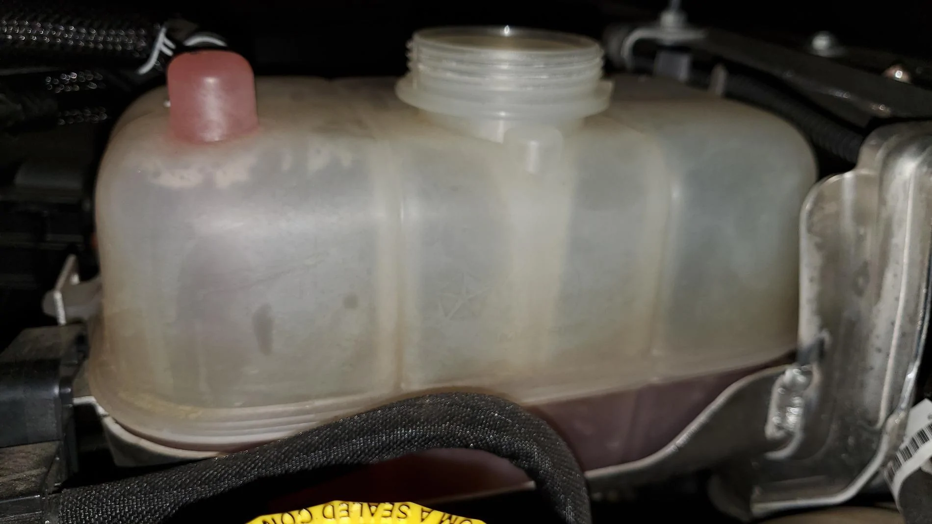

Thanks! Thinking of adding more to get it between Min and Max. Could anyone confirm that this is the appropriate coolant to use?

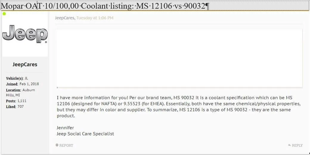

*Note* The manual states (page 443):
We recommend using Mopar Antifreeze/Coolant 10
Year/150,000 Mile (240,000 km) Formula OAT (Organic
Additive Technology) that meets the requirements of
FCA Material Standard MS.90032.
The linked coolant above shows MS.12106. Anyone know the difference?
Jennifer from JeepCares was able to provide the information from her brand team and with her permission I'm posting it.

About 2 months ago, my coolant was a little below the min and a mechanic friend recommended I add a little water...so I added 2 cups of tap water. Its at the level in the pic when cold...should I add another cup of mopar antifreeze to blend with the water? Does the water make it less lubricating? Thoughts?
NEVER NEVER NEVER add tap water. Use distilled

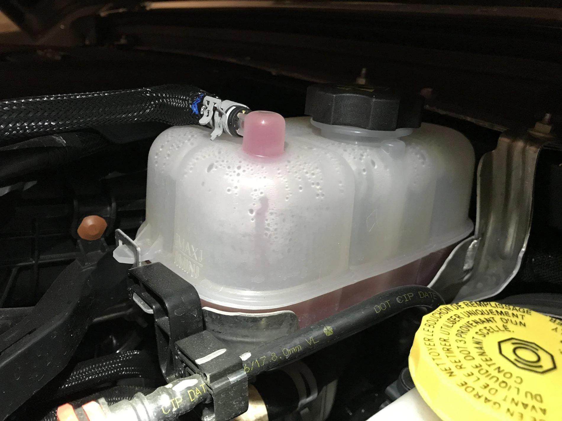

Checked the coolant level tonight (I'm going to be honest and say that I haven't looked under the hood yet since picking her up in February :facepalm:). Looking at the coolant reservoir, I was a bit confused by the MAX/MIN markings. If you look at the pic, there are down arrows next to MAX and MIN with a line right in between. Question is, where exactly is minimum and maximum? I'm pretty sure my coolant level is on the low side but wanted to make sure I'm interpreting the markings properly.
