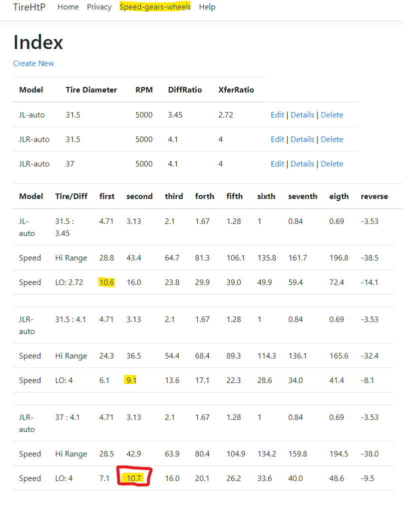

Hey thanks for the comments. Yes, tried 2H, 4H, and then 4L using manual gears. None could keep me from rolling faster and faster and RPMs went too high for my liking. I don't recall what the RPMs were - but clearly going too high.
I also believe that your Rubicon gearing vs my Sport S gearing will also make a difference. I hope my Wrangler can engine brake enough to make trail running in Rockies enjoyable. I'll try to find some steep slopes here in Minnesota to test out capabilities.
See my BT69.com gear calculator.
Stock Ruby in low range M2 is lower than you sport in low range M1. My JLR with stock gears on 37's in M2 is very close to yours in M1, and unless I'm really wheeling, M2 LR slows my rig down. So I still want to know where you were in LR M1 and wouldn't slow you down.
HR M1 are pretty close.
Thanks, Joe, for the excellent info. I've bookmarked the link for future reference.
We were coming down off a volcano on a gravel road on the Big Island in Hawaii. It was steep, but so steep that I didn't think the Wrangler couldn't engine brake is way down. What I'm hearing from others is that I couldn't maintain a slow speed because the rental Wrangler we had was the 4 cylinder. Apparently the small displacement over just 4 cylinders can't effectively hold the vehicle back in steep situations. A few folks with 4 bangers have made that comment. I'm hearing my 3.6 will do much better. I'm excited to head west next summer.
Thanks again!
