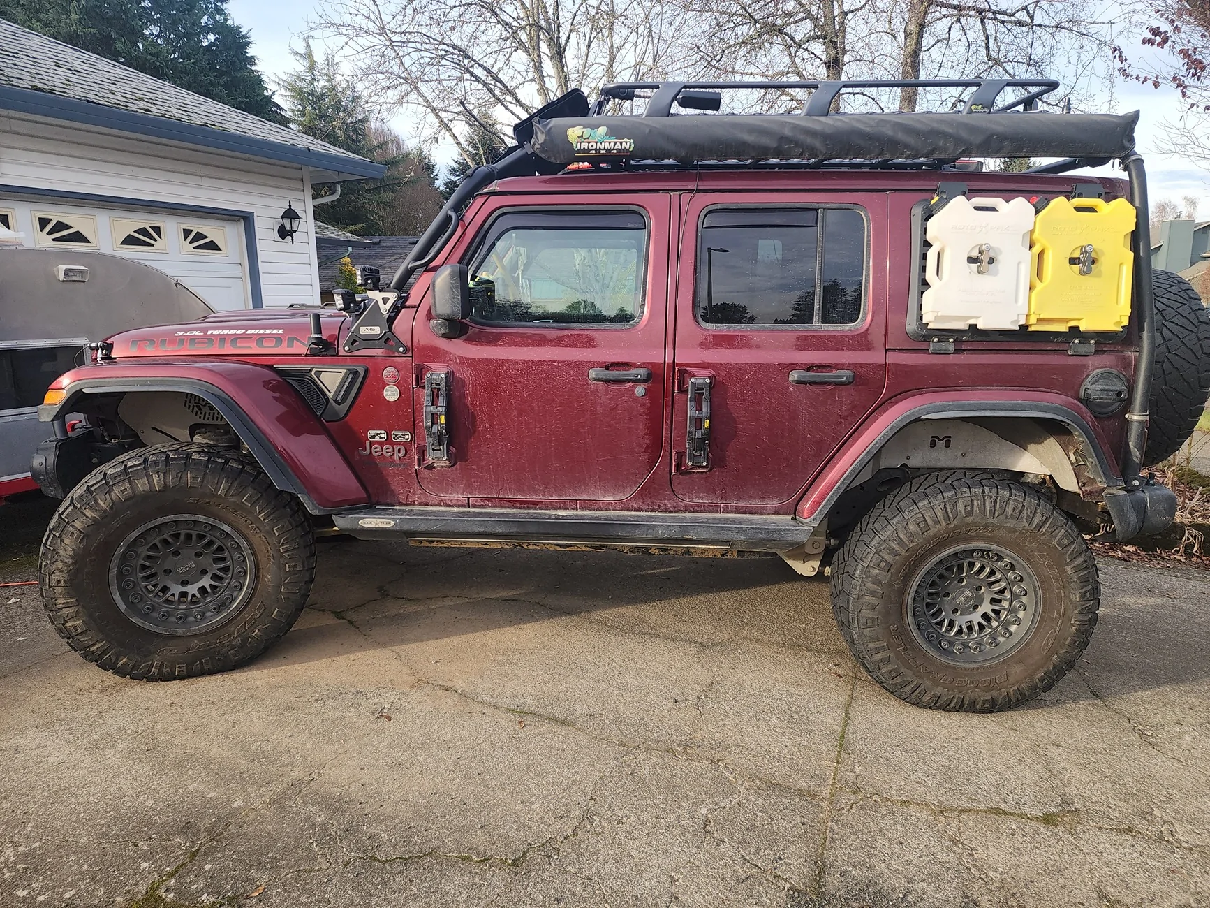

'21 JLURD with rack and awnings now on 37's. On advice of several places I went to 4.88's, found that was too low when in 4lo as I did most badge trails in 2hi or 4hi. Switched axles to Dana Ultimate 43 front and 60 rear with 4.10 but the MT Baja Boss AT tires are heavy and probably should have gone 4.56 since I weigh over 7K partly loaded.
It sucks that you went to 4.88s and they were too low. That must have been an expensive mistake.
It's a bit bizarre that you were doing badge trails in 2h, but then again, there are supposedly level 1 BOH trails out there. Note that 4.56s are working extremely well for me in my relatively-bloated JLURD.
