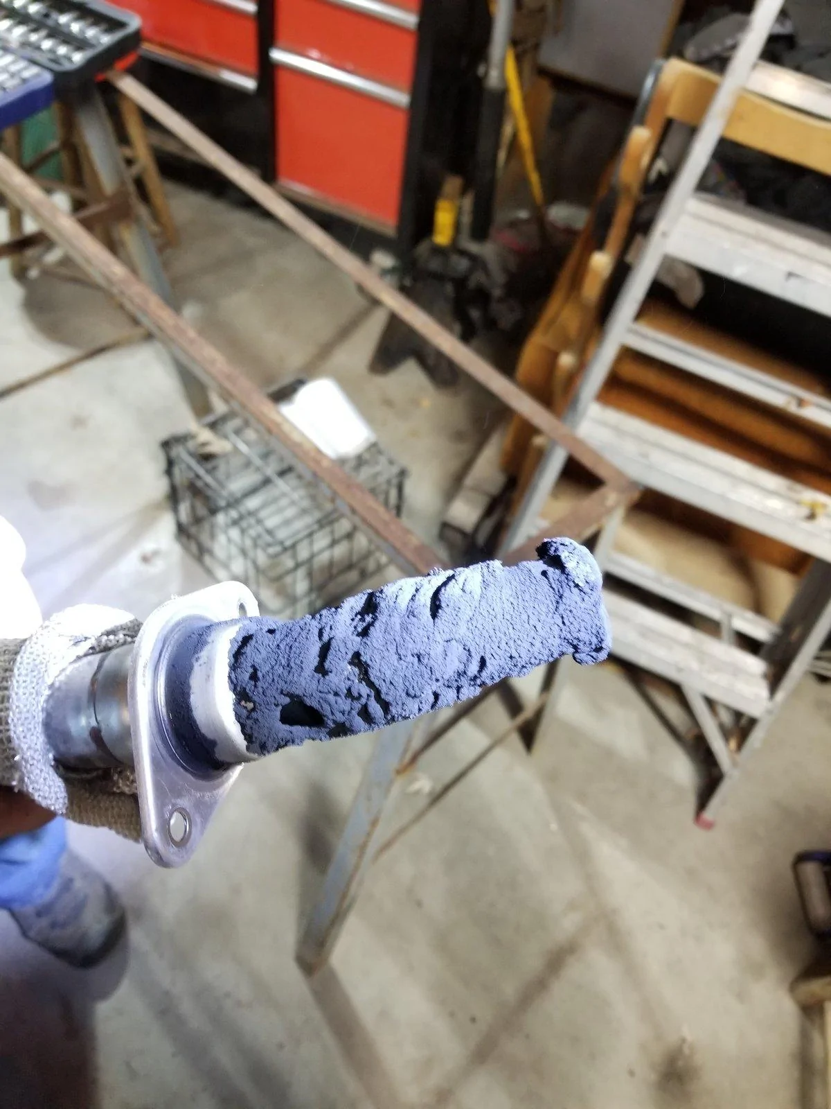

I have an ecodiesel in my GC. pics are from 54k miles... you be the judge....
Jeep Wrangler JL EcoDiesel Rebuild 20191102_124510
Jeep Wrangler JL EcoDiesel Rebuild 20191102_124833
*edited the fat finger 44k to 54k*

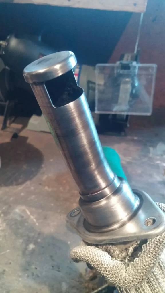

this is one a clean egr tube looks like.... Yes, they revised the EGR system... but my previous pics show what goes back into your intake.

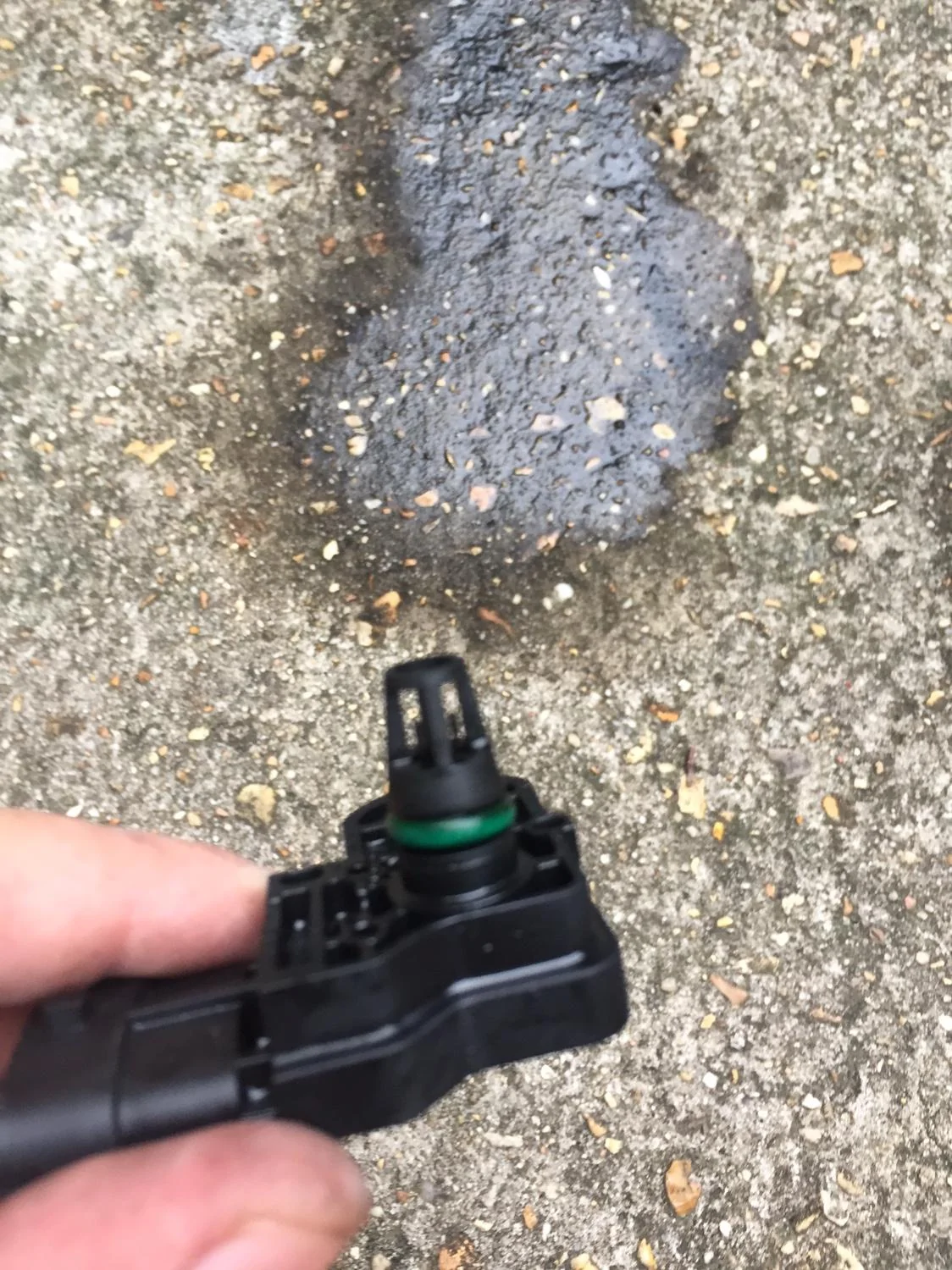

and here is a clean map sensor...

I have seen first hand the "soot" build up in my EGR & intake... not even counting the EGR cooler failures that leak coolant into the engine, it is literally a ticking time bomb. IF you are under warranty its great, FCA will pay to fix.... Unfortunately the deposits and problems show up after the warranty expires in most cases.
