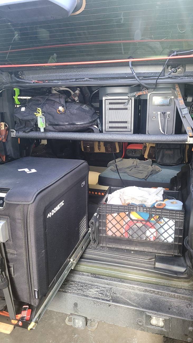

Jeep Wrangler JL Dual battery questions 20250115_124718
dpike
May 28, 2020
42
829
1,171
New Jersey
'20 JLUR 3.6
i have a GZ Yeti 1000X in the rear passenger footwell of my JLU. i have the rear seats removed and the rear seating area and cargo area platformed over. the set up works perfect for me and charges from my aux set up while driving or i throw out a panel if need me. electric blankets while camping are a game changer.

This is essentially how I have my setup now with my River Plus. It's above the fridge on the shelf. I move it and the fridge into the Jeep when I'm about to go on a trip, but it comes back out when I come home. I'm a bit worried about it flying forward in the event of a bad crash, however, even tied down. Also having that much weight that high up isn't ideal, but that's not a huge concern. this is my current setup for 4-5 days, more or less. I will use ratchet straps rather than bungees for the power station next time, and I hope to have a dual-zone Iceco to replace the budget JP-40 this year as well.
Jeep Wrangler JL Dual battery questions Jeep packing 5
As you can see from the above photo, I have to keep the passenger back seat folded down to store the five foot long Gazelle T-4 tent, and that precludes convenient access to the back/right footwell.
