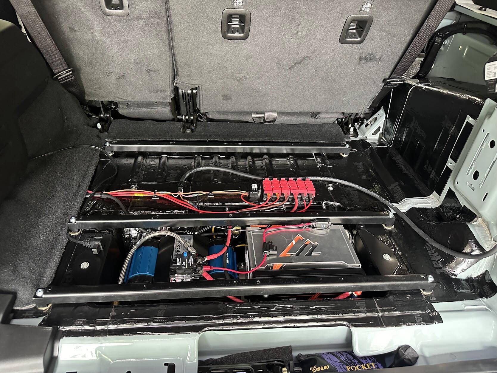

Mine isn't semi-permament... it's permanent-parmament... so maybe this isn't what you're looking for. I do not have any AC loads, so no additional inverter. For my 4 door, I'm running a 100Ah lithium in the cubby (so more like 1300+ Wh).
I located two BlueSea fuse blocks above the rear driver wheel well under the factory plastics. One panel runs constant loads (camp lighting, fridge, etc) and another runs ignition loads (GMRS radio, HAM radio, etc).
There's a third block for high amp fuses (compressor, DC-DC, fuse blocks). Also in this cubby is the RedArc DC-DC and an ARB compressor. It all fits nicely under the AAL plate system.
I ran a very similar system in my 2 door's cubby. That was a ~60Ah, plus the same DC-DC and compressor, only under a Goose Gear plate system.
That setup is exactly what I was thinking off doing and would love to have. Permanent base plate, fridge/slide and DC wiring, but many here are suggesting a portable power station would be better. It would be simpler, I agree, but better? How do you handle charging during cold weather months, or do you not get months at a time of sub-freezing temperatures?
Did you install this yourself or get it done professionally, and if the latter, could you recommend a shop? Part of me would absolutely love to have exactly this setup. I'm just not enamored with the battery stations aside from their ease of installation and versatility. I don't need AC for much, but I would like some basic AC availability, and the power station would work in that regard, especially if I intend to purchase and run a diesel heater (see comments from last week in that regard).
I intend to keep the Jeep until it falls apart and wheel it fairly often, as well as use it as my daily driver, so even having the fridge in there for grocery runs to the mall is a Good Thing!

I'm from Wisconsin, so we definitely get long periods of cold weather. However, I travel full-time and pull this Jeep behind us. Nevertheless, when freezing weather hits, the RedArc DC-DC (in lithium mode) prevents charging. Many batteries have this built in, as well. It doesn't last for long... the interior (and especially this cubby sitting above the exhaust), heat up very quickly.
Speaking of heat, the cubby does get warm under long travel days. In my 2 door I mitigated that by installing a different exhaust that relocated the muffler. For this build (the 4 door), I'm using sound deadening / thermal insulation (HushMat) and it has proven itself worthy.
This was a DIY install so I do not have shop recommendations, sorry.
When you say thermal insulation, you mean lining the bottom of the cubby? Wouldn't that exacerbate the heat buildup in there? In NJ our summers are brutally hot and humid, although, thankfully, not as bad as the deep south. But still a concern. I'm not running a custom exhaust any longer. It had a Magnaflow on it when I bought the Jeep but the noise was horrible and I sold it ASAP and got a stock muffler that I've been far happier with ever since.
What gauge wiring did you use to go to/from the battery? I'm guessing 4AWG for 50A? Did you run your negative lead directly up front or did you ground it all in the back?
I'm having difficulty seeing how that cubby is all set up. Looks like a lot more stuff back there than just two LiFePO4s and the Redarc; the ARB Twin and heaven knows what else. It looks fantastic bit I don't understand how it all fits in that small space.
Yes, lining the cubby and the whole rear cargo area (see the black insulation from photo).
No, the goal is to keep the exhaust heat out. There are large gaps around the plate, plus the aluminum that acts as a heat sink for any heat inside. We have wheeled in Moab, driven all day in 100+ heat, and aired up 3+ Jeeps without issues.
Wire gauge varies depending on need. For example, the DC-DC (only a 25A) has a 6AWG going from chassis battery, to fuse, through the firewall, and down the driver side interior. The negative is on one of the many factory provided grounds in the cargo area.
There is a bit more in the cubby including a Victron shunt for battery monitoring (SoC, temperature, etc), a time-off delay module for the ignition sourced loads, and plenty of wiring. However, it is a single 100Ah battery, not two. Unfortunately I do not have any more pictures, but there is a reasonable amount of room in this area.

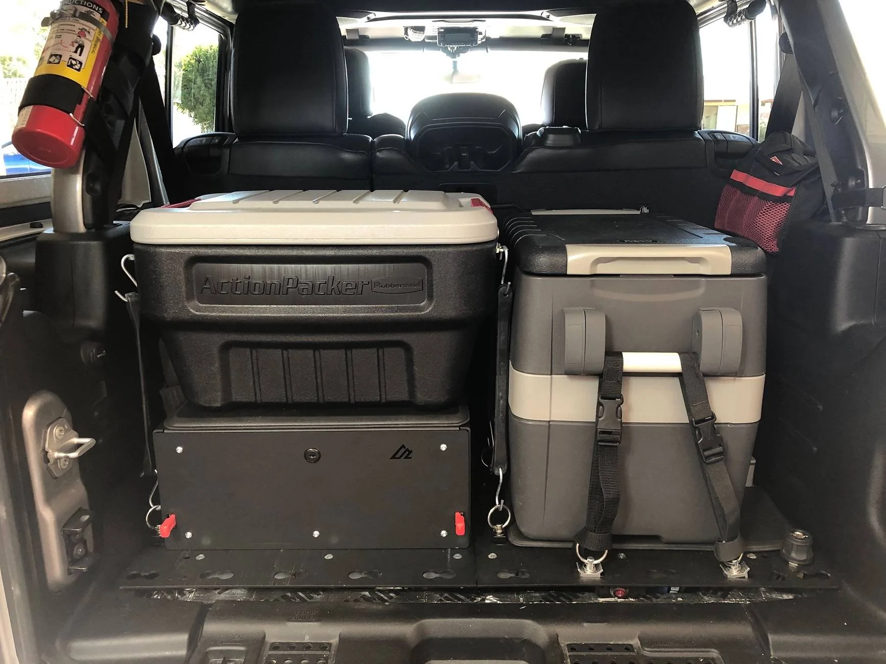

@NJRadioGuy I’m in the same boat as you trying to decide between a Ecoflow powerstation Vs installing a 100Ah LifePO4 ( ideally I would prefer a 200Ah LifePO4) under the cubby with a DCDC charger like a Redarc.
If you haven’t already, look up Matt’s (Ozark Overland) excellent install video from a couple of years ago or Asia’s another great video of the same at Baptism Overland
I have been researching for a 12v control hub to complement this install since it nicely covers up all the wiring inside the aluminum box, and comes pre-wired for all the output control sockets and rocker switches with a fuse block to attach accessories to. Check out Kickass or iTechWorld videos for reference .
I ‘d like to potentially add two 100Ah of LiTime LiFePO4s (the mini version since its smaller) in the cubby, but I’m still tying to figure out where I would install/bolt down the 12v control hub in the rear cargo area of 4-door Jeep JL( I can bolt a DCDC charger on top of the control hub instead of inside the cubby).
I have a Goose gear platform with a fridge slider already, along with a Vector off-road cargo shelf.
Im wondering if its worth going through all the trouble of a dual battery setup in the rear cubby with a control hub, OR just get a Ecoflow 1800W station and pair it with a Ecoflow’s alternator charger and be done with it.

I have a simular setup compared with Proptied. AAL M.A.S.S platform and drawer for tools. My DC to DC charger is the Victron Orion XS Smart 50 amp charger. One can have the control to charge from 0 to 50 amps depending on needs. The size of the unit is hard to beat as well as its dependability. I also have a Victron smart shunt to monitor battery and charging. There are other benefits that come with the shunt. One could do without it if you where to buy a 100 amp smart LiFePO4. You could monitor your battery charging and discharging and SOC from that. The compartment in the back is a great place for this setup. I live in AZ and have had this setup running for 3 yrs with no problems. My recent changes in the last year was to change Victron charger from 18 amp to 50 amp charger as well from a 50 amp/hr battery to a 100 amp/hr battery. The Victron 50 amp charger size allowed me to increase battery size. Another benefit was running ARB compressor off of the 100 amp battery. Before I had to run compressor off of the engine battery because 50 amp/hr battery BMS could not handle amp draw of compressor. In my setup all items fit in the compartment including all current protection. It takes a little time for layout and design but I couldn't be happier. I can't stress enough to make sure everything is securely mounted from movement including all wiring. Good luck.
