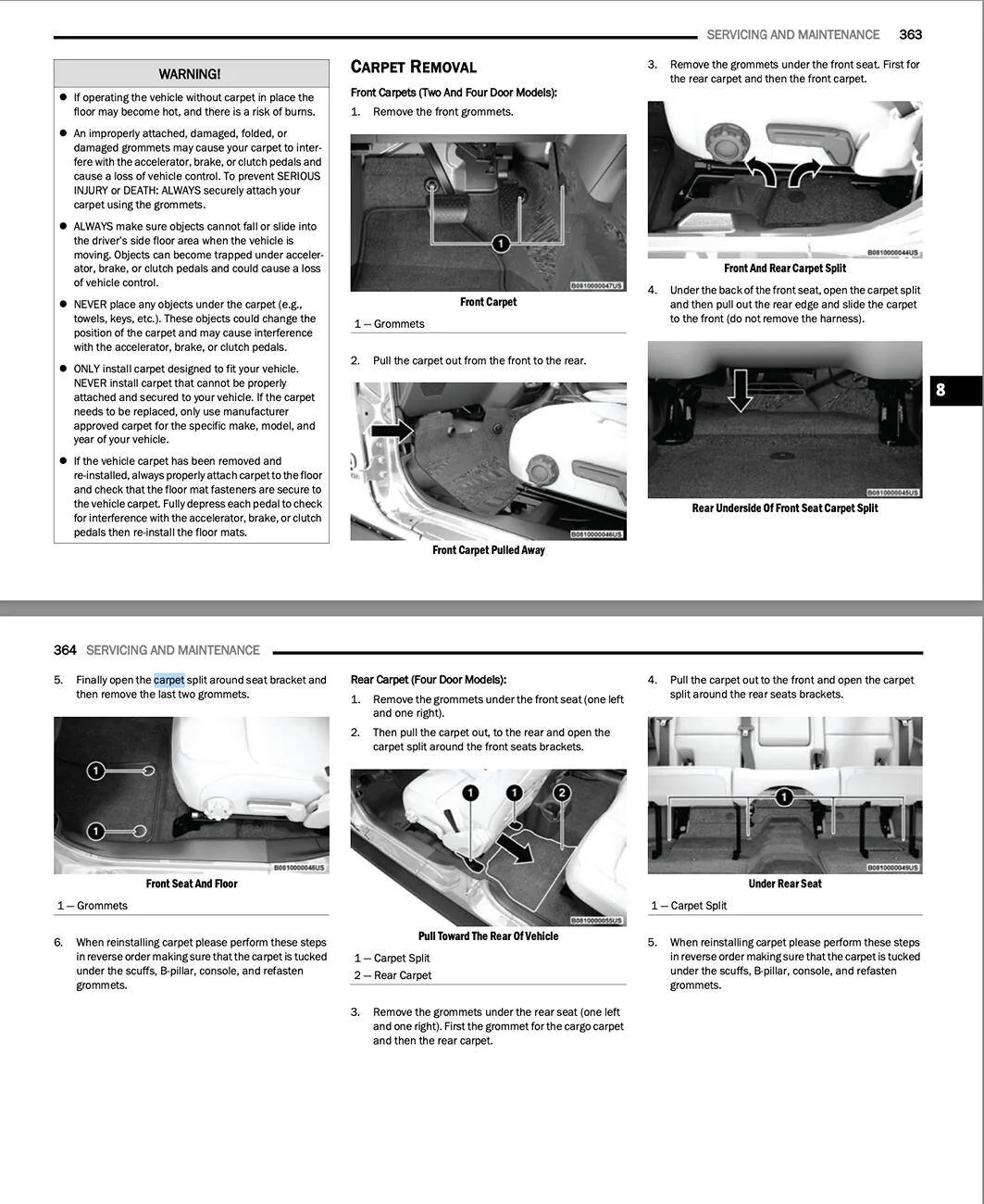

How to remove carpet and drain plugs is covered in the Owner's manual.
I have not been able to find this in the owners manual.... used key word search..."drain" "plug" "drain plug" ...lol.... can you direct me a little further ? and thank you for the reply and your time !!

Well, at least the carpet removal is in the '23 Owner's manual starting on page 363. Take out the carpet and you'll see the drain plugs. They just pop out.
Jeep Wrangler JL Drain Plugs Screenshot 2024-07-23 at 14.35.48
But if you need to see pics of the actual plugs and locations, the Armorlite flooring install guide shows them pretty well. Link to their install guide
Thank you... very considerate to reply with this... I did see this in the manual, and it will help me out locating these drain plugs. Still don't know why they would not have these clearly marked and cut out.... probably just not an issue with most Jeepers apparently.... I have the half door package and like to run with top / windows off. Get caught out sometimes.... TMI probably. Thanks again. Brad
