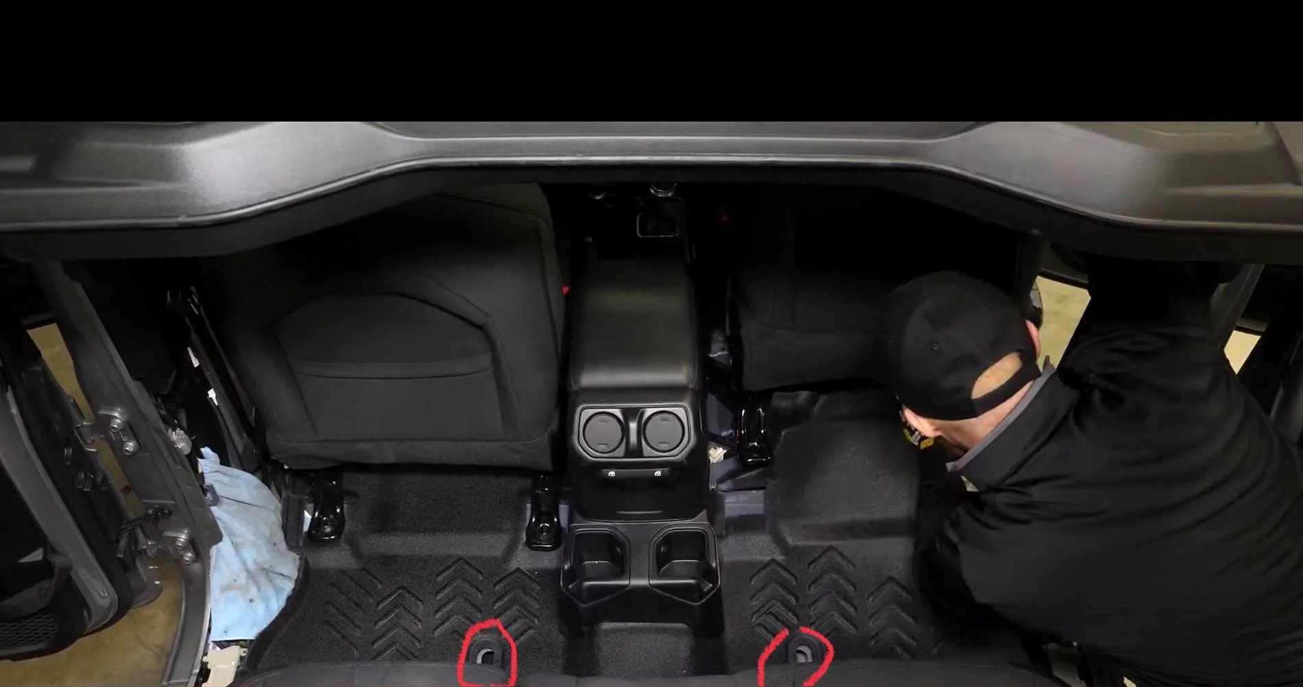

2 front footwell, 2 rear footwell, jack storage area, rear cargo storage well or whatever it’s called, probably more. Don’t be afraid to pull up carpets etc to look. You’ll probably find some spare change and soggy french fries

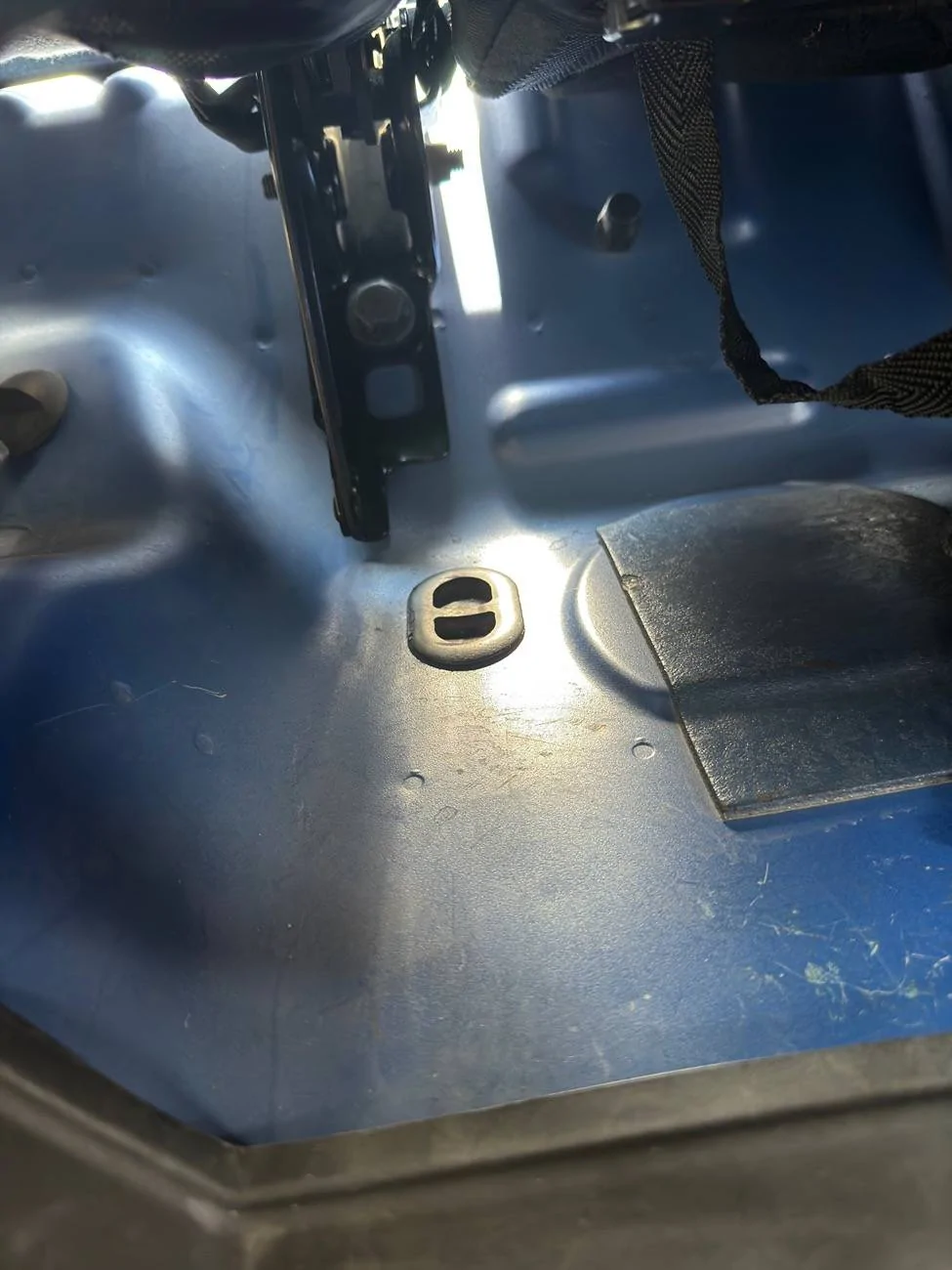

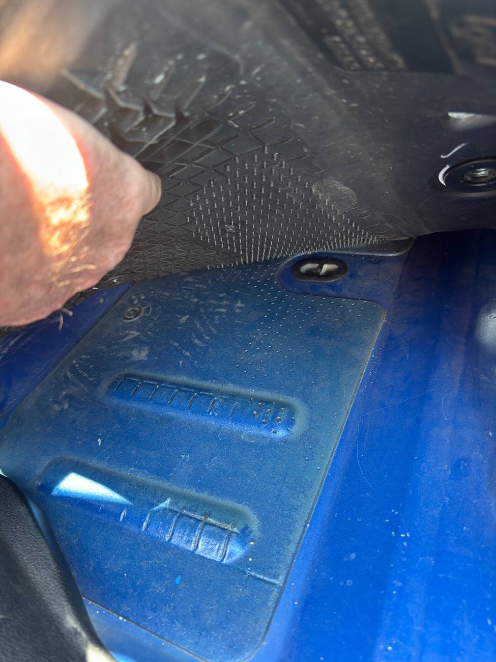

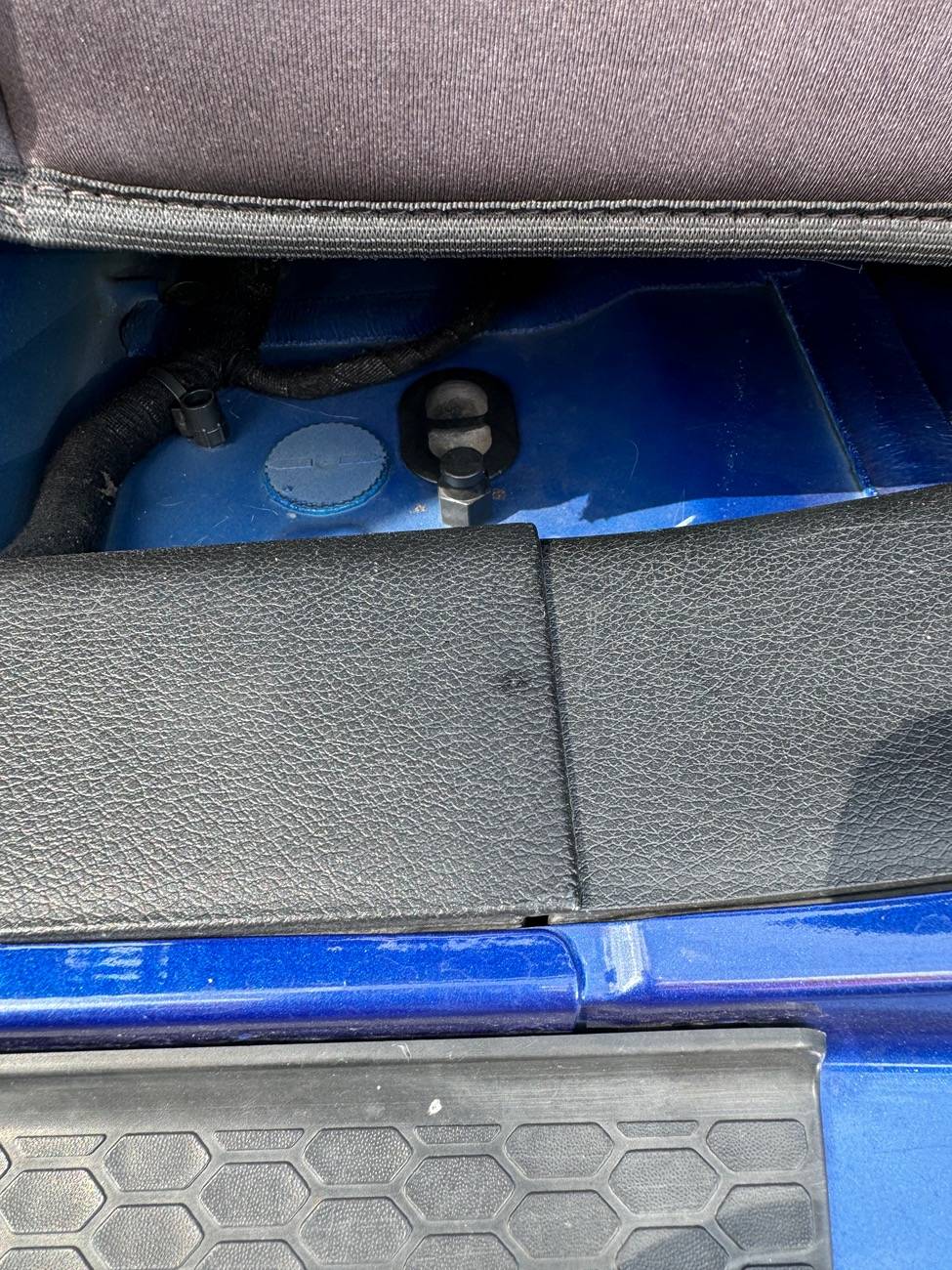

2 front footwells, 1 under each front seat, 2 rear footwells, 1 under each outboard rear seat and 1 in the rear under the stock jack. Remove carpet and put mats back down. You will thank me later.

I realize this is not a product you are installing but it’s does show the carpeting and drain plugs if you skim through it

1st pic is under driver seat. It will be the same on passenger side. 2nd pic is under rear driver bench seat. Will be same on passenger side also. 3rd pic is rear footwell. It is closer to the console area. Cutouts should be there but may be hard to see. It’s been so long since I had carpet I don’t remember. Hopefully the pics give you an idea of location.
Edit:You’re a smart person. Don’t ever doubt yourself.
