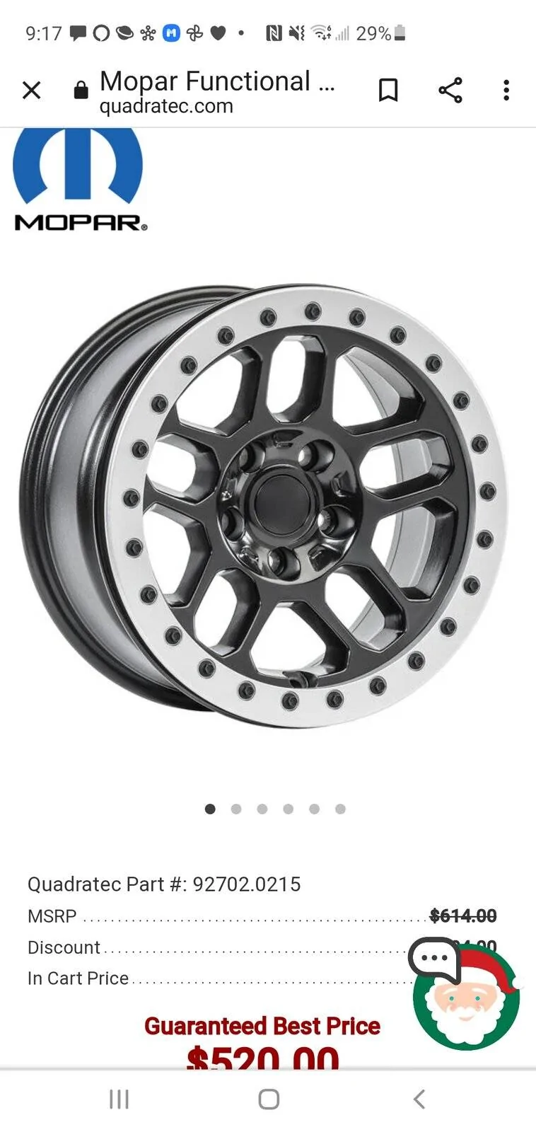

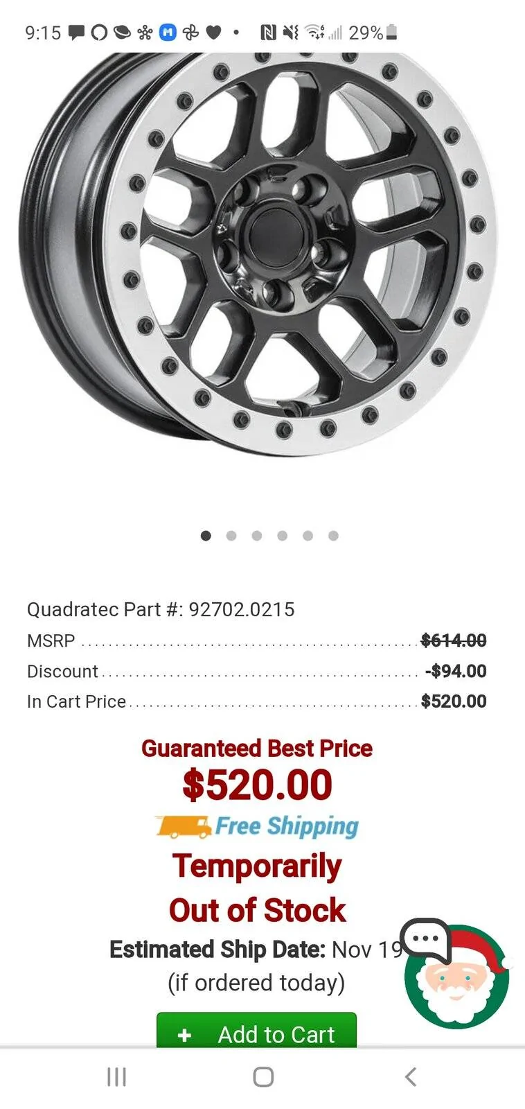

Wow that's bizarre. Any idea what caused your issue? Was it just a few that broke off or many? Did you follow the torque specs and installation sequence or did someone else install the rings? Doing it correctly (torqing 125 bolts) is VERY labor intensive. Just trying to figure out how to avoid any issues in the future. I know they are dissimilar metals but this really shouldn't happen and Mopar didn't spec anything (never seize) on the install.
These aren't cheap wheels and Mopar claims the bolts are hardened steel.
Is anyone else having issues?
