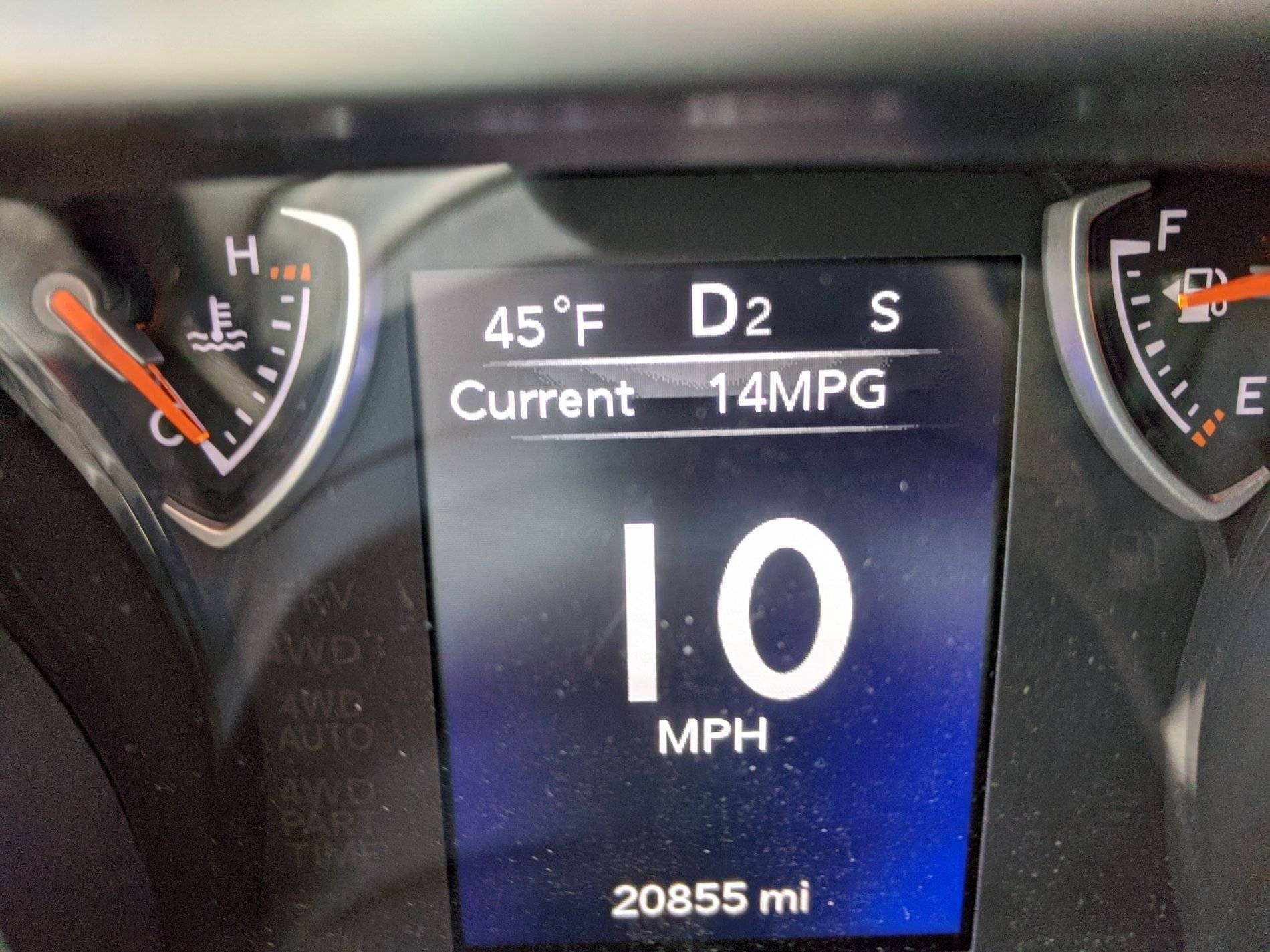

Is there a digital read out where you can see what gear you are in? If so, how do you program the dash to display it?
Randy,
As others just posted, there is a configuration setup via the 'Electronic Vehicle Information Center' (EVIC) in the center of the instrument cluster. According to the JL owners manual pg. 202:
"Screen Setup
Push and release the up or down arrow button until the
Screen Setup Menu Icon/Title is highlighted in the instrument
cluster display. Push and release the OK button to
enter the sub-menus and follow the prompts on the screen
as needed. The Screen Setup feature allows you to change
what information is displayed in the instrument cluster as
well as the location that information is displayed."
Look for the configuration item named 'Current Gear' and change it from 'Off' to 'On'.
Current Gear
• On
• Off (default setting)
Then when in Drive the gear # will be shown as D1-8. When in Autostick, just 1-8 is displayed.
I find that being able to watch the transmission shift is very useful information. Because of it, I use the Autostick feature way more often, especially at highway speeds, in order to either up or downshift into or out of 8th gear.
For reference, I drive a lifted 2019 Sport S on 35s with the stock 3.45 differentials. So 8th is not selected as often as it used to on the stock 31.5" tires. My eighth gear is essentially now "Overdrive on Steroids" with these bigger tires. I typically get about 3 to 4 more mpg when I use 8th more aggressively.
However give credit to this pretty amazing ZF8 transmission. Since I manually shift into 8th quite often, the trans seems to have noticed and it shifts into 8th much more frequently than it ever used to. It's nice to notice it's in 8th already whenever I go to upshift. Still it doesn't select the top gears like it did purely stock but with a visual indicator I can control this transmission now just like a manual but without the clutching calisthenics.
The current gear presentation is really cool. You can watch just how smooth the shift points are, particularly in the middle range. It's remarkable to see when the shifts occur, especially when they are not mechanically discernable.
Off-road, I find that I'm generally always in Autostick (manual mode). I find that explicit control of the gears is way better, especially in 4lo. Many Jeepers would never even consider an automatic transmission just for that very reason. With this 'Current Gear' setup configured, this ZF8 is a better manual trans than the manual transmission itself. You can now pick up and control things manually (or not) based on whether you believe you can do better than the trans controller. For me, this makes Jeeping way (way) more fun. Man vs Machine sort of thing.
It amazes me that this display configuration is not 'On' by default.
Jay
