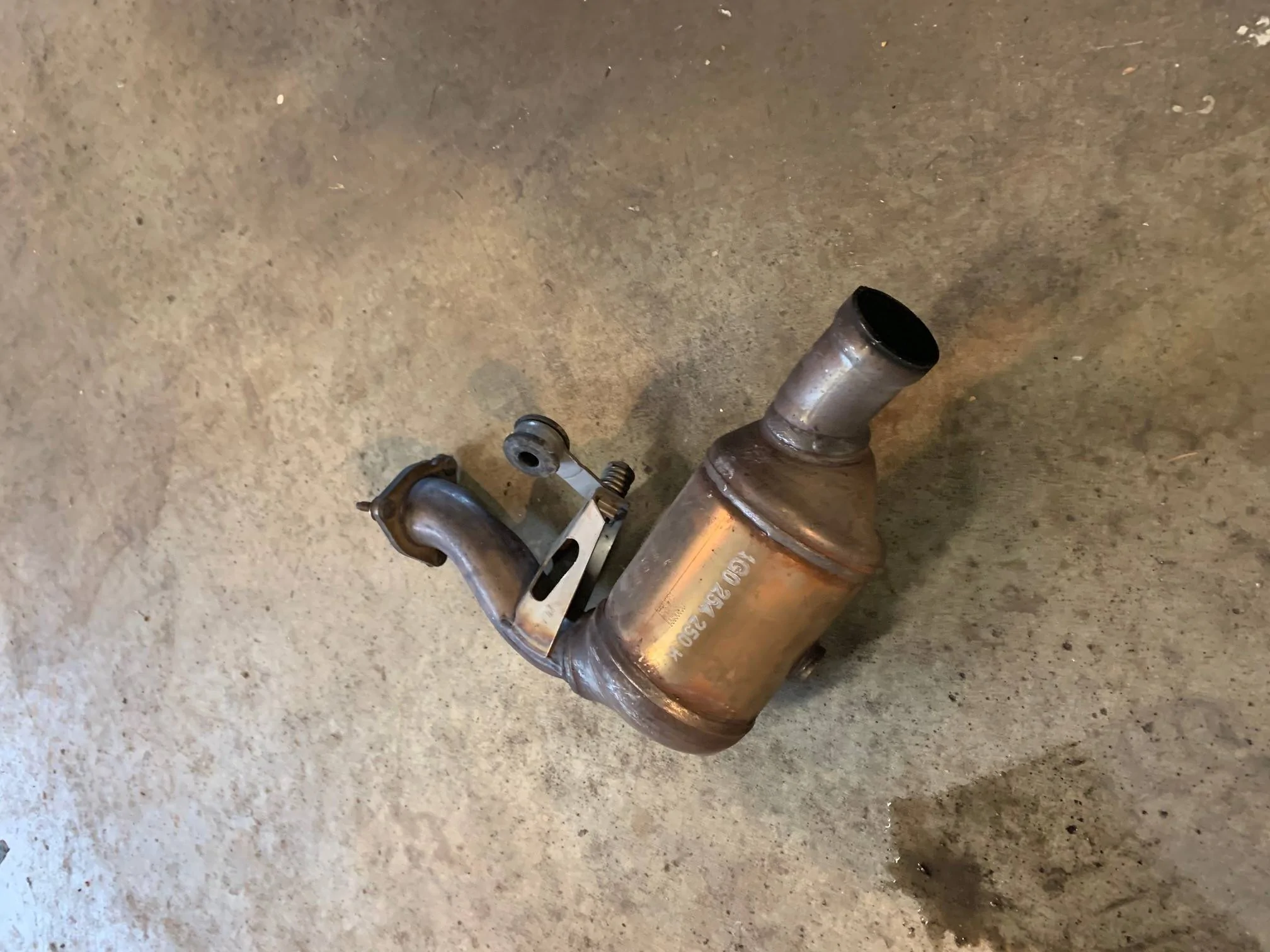

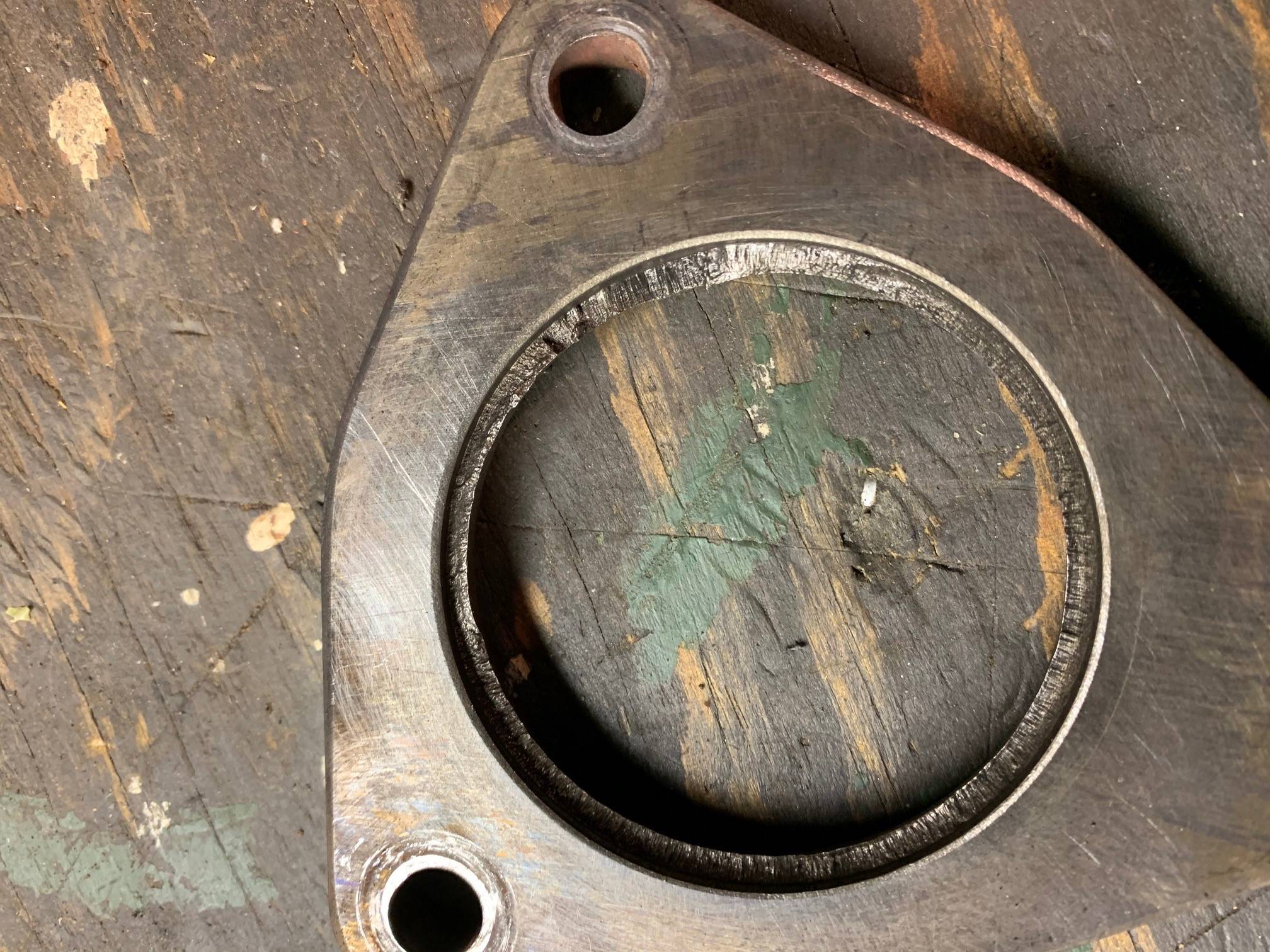

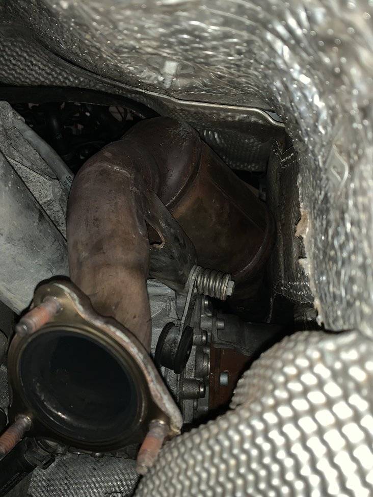

The absolute worst part kick in the balls after doing the chains on the Audi was 2 months after I put the engine back in the passenger side cat broke off at the flange against the exhaust manifold. Took 3 to 4 feet of extensions from under the car to get at the flange to pull the nuts. 3 exhaust studs, 2 on top and 1 on the bottom. I could access the bottom from underneath but the top I had to take the cowl apart for access and I need 2 feet of extensions and a trouble mirror to get on the studs. 1/4 drive was my friend from the top as the 3/8 was just too heavy to maneuver.
The flange was a very crappy weld from the factory
That job was a complete pain in the Nixon.
