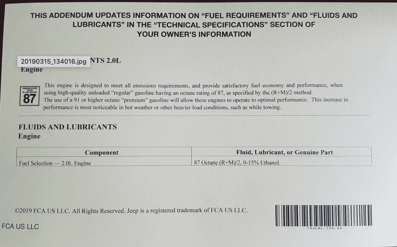

It’s been clarified and changed for all JL model years including 2018. FCA even put out a special “blurb” about 18 months ago announcing the language Changes and clarifications
Here is the change included in the Addendum:
Jeep Wrangler JL Do we have to run premium? Screen Shot 2020-11-01 at 6.28.35 PM

Which, I believe, is exactly the language I posted from the 2020 owners manual on page 1.
You are correct. You posted the reference in the manual.
This addendum is what changes the manuals that don't have that language.

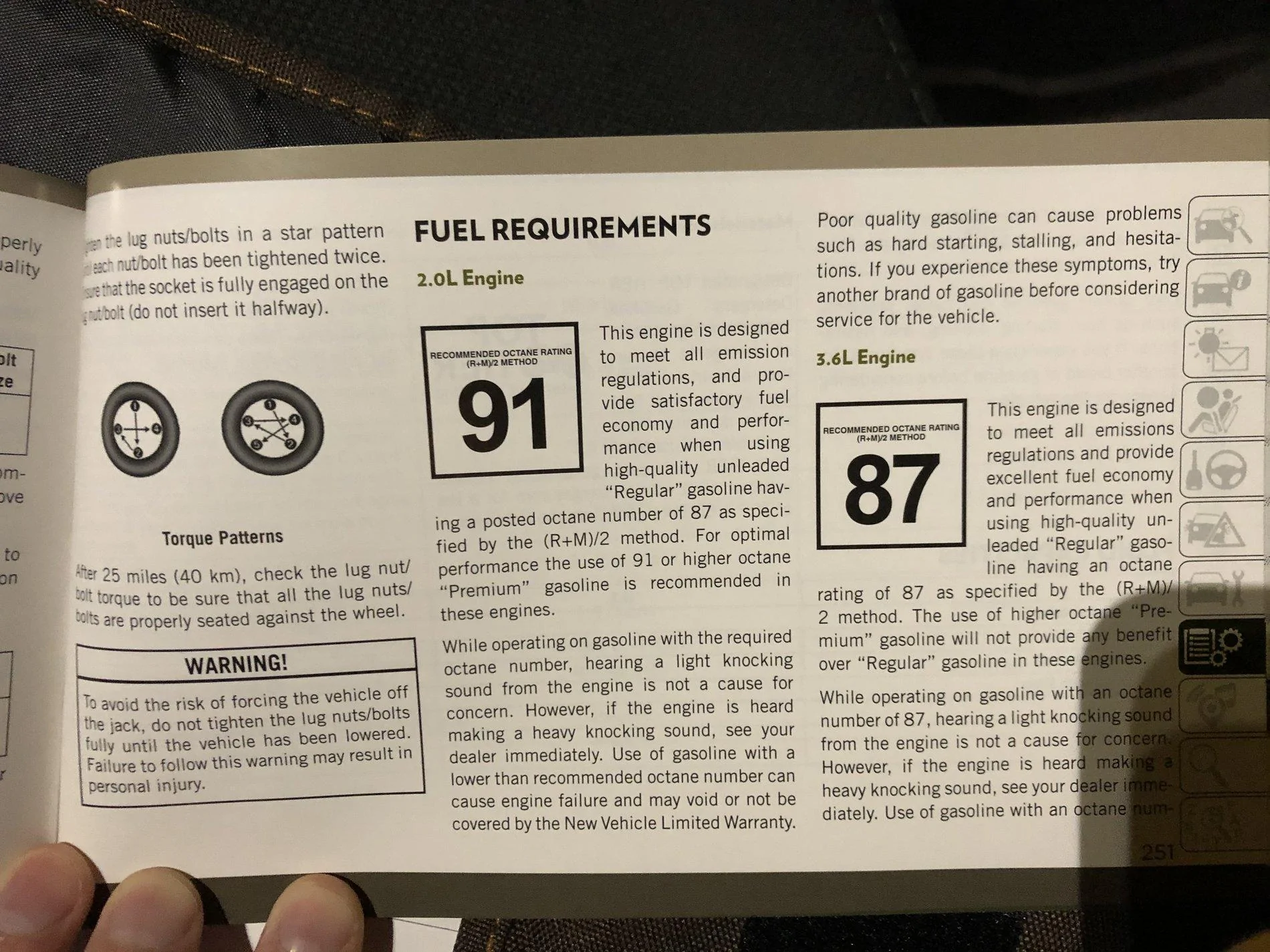

For the v6, you won't see or feel a difference, the 2.0t is a different story. Jeep doesn't give a number for the extra octane, just states for peak performance. Other manufacturers with similar engines actually give a hard number. Mazda rates the 2.5t engine 25hp higher on 93 octane vs 87. Being that jeep hp rating for the 2.0t is very similar, the difference really could be 10% more horsepower. We've run nothing but 91 in our 2019 jlur, so I can't say if you'd feel a difference. I can say that even on mountain passes above 10,000 ft this jeep is a rocket compared to any other jeep I've ever driven (20+ fwiw) and I wouldn't dream of degrading that performance in order to save a couple bucks.
Jeep Wrangler JL Do we have to run premium? Screen Shot 2020-11-02 at 10.57.41 AM
Octane has NOTHING to do with power. Please stop spreading this fallacy around.
