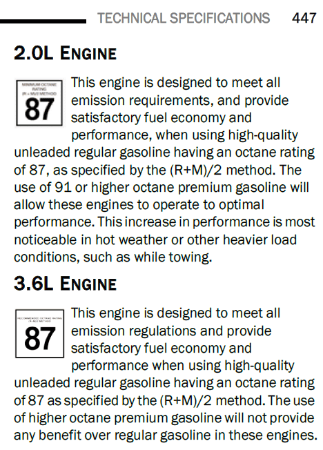

The performance improvement from higher octane gas was significant enough that Jeep wrote about this very topic in the manual...
Jeep Wrangler JL Do we have to run premium? 2021 Jeep Wrangler Manual Page 447 Octane
...but Jeep doesn't say by how much higher octane will increase performance, do they? Just that it does by some noticeable amount.
I stumbled across this very topic by accident. When I picked up my vehicle from the dealer, it ran well enough. Then suddenly, right at the 500 mile mark (after what the manual calls a break-in period), the engine came to life and offered up a big boost in performance. Knowing nothing about this issue, I started a forum thread asking if Jeep put a governor on the vehicle to keep things for engine break-in during the first 500 miles. HA!
What I eventually figured out was that up until recently, I had been filling the vehicle with 87 octane gas. The last two times I tried 91 octane just for the hell of it. I completely forgot about it, and when I got a hell of a boost, I was wondering why! And you know why I got such a significant boost? These were sizzling hot 102 degree days. The very condition under which Jeep says the ncreased performance is most noticeable.
So hey, I agree with you the performance is not always going to be there. And if you look at the section I posted about the 3.6L engine, "higher octane premium gasoline will not provide any benefit [...] in these engines". It's not universal, it's situational (having a turbo, having hot temperatures, towing a vehicle). The temperatures have cooled off quite a bit (low 70s) but I still believe I'm seeing increased performance.
Earlier you asked for proof that premium runs better. Jeep says it won't do anything for your 3.6L engine, so I can understand why you don't see anything (despite compression ratios). Anyhow, come next summer, if you've got a metric for proof that you'd like to see, I'm game. Let me know and I'll give it a shot.
Now if you're asking for me to run a couple of dyno tests, I'm afraid that you're going to have to foot the bill for that one. ?
PS: I agree with you on the issue of engine life. The vehicle appears to adapt and remember it's adaptation to a tank of gas. Sure, there might be a small bit of initial knock for a very brief period before it adapts, but that's insignificant compared to years gone by where a vehicle would run in that state the entire time. Unless the engine was on the edge of being damaged, I don't see a short term knock harming anything.
I stumbled across this very topic by accident. When I picked up my vehicle from the dealer, it ran well enough. Then suddenly, right at the 500 mile mark (after what the manual calls a break-in period), the engine came to life and offered up a big boost in performance. Knowing nothing about this issue, I started a forum thread asking if Jeep put a governor of the vehicle to keep things mild for the first 500 miles. HA!
What I eventually figured out was that up until recently, I had been filling the vehicle with 87 octane gas. The last two times I tried 91 octane just for the hell of it. I completely forgot about it, and when I got a hell of a boost, I was wondering why! And you know why I got such a significant boost? These were sizzling hot 102 degree days. The very condition under which Jeep says we'll see increased performance.
So hey, I agree with you the performance is not always going to be there. (And if you read the section I posted about the 3.6L engine, "higher octane premium gasoline will not provide any benefit [...] in these engines." It's situational (having a turbo, having hot temperatures, towing a vehicle). The temperatures have cooled off quite a bit (low 70s) but I still believe I'm seeing increased performance.
My answer was to someone asking about the 3.6 V6. Jeep has never hinted at the use of higher than 87 for the 3.6 V6. I don't really care much about the 2.0 Turbo because I didn't buy that. But I am always curious about random shit, just for the sake of it, and so I came here.... But I am not willing to pay for something that wont change my life at all lol.
You're quick to the draw! I edited my message just a little too late. I agree with you on brief engine knock and the life of the engine. I don't see it having an impact. I am led to believe that, in general, the higher octane fuels also have higher amounts of detergent added to them.
So you and I agree on octane on the 3.6 (and knock and engine life), what are your thoughts on the increased additives added with higher octane fuel and their impact on engine life?
