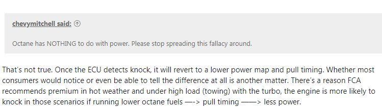

Octane has NOTHING to do with power. Please stop spreading this fallacy around.
That’s not true. Once the ECU detects knock, it will revert to a lower power map and pull timing. Whether most consumers would notice or even be able to tell the difference at all is another matter. There’s a reason FCA recommends premium in hot weather and under high load (towing) with the turbo, the engine is more likely to knock in those scenarios if running lower octane fuels —-> pull timing ——> less power.
Yes. It is true.
Pulling timing once detecting knock is an ECU function as you have stated.
Nothing to do with Octane ratings of the fuel. The energy in the fuel does not change from 87-91-93.
This has been beat to death for decades.

When the ECU pulls timing, it reverts to a fuel map that makes less peak power like you said, you’re agreeing with me if you understand what less ignition timing does. I’ve tuned multiple turbo engines over the years, I’ve personally seen the difference between the different fuel tables on multiple platforms and the effects of heat and lower octane fuels on fuel strategies/timing.
When did I say anything about less energy? If the ECU pulls timing, the engine makes less power. The ECU will pull timing running regular under the conditions I mentioned (and the conditions that FCA mentions in the owners manual). Again, whether it’s a noticeable amount depends on the user and operating conditions.
...and when did I say anything about timing?
I wrote why that’s not correct, lower octane fuel will cause the ECU to pull timing and run a lower power map. Nothing personal, I disagree with some of what you wrote and said why. That’s how a forum works, reply if you disagree with anything that I said and set the record straight.
Alright, man. This is the last reply I'll give you on this topic. Please do your homework.
My point is: Octane has nothing to do with power.
You can run 87 - 91- 93 - 105; it doesn't matter. They will all produce the same or marginally the same power.
In order for the octane to come into play for power, other things must be changed. You must change those "other" things in order to make more power. The octane of the fuel is not what is making the power. The advanced timing is. The higher boost pressure is. The air density is. The cooler air is. NOT the octane rating of the fuel. Having a higher octane rating just allows you to advance timing. I understand what you're saying. I've been doing this a long time, as well. There is no power increase unless you change timing. Octane doesn't matter without timing.
You will not feel a difference unless something else changes. Even then, most timing algorithms are written to cut the advanced timing short. This is why people that run 93 in their corollas (generally speaking) end up with plugged catalytic converters at 100k miles. The knock sensor input and the ECU will not allow for endless timing advance. It will cut it short unless you have a tunable ECU and a map created outside the factory tune, which are likely dialed way back to keep from breaking things to begin with.

You tell me to do my homework, yet nothing I said was incorrect and it comes from first hand experience. You don’t seem to understand that the engine isn’t running at optimal efficiency on low octane fuel when the ECU starts pulling timing. The engine produces less power on low octane fuel under high load conditions and high heat conditions to protect itself. There is a benefit to running premium fuel depending on operating conditions which is why the engineers recommend it.
Stay true to your word and make that last post your last reply to this, you’re giving people bad info on the subject. The engineers knew what happens with low octane gas which is why they recommend premium under those conditions.
