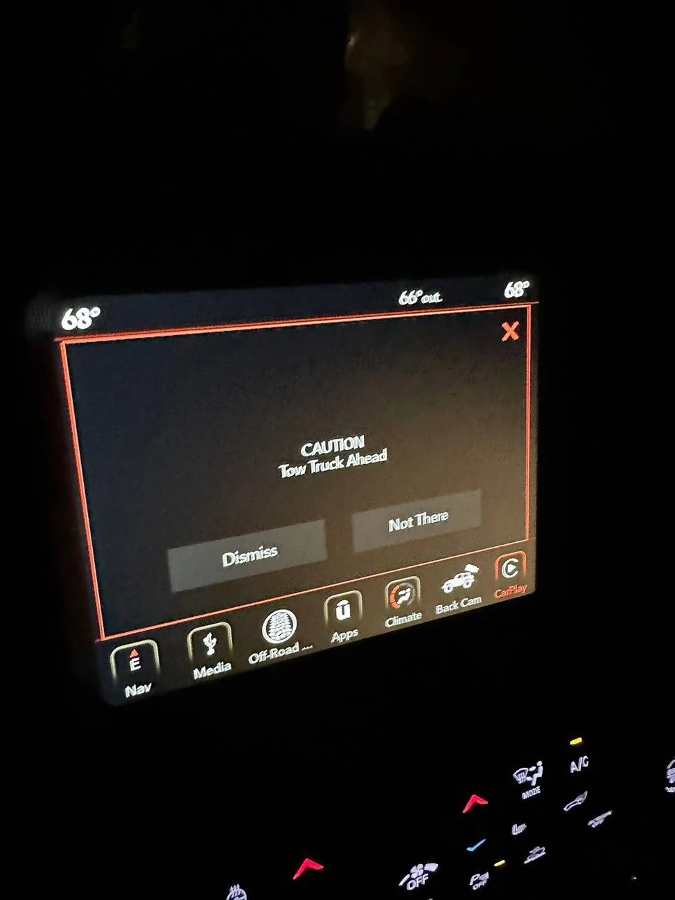

My 2021 had some OTA update and I starts to get this in 2024. Annoying AF, it stays there forever you have to touch the screen to make it go away.

These alerts are annoying AF. I live close to a hospital (within in mile) and within a fire station (1/4 mile). I get these alerts daily and most of the time I never see the emergency vehicle that is supposedly putting out the signal. Or if I do see the emergency vehicle in question, their lights are even on. Which is bullshit because I don't need to be on the look out for that.
All in all a stupid "feature" that I wish could be disabled with JScan.
