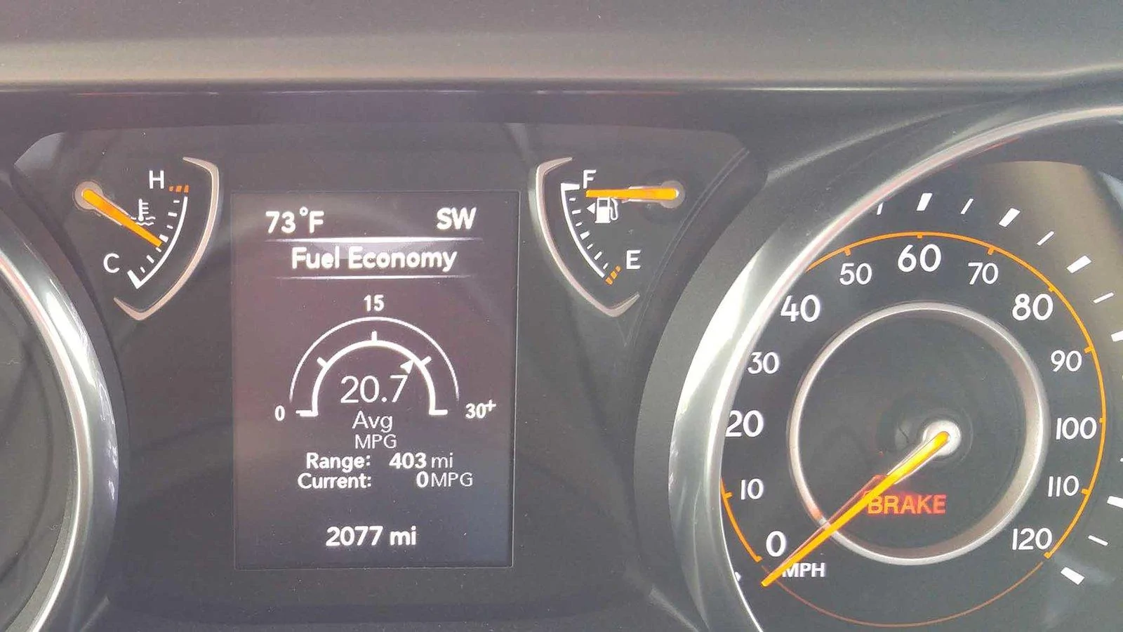

It doesn't look like I'm getting the full 21.5 either. Before I fill the tank, I note the remaining range and avg. mpg. I divide the range by the avg. mpg to calculate the gallons left in the tank and add that to the amount of gas it takes to fill. It's been coming out right around 19. Based on the fuel gauge being just under the full mark when I fill it, I'd say my tank is not getting full.
Fixed - gas tank replaced

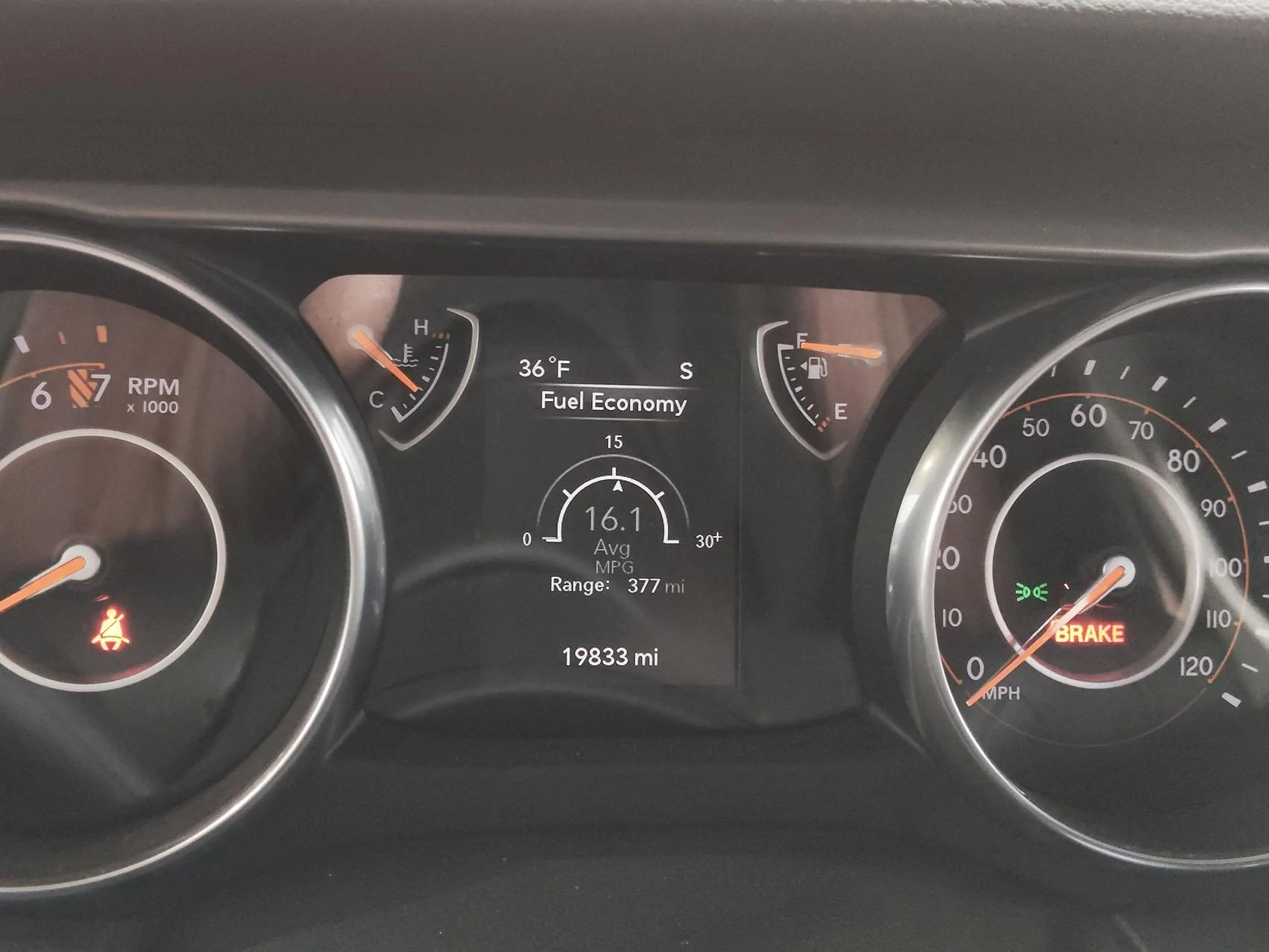

Wonder if its the tank sending unit then? Mine still wont read full
I think it is a problem with the tanks that won't fill all the way. My impression is maybe gained a couple gallons based on topping off a half full tank. My JT fills all the way as it should and I didn't get any push back from my dealer when I requested the tank replacement.
