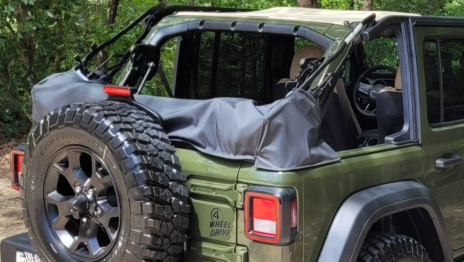

Smittybilt is one size fits nobody. Actually... It might work well on a 2 Dr. Too tight for the 4dr, couldn't get it to zip up all the way across, and just looks a little funky.
Most reviews say the same thing. You can definitely muscle it on, but it's not perfect. If your windows are this hard to slide in, you might have some problems with your windows :muscle:
Jeep Wrangler JL Does Anyone Completely Remove The Soft Top Frame Every Day? 20220605_121555

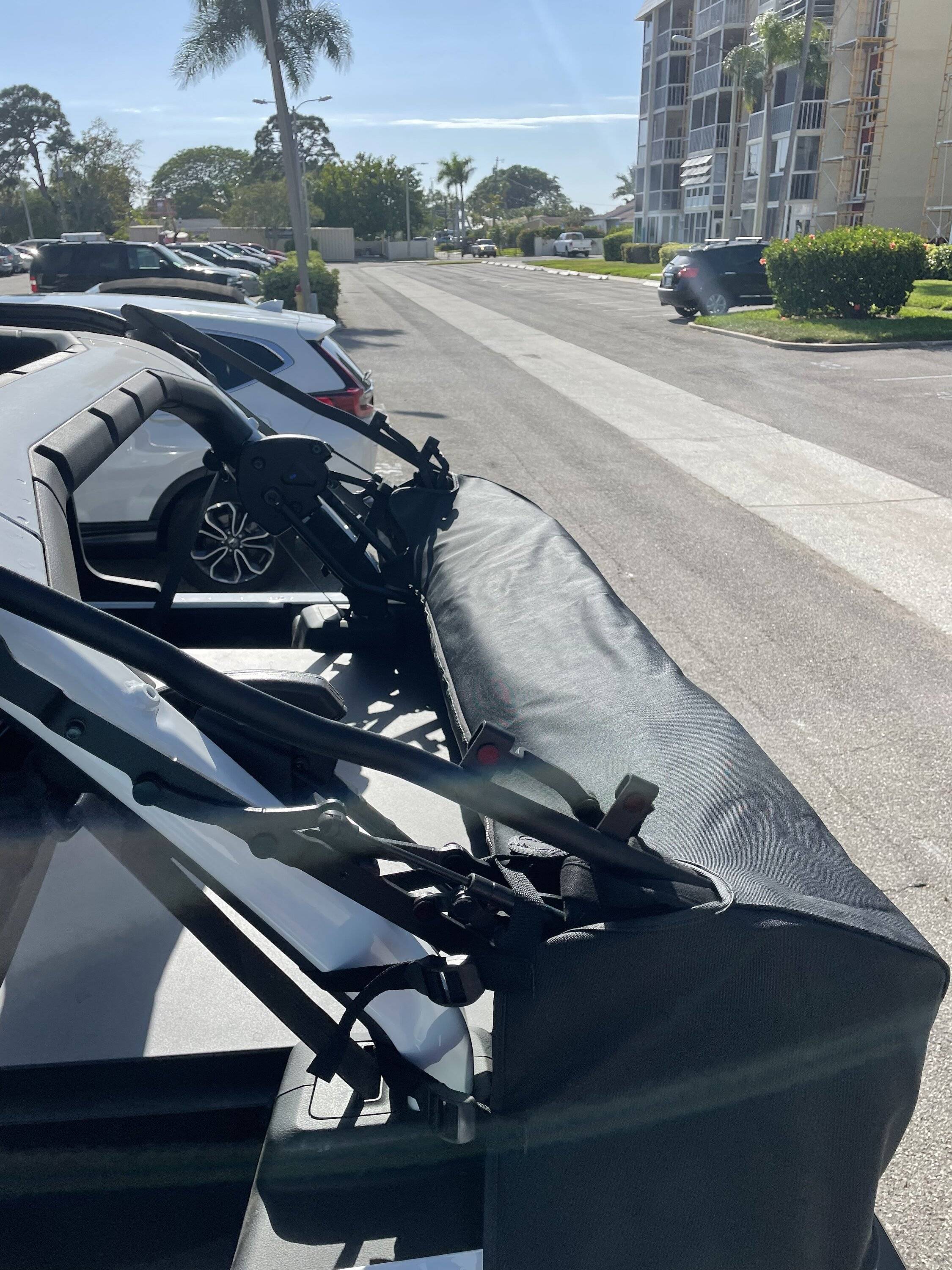

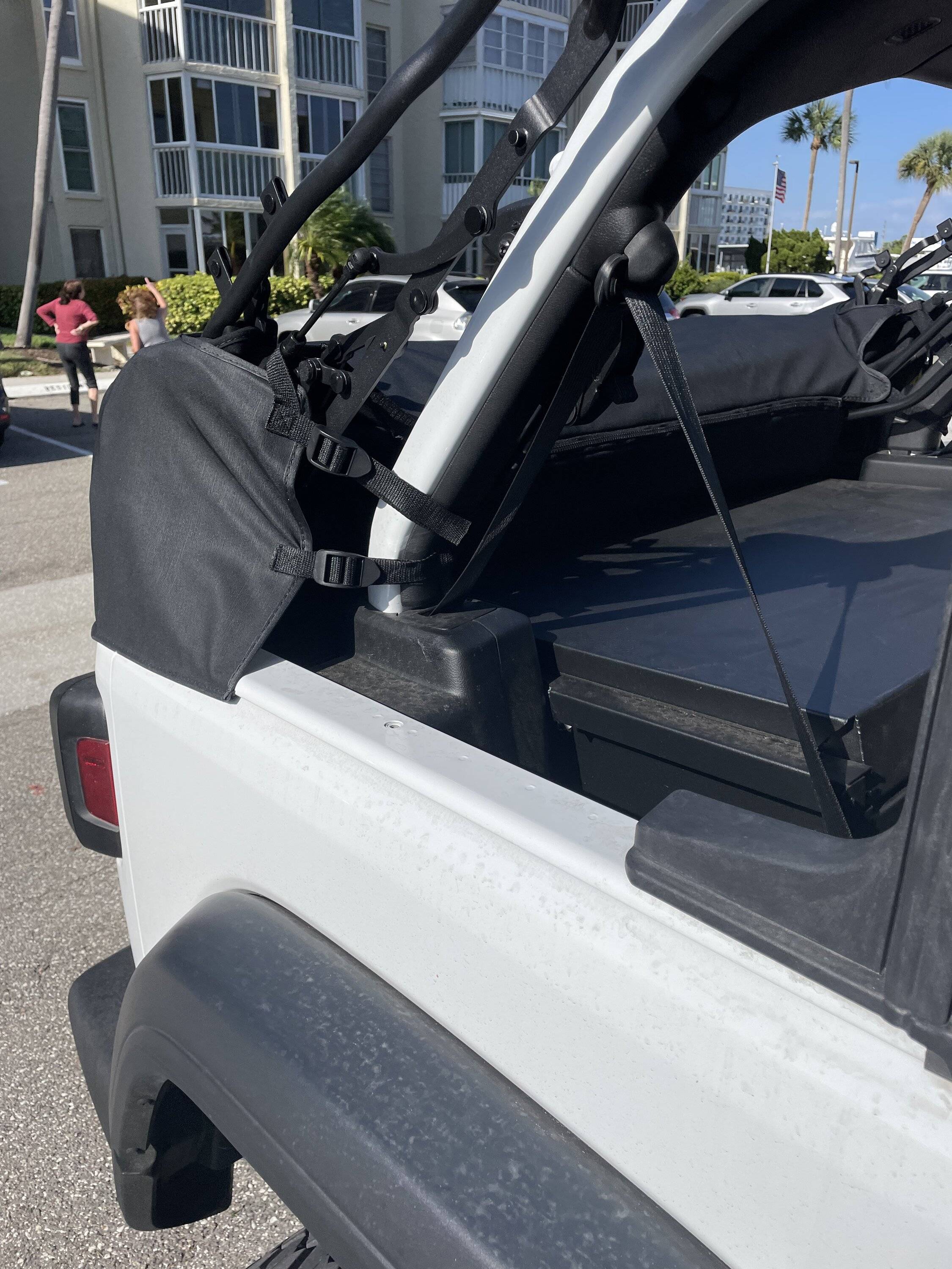

That's the smitty-boot ... fits just fine & install is no more difficult than putting the windows back in.

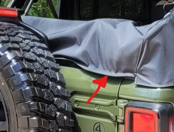

As far as I can tell ... you're doing it wrong.
That seam is supposed to slide into the c-channel on the whatever-its-called that goes above the tailgate. You can't pull the bottom of the boot far enough forward like that.
Jeep Wrangler JL Does Anyone Completely Remove The Soft Top Frame Every Day? Screenshot 2022-06-28 135409

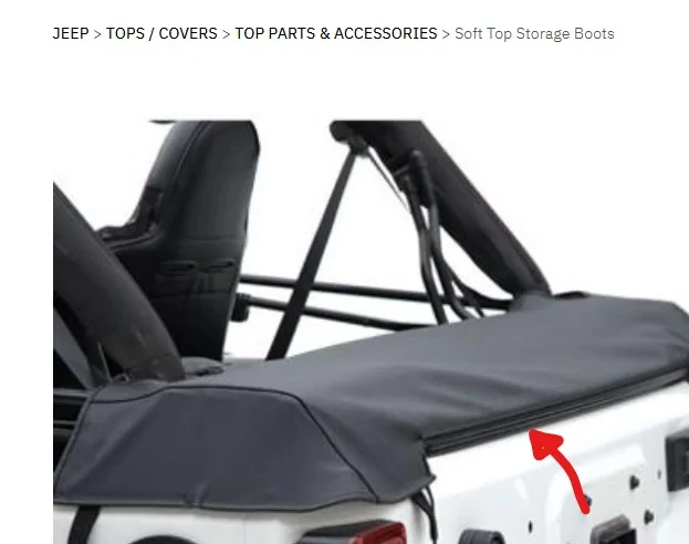

It should look a little more like this:
Jeep Wrangler JL Does Anyone Completely Remove The Soft Top Frame Every Day? Screenshot 2022-06-28 135459
