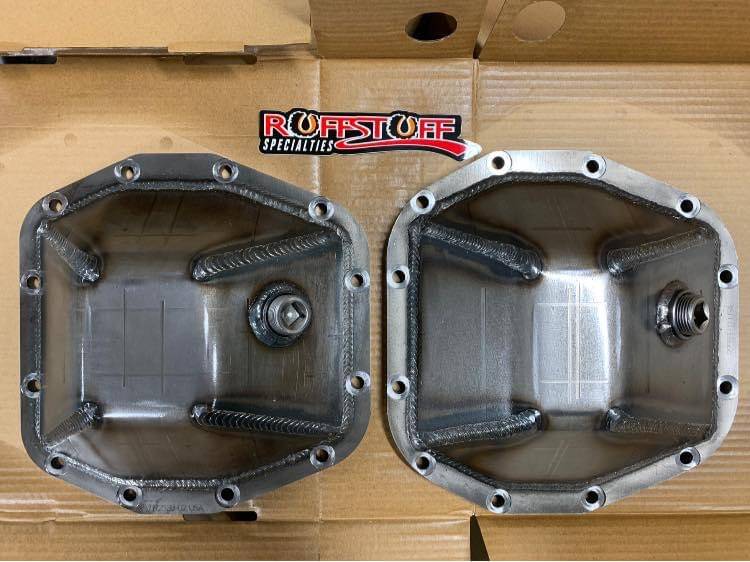

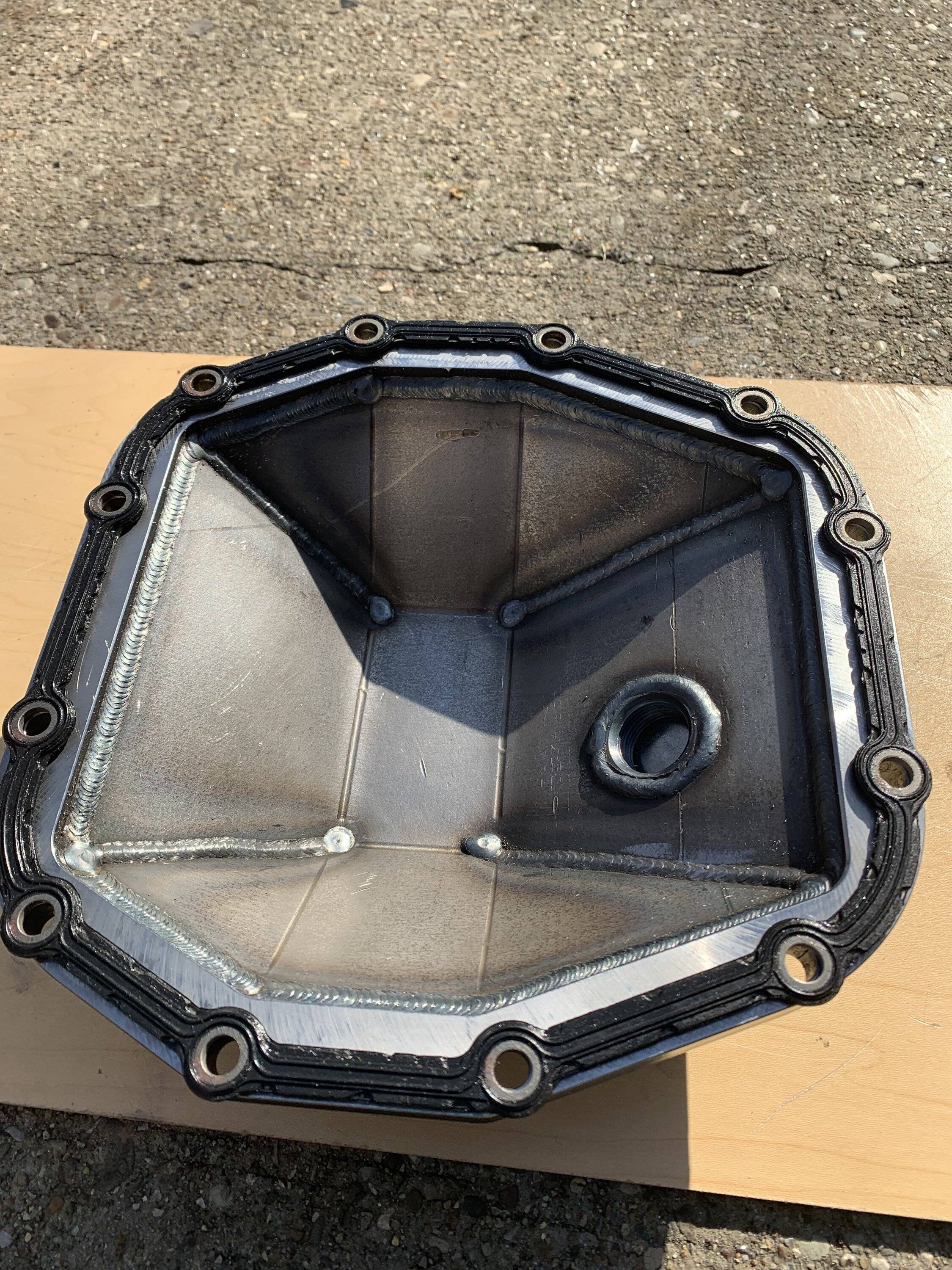

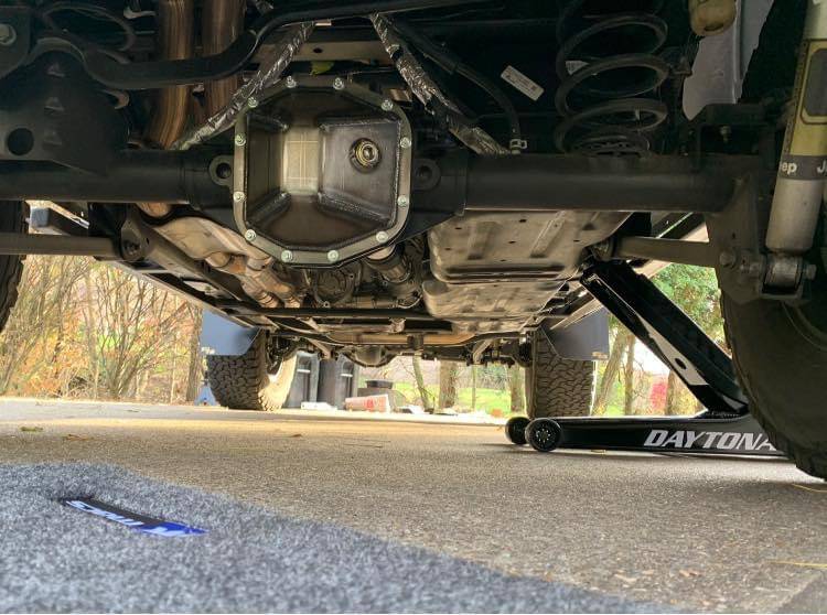

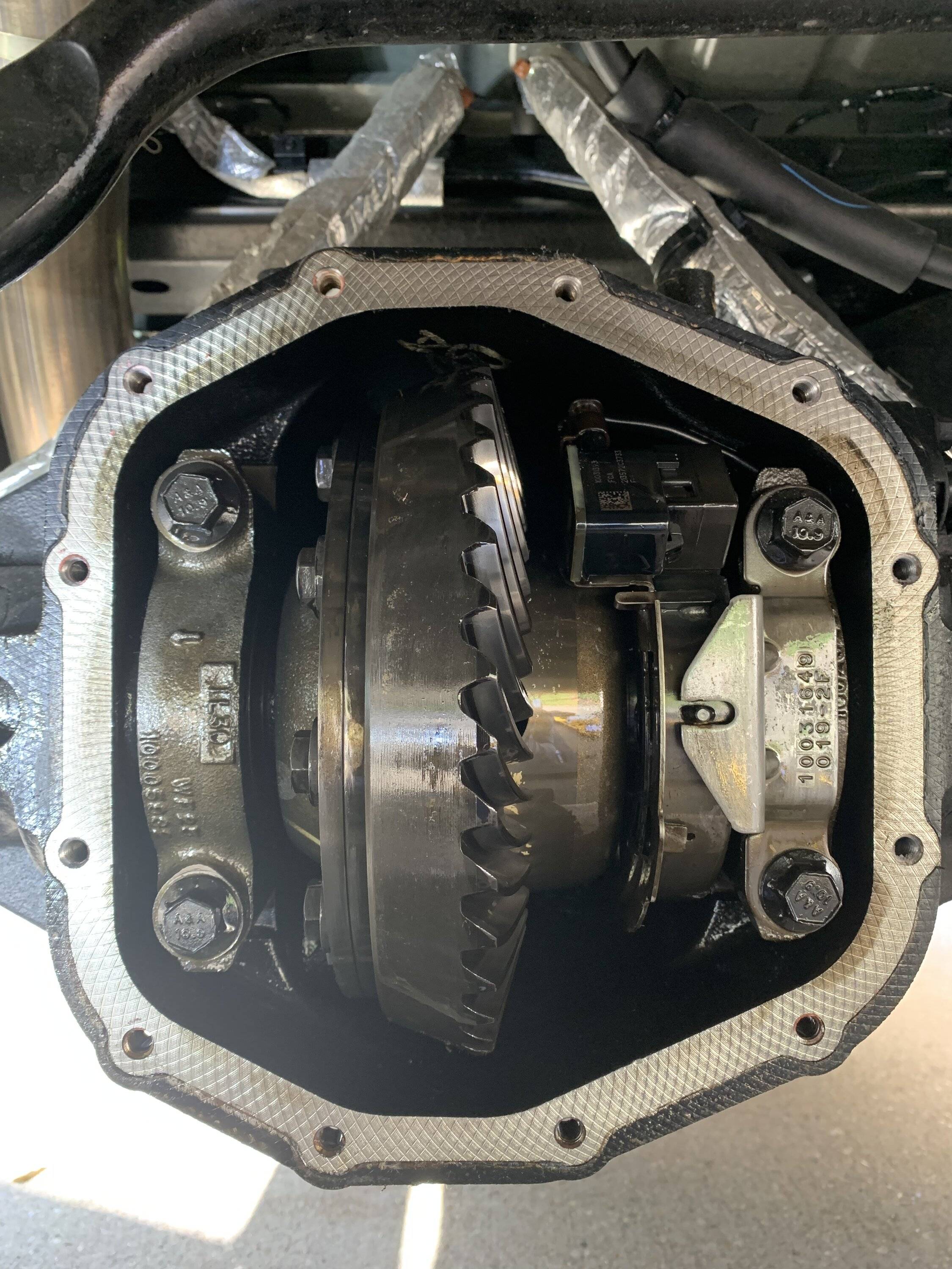

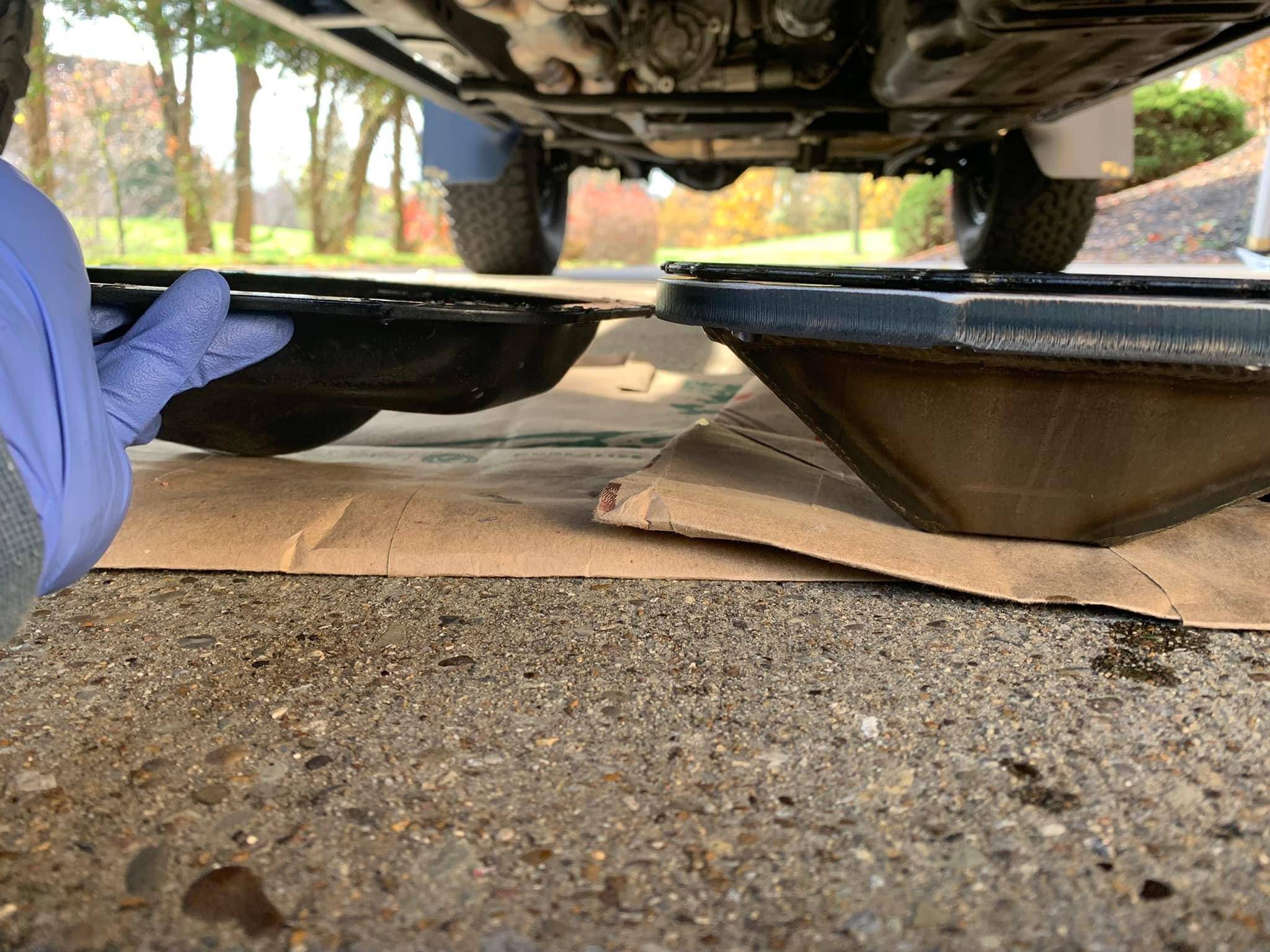

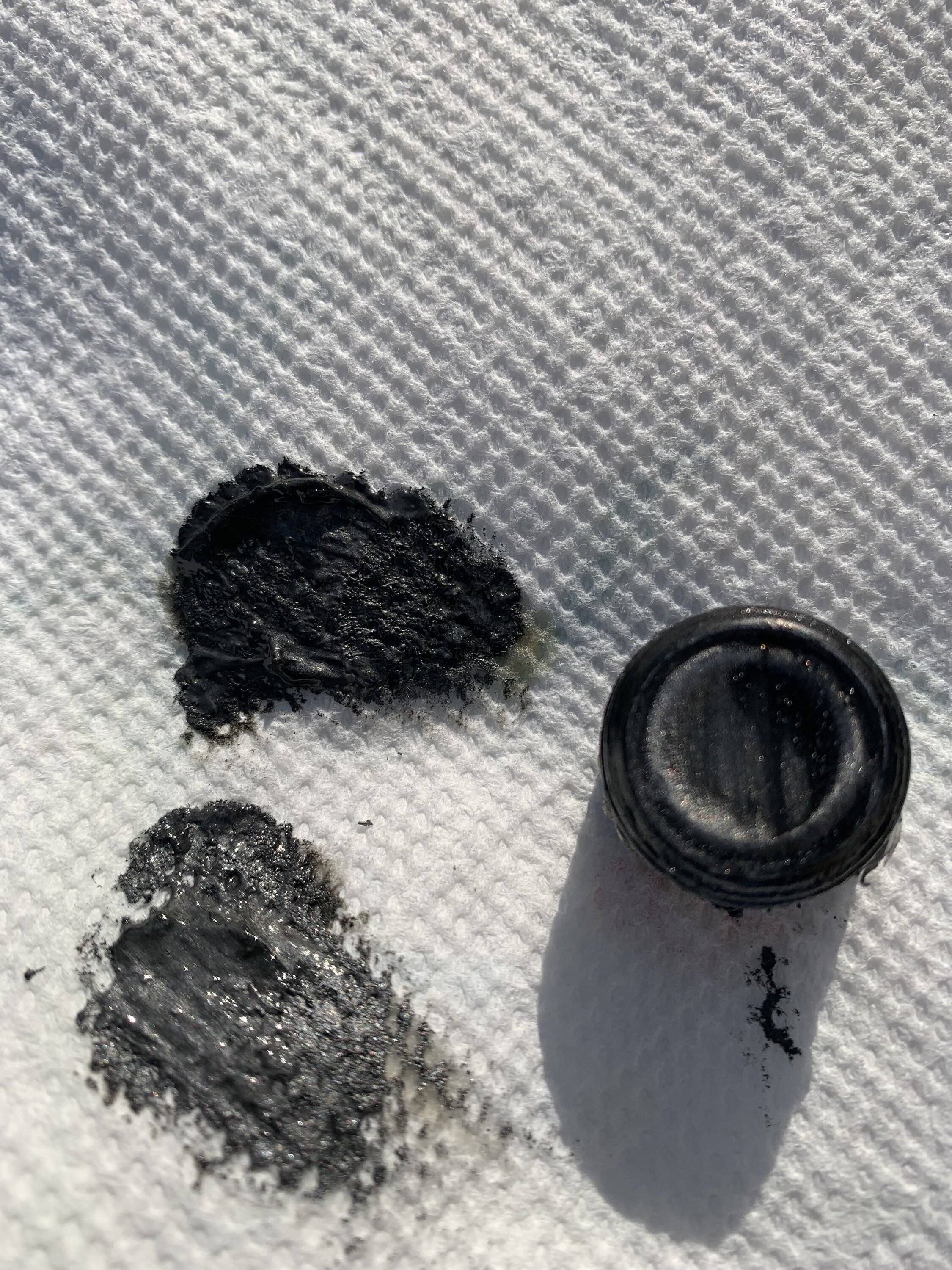

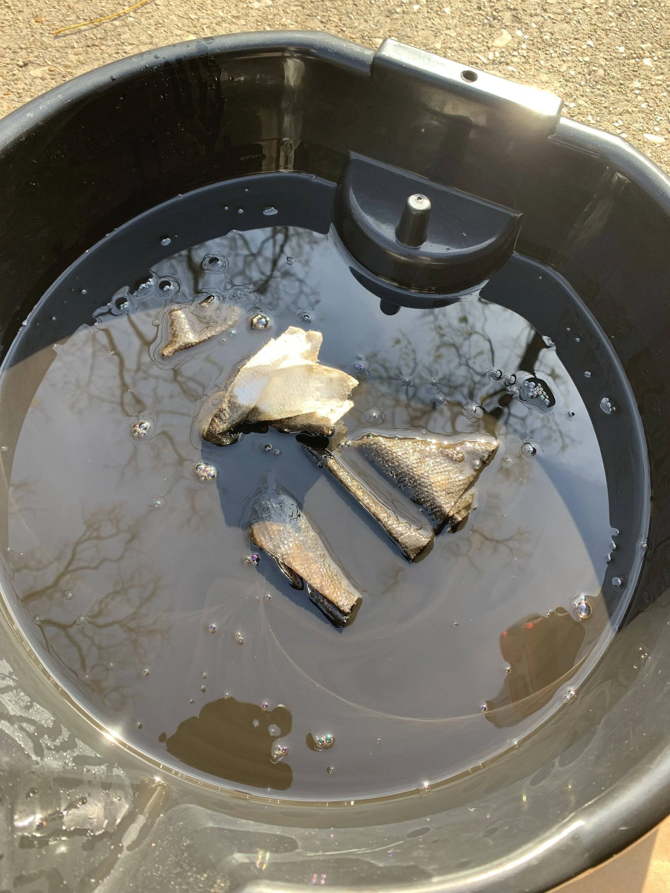

So I got the diff covers replaced today. Went with RuffStuff 1/4” thick ring and 3/8” cover. Really beefy and beautifully welded. Quality hardwares. Perfect fitment as well.
At 7500 miles, the rear fluid pretty dark already with normal metal shaving at the refill plug magnet.

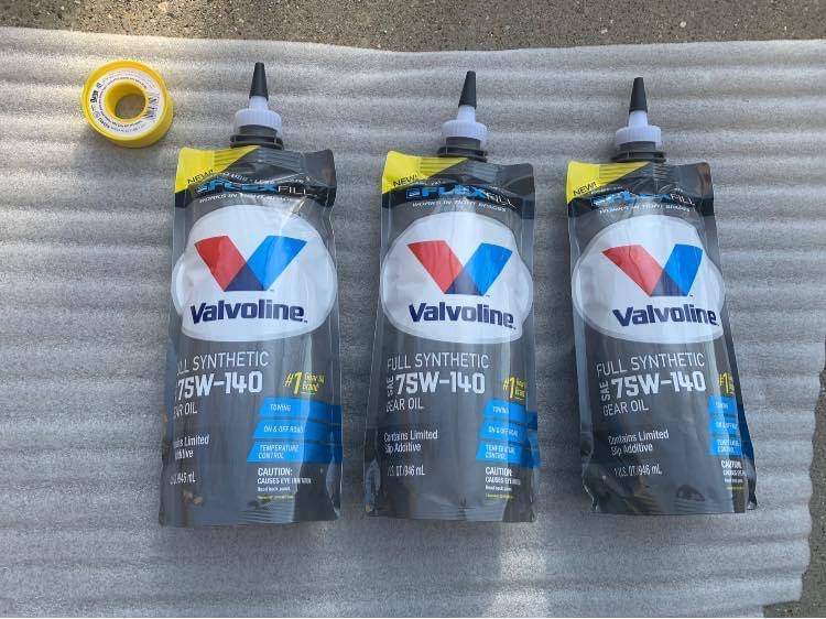

I cleaned and reused the gaskets. Refilled 75W-140 per @Rhinebeck01 recommendation. Thanks again. The FlexFill pouch worked well and I also jacked up the frame to gain more clearance which also helped when torquing the bolts. It was my fault that didn’t plan very well. I refilled two pouches in rear and still didn’t see the level close to the refill hole. Did a bit search on the capacity again. Pumped about 0.4-0.5 quart out to use for front.
I had to Jack up the frame near driver side front for room to work on the bolts. Refilled one whole pouch, then used 0.3 ish pumped out from the rear diff. It’s hard to measure the exact volume just by looking at the pouch. But I think I got the balance as close as I could. So 1.6 quart rear and 1.3qt front. Spilled a bit but should be fine.
Torqued the 12-point bolts to 25 foot-pound using my harbor freight torque wrench which I think should be fine.
All in all, took me 4 hours. I did not rush and I’m very happy about the end result. Not sure if any mpg difference with using 75W-140. My 392 only gets me 13.5 mpg on average and I can live with it.

@Rhinebeck01 and @CarbonSteel , not sure if there’s an agreed answer. I’ve seen lots discussions on the amount of gear oil to refill for the aftermarket diff covers. Some say refill to the refill port level and others go with manufacturers capacity.
Before I took off the factory diff covers today, I checked the oil level through the refill port and it’s at least 1/2” or more below the refill port. I didn’t measure because I don’t have a measuring cup available. Some people also pointed that some of the oil may still in reside in the axle.
Personally I’m included to follow the manufacturer spec because different aftermarket diff covers have different inner design and the refill ports may be placed at different height.
What are your insights on this? I’d imagine the diff ring gear always picks up the oil and throw it up so it doesn’t matter much if the refill amount is a bit more or less than spec capacity. Still want a more scientific reasoning which I couldn’t find online.
I fill it to the bottom of the fill port since most, if not all, aftermarket overs have slightly different shapes versus OEM and thus the capacity is also different from the OEM specifications.
It may be a bit more than the OEM but better to have that versus not enough.
I got an answer from RuffStuff Specialities:
We do not design them to have more fluid capacity. Me personally, have always put about an 1/8th of a quart over with our cover. You do not want to fill it to the fill plug.
So I think mine should be good.
Strange since it is basically a clone of Motobilt and they just say "fill the differential with oil".
If it is over the OEM level it should be totally fine.

On that same page they say this:
"Well the general rule of thumb is to fill your diff up until the fluid starts to run out the fill hole."
and this:
"With the after market covers we make you may find that they hold slightly more than the factory specs listed below."
Hence the reason I fill it to the bottom of the fill hole. Nothing is going to happen by doing that.
