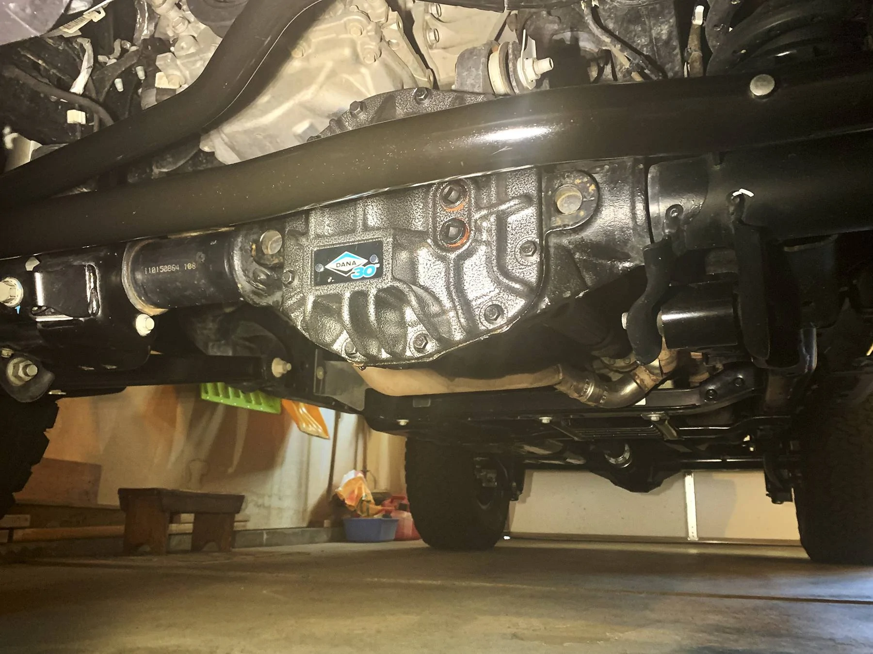

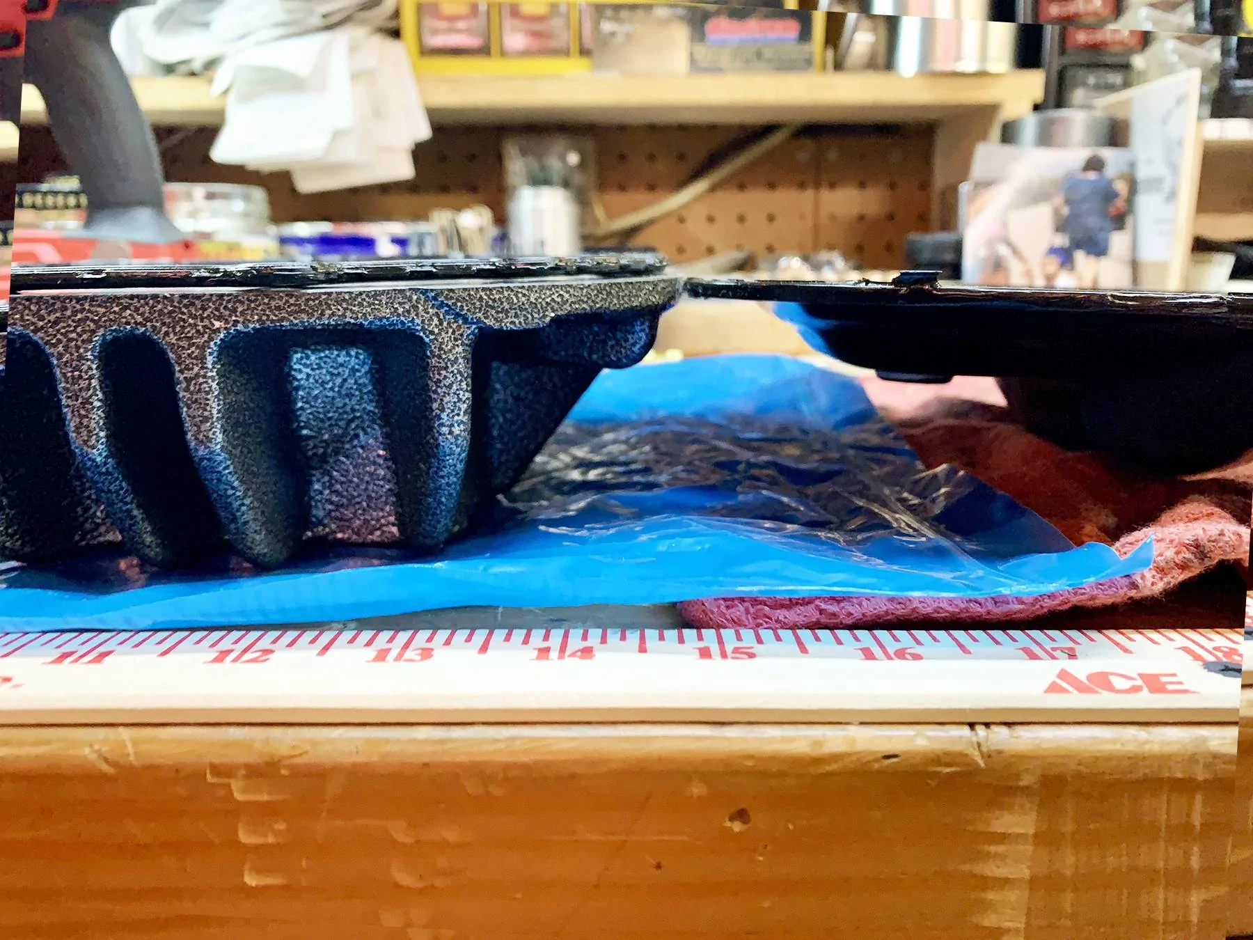

Hey Ricky,
I went through this a few months ago and received a ton of good advice from the guys offering recommendations here. It being my first time, seemed a little gripping at first, until I got into it and realized it's pretty easy. The big thing too is - don't over-tighten the bolts around the diff cover if/when you remove and put it back on. There's a lot of chatter about how tight is too tight. I think DANA says 25-30. I stopped just north of 20. The factory gasket should be re-usable at 20k miles. It's nice, with metal inserts around the bolt holes. As others have mentioned too, make sure to get the fill plug out first - before you drain it. Have fun! Oh - and I went 75-90 in the front, 75-140 (RoyalPurple) rear for all the reasons everyone mentioned (the Valvoline pouches eliminate the need for a pump, like the RP bottle would benefit from). Mine too is Anti-Spin M220 rear/Open M186 front. And the DANA nodular iron in grey gets my vote for best looking Diff covers ;-). Have fun!
Jeep Wrangler JL Differential oil change IMG_2814
Jeep Wrangler JL Differential oil change IMG_2818

Hey Ricky,
Uh.....my understanding (from watching videos, admittedly I haven't gone out to look at my actual axles) is that I have two plugs - a fill plug and a drain plug. I remove the fill plug first, then do the drain plug, then put them back in reverse order to fill.
I hadn't planned on actually removing the covers. Do I need to?
UPDATE: Just went and crawled underneath - I definitely have both drain and fill plugs on both pumpkins.
No, you don't need to remove the covers if you're just changing fluids. The reason to take the fill plug out first is sometimes people drain it first - then aren't able to get the fill plug out. Now your diff has no fluid and you're kinda screwed. It's just a precaution.
