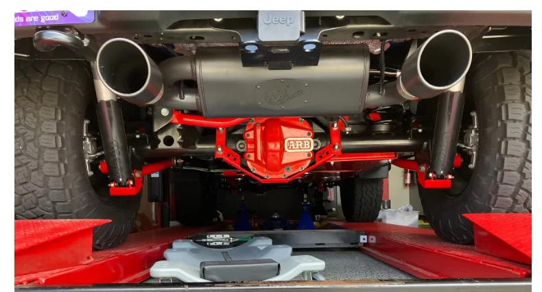

So I ran the ARB covers front and rear for about a year and a half. Initially wanted them because of the convenience of the drain plug. But in my experience, there were a few issues with it that didn't work for me in the long run:
1. the drain plugs are not at the lowest level of the diff, so you will still have old dirty fluid in there unless you remove the cover
2. The dipstick is impossible for me to read. I marked it as the instructions say, and I have the hardest time reading it. It's such a pain
3. The dipstick is right at the top of the diff, and collects dirt and mud all around it. No matter how thoroughly you clean it, you still have junk falling into the fluid when you open up the dipstick.
4. The finish is pretty low quality. It rusts very easily. I don't live in an area with snow or salt.
I switched to the Dana Spicer covers front and rear. Unfortunately, they don't have drain plugs, but they don't have any of the problems I had with ARB.
I have had the same covers on my 25 F-150 front and rear since I bought it and I have no complaints there, so this was an easy switch for me.
If you have ARB covers, and you like them, I'm not knocking you at all. I'm sure they work well for some folks depending on use case. They just didn't work for me.

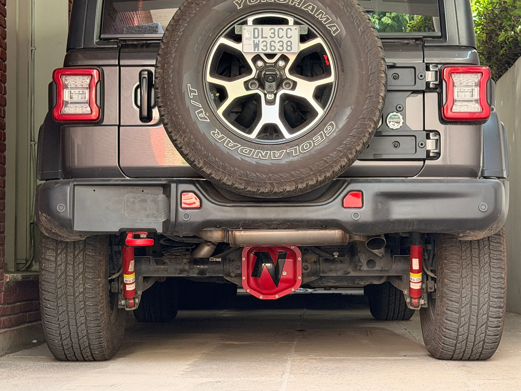

This is the Nitro Aluminum
Got it painted red to match the shocks. Original was raw aluminum

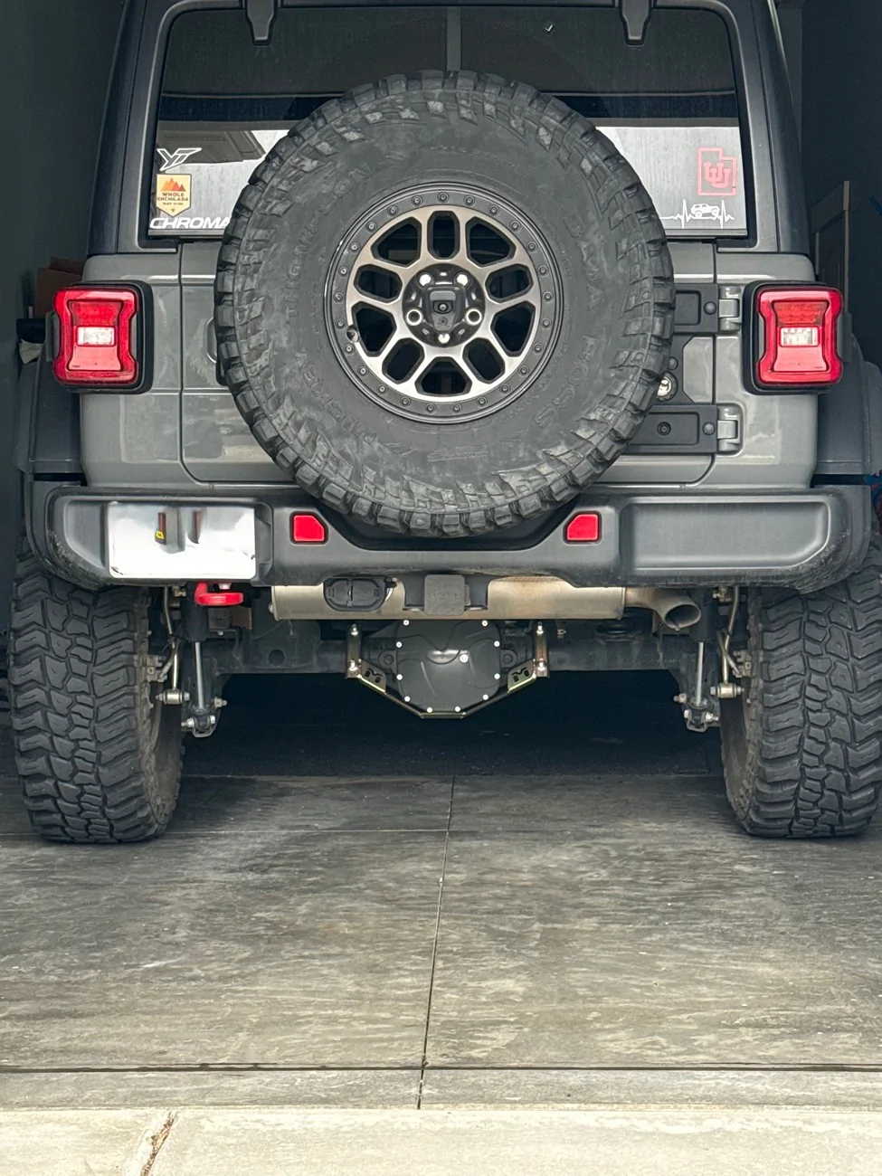

i used the Dana covers front and rear; i figured they oughta' know what they're doing.
Jeep Wrangler JL Differential Covers 1781374007509-hi
my concern was mostly flexion of the dif housing with the torque of the Diesel on 37s with 4.56s when crawling.
i don't hit stuff with them much, but the nodular iron is probably tough enough for what i do.
i'm certain they don't dissipate heat as well as aluminum might, but i change it frequently with good-quality lube and don't have any concerns on that point.
