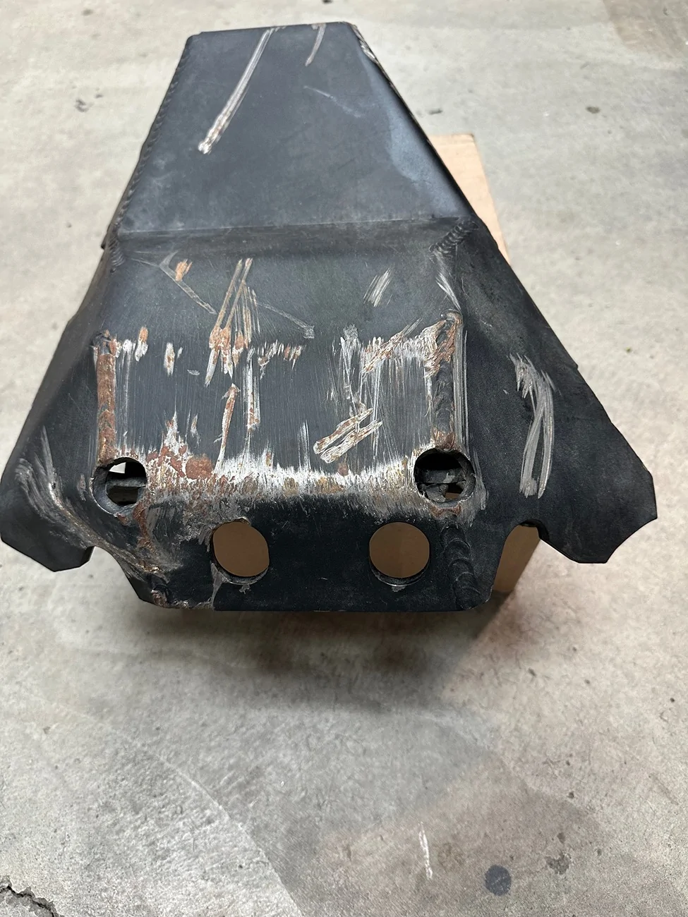

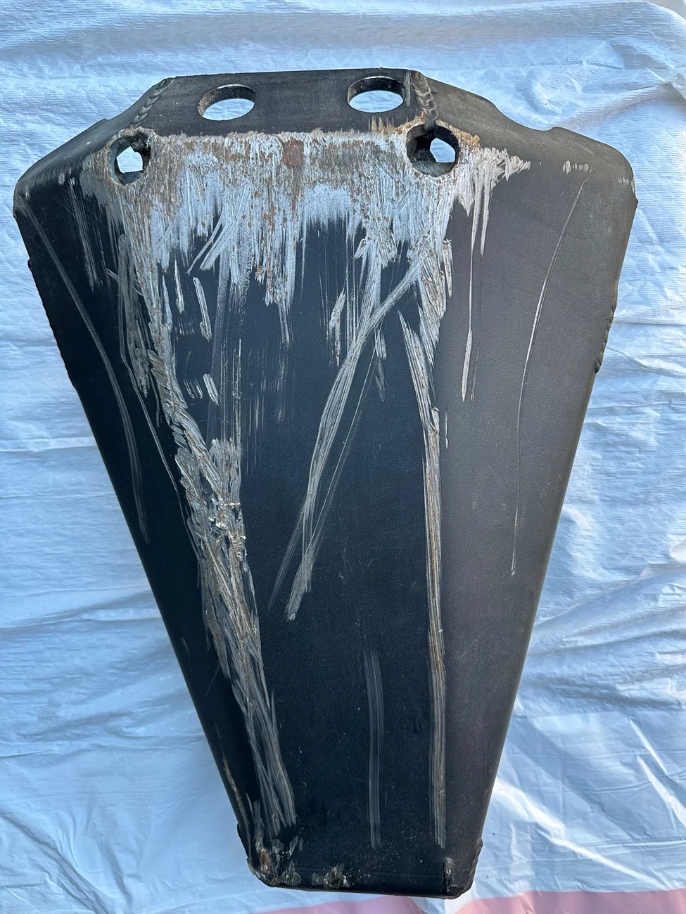

Typically it’s one or the other, thick heavy duty dif cover or dif skid to protect the thin factory cover.
I think it depends on what you are going to subject the Jeep to. They both serve a different purpose. The thicker diff cover to protect and add rigidity, and at least with the NV, a diff skid that protects the pinion, I’m not hard core and probably just use poor judgement, but I wouldn’t give up either. These have been resprayed multiple times.
I use red rust oleum to keep mine looking like new - over the gold color of metacloak

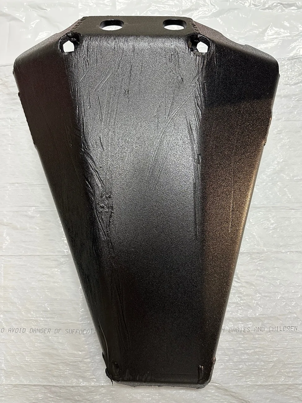

I use @wibornz recommended Rustoleum truck bed paint. Dries in an hour or less and a slight texture helps with any painting flaws. Still wet in this pic
