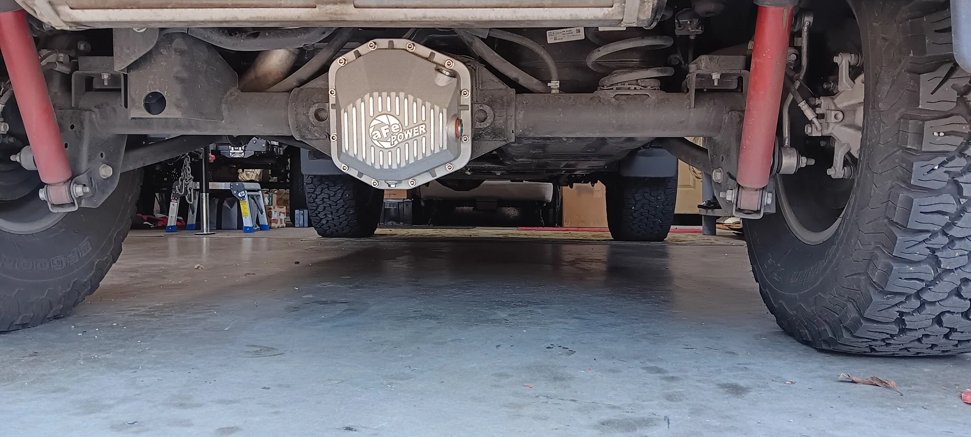

Hard to beat AFE's diff cover...beautifully machined, fill plug, drain plug, sight window, doubles capacity to 2.2 quarts, has 2 magnets, one on the drain plug and one on the fill plug with a rod that extends down, aluminum construction with some cooling fins. Put the best gear oil in it: Redline.
This is what I'm running, but in raw aluminum.

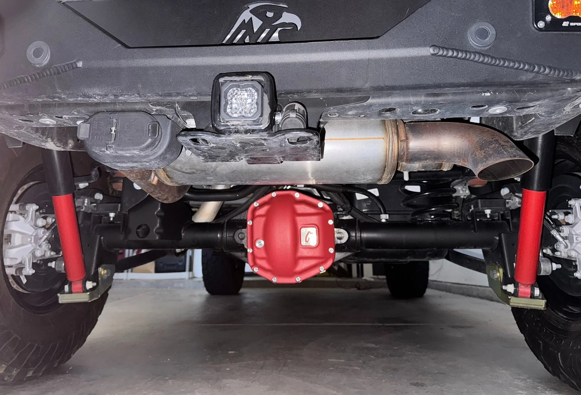

24' Rubi X JLU and went with Currie Diffs (front and rear). The control arm skids in the pic are MetalCloak.
Jeep Wrangler JL Differential Covers 1781281735375-k5
