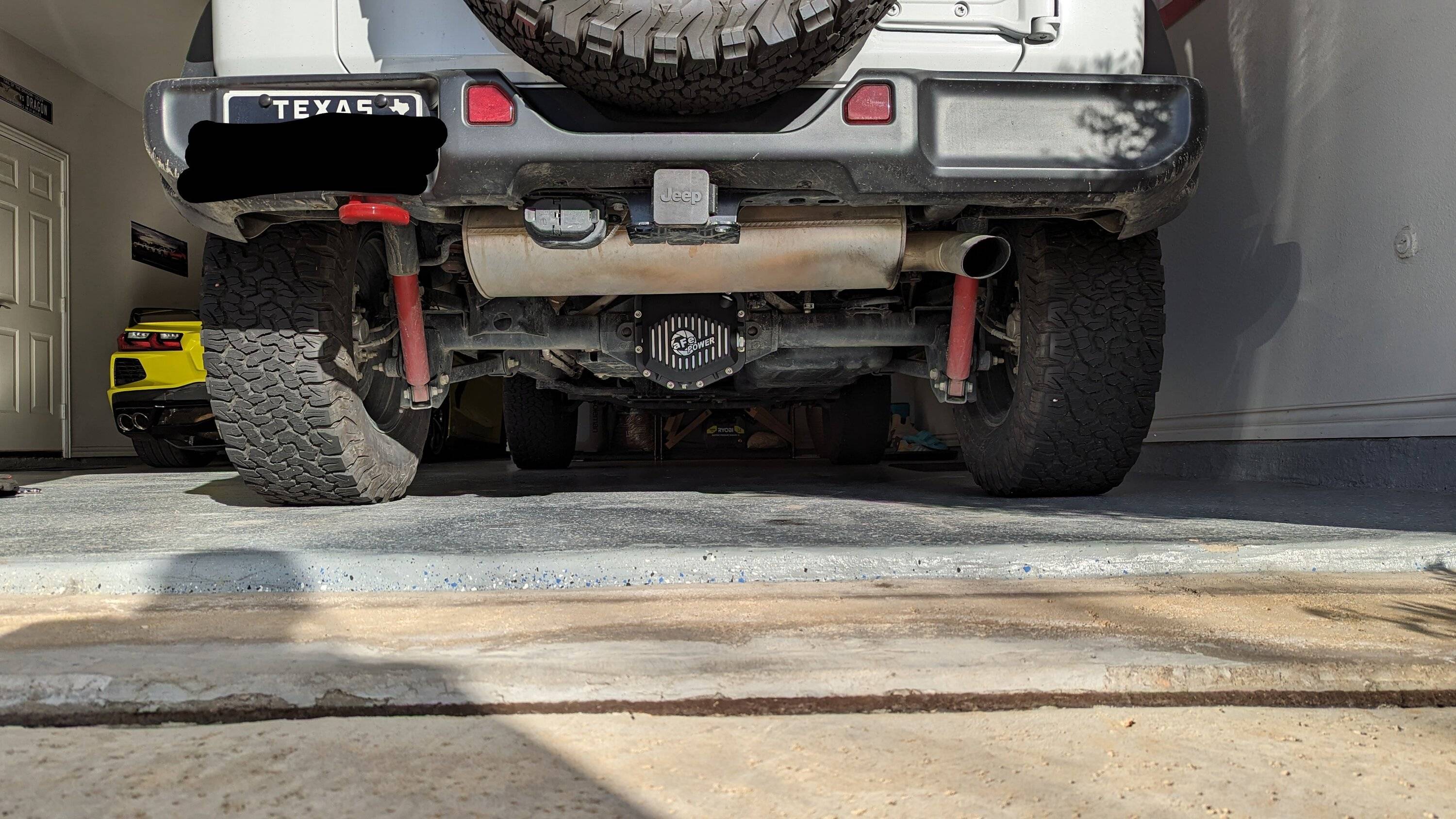

I ordered this set on Black Friday after taking some trail rock damage to the rear differential housing & cover at Hot Springs Off-Road Park Thanksgiving day (my wife is chasing those badges!).
https://afepower.com/46-7100ab-pro-series-differential-cover-black-w-machined-fins

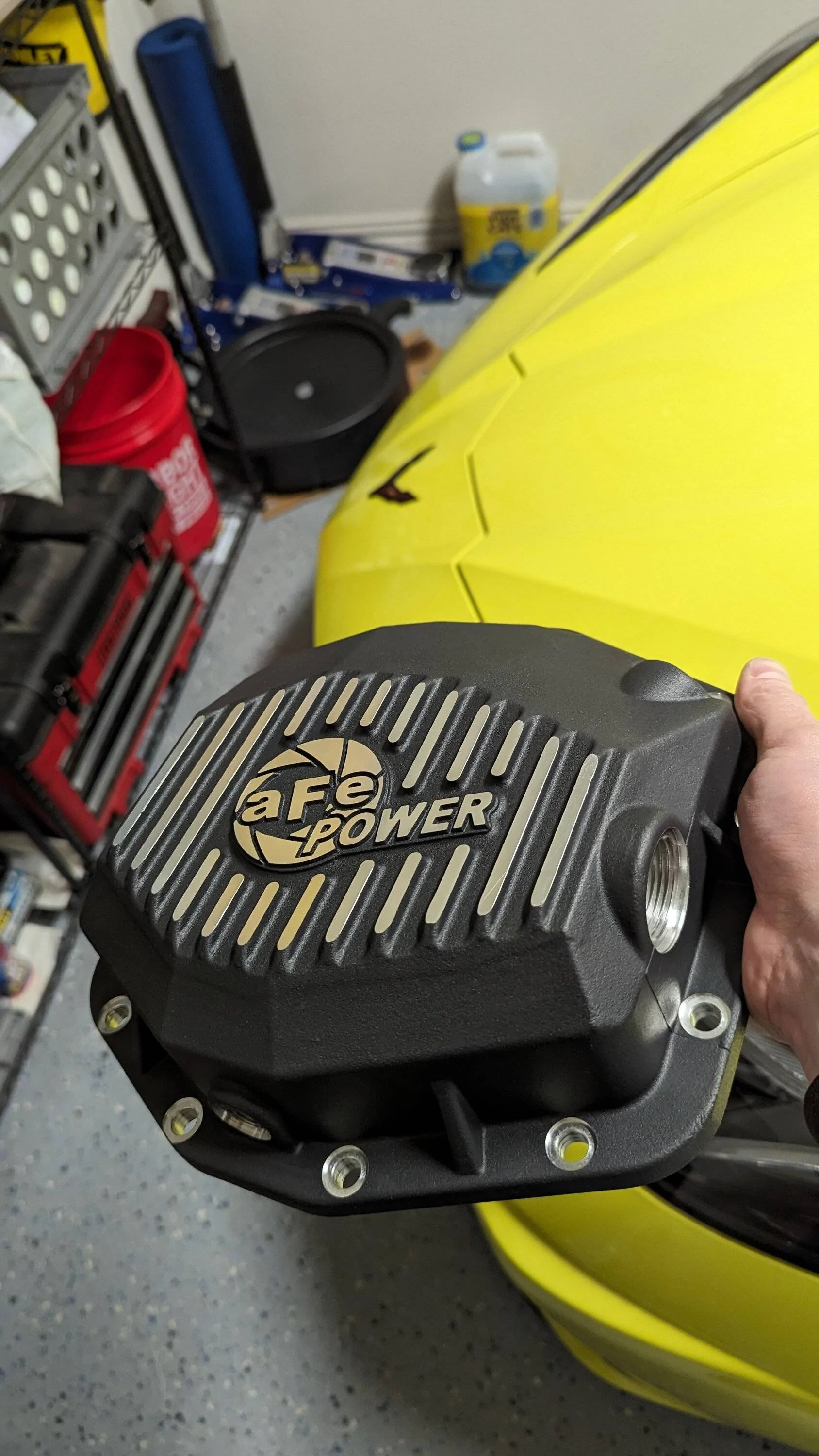

The rear cover installation couldn't have been easier and literally took mere minutes. I spent the most time just cleaning out old gear oil. I do wish the sight glass was recessed for protection like it is in the front cover.

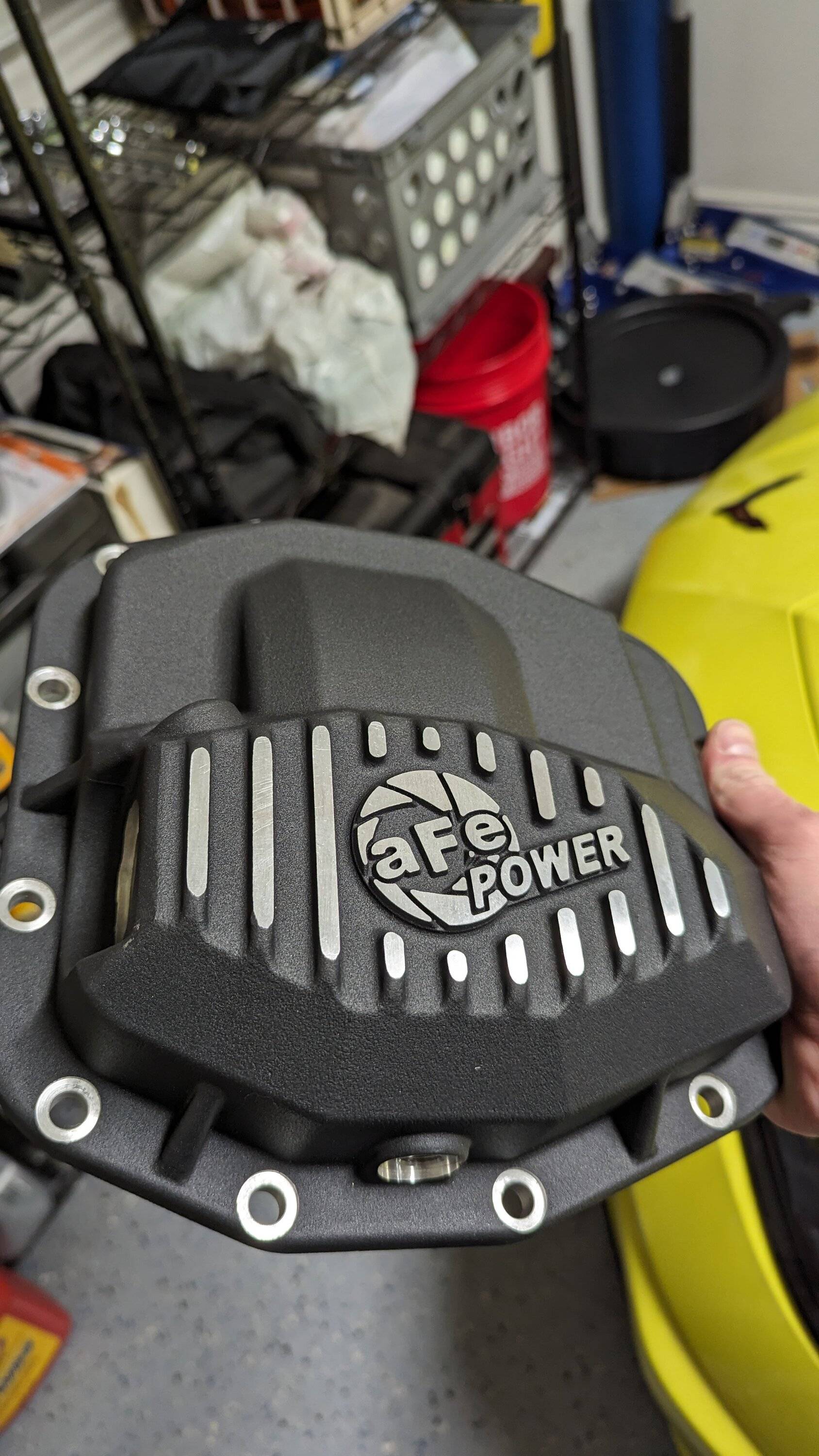

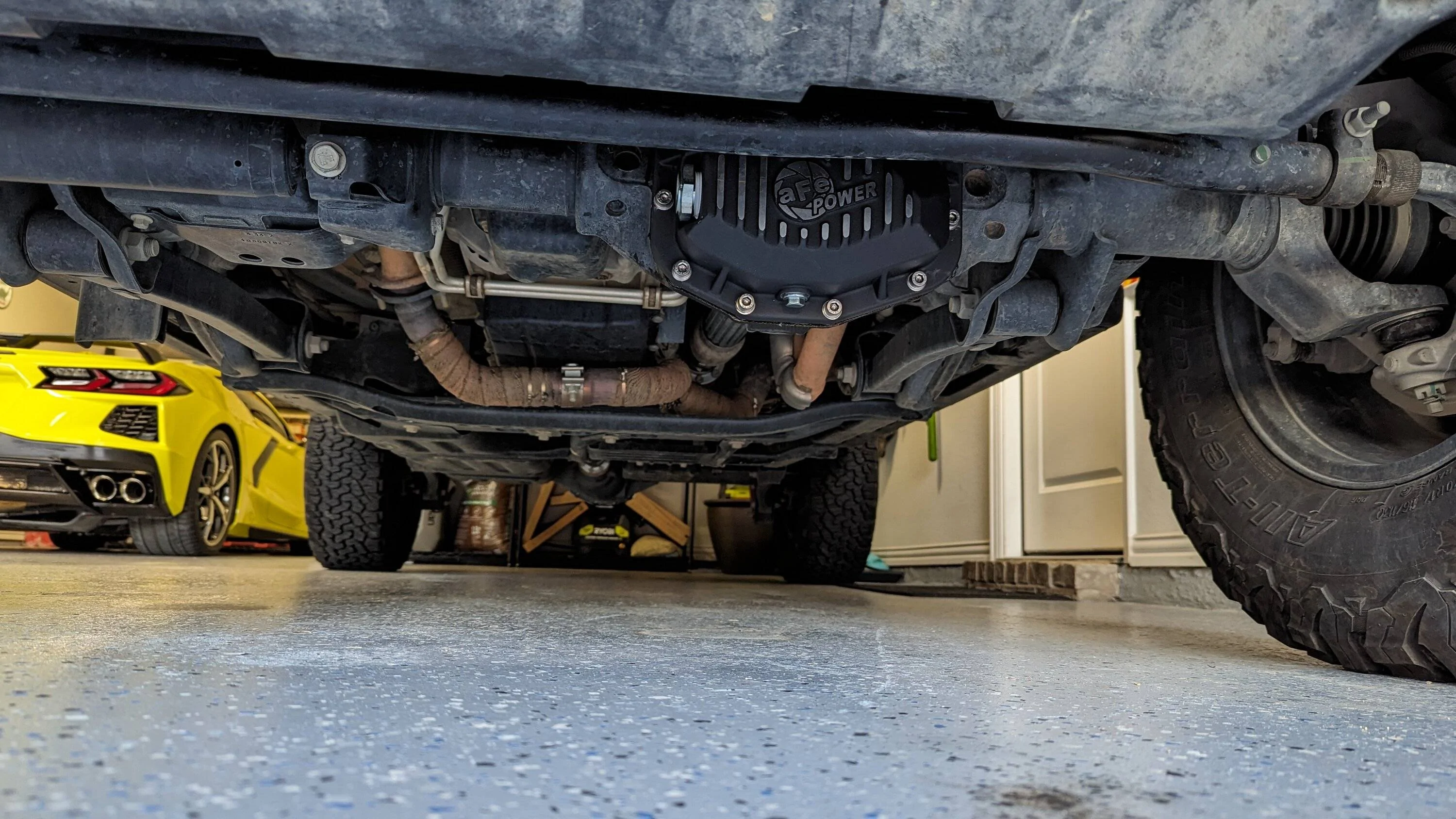

The front cover installation is possible with the Jeep still on the ground but does require some hand gymnastics to wiggle around all the suspension components up there. I had to reuse 3 of the factory 10mm bolts at the top (out of sight) since I couldn't maneuver a hex wrench or socket up there.
No problems reusing either factory gasket. I'm glad they both have drain plugs too for easy fluid swaps. The sight glass bolts did NOT come pre-installed as the instructions stated so you'll need a 1½" socket to install those. The cover bolts are 6mm hex. Overall, I couldn't find a ton of info on these prior to ordering so wanted to share my impressions. I've been a fan of aFe for over 2 decades and have run their stuff on numerous sports cars and now this Jeep too. They're thick & beefy cast aluminum but should still do a nice job dissipating heat. The front cover holds about 1.5 qts of fluid while the rear takes a little over 2 qts (4 qts is enough to do both). I actually didn't use their included fluid (relabeled Amsoil) and stuck with Redline 75W-85 which I used when swapping out the factory break-in fluid.

Still very happy! They're doing their job and fluid is staying nice and clean & fresh looking over a year later. My wife has hit them on a few rocks while chasing Badge of Honor trails so they're a little scrapped up, but they took the hits like a champ.
After our last long roadtrip for 5 BoH badges I pulled the magnetic dipsticks to ensure all was well and nothing concerning was found. Just a little magnetic residue so a quick wipe and reinstalled they went.
I'm still running them with Redline 75W-85 GL-5 gear oil.
