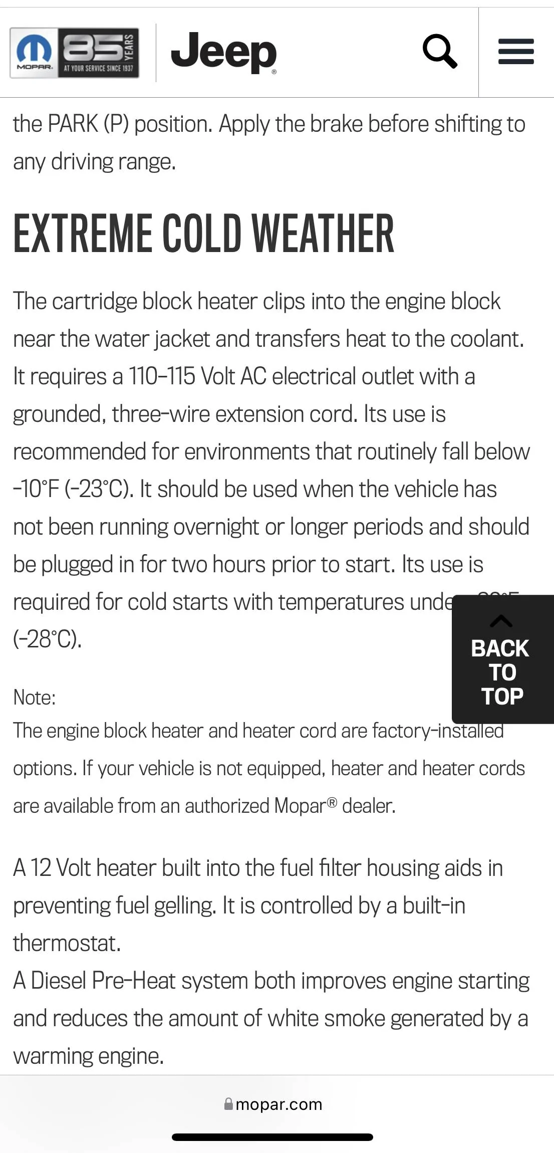

Yes, my thoughts too.Like @Scott.B said I didn't order it because it wasn't available at the time. I figured it was a supply chain thing and I could add it later anyway, which I plan to whether I need it or not.
Thank you to all contributers of this thread. As it stands, there is no option on the website builder or in the order guide for the 2022 ecodiesel.
