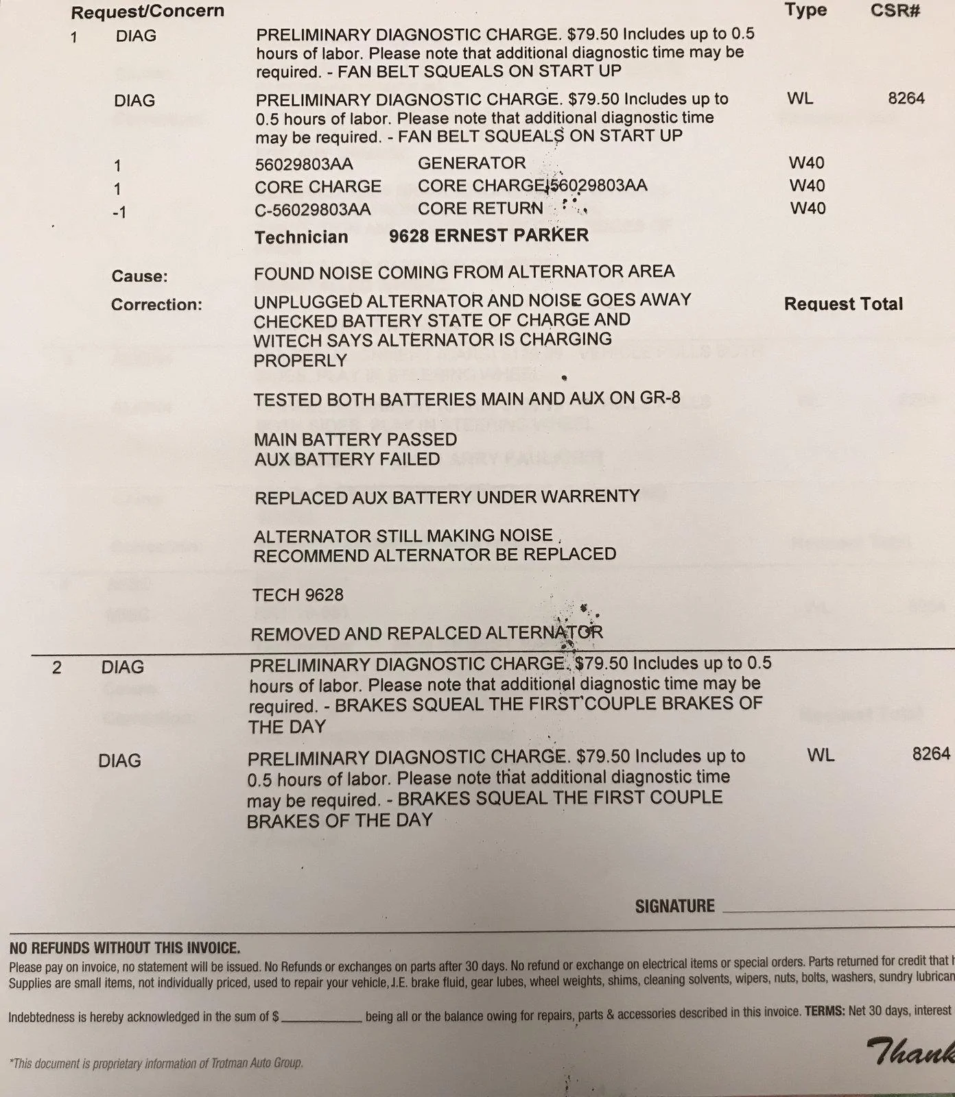

I bought my 2019 Wrangler Unlimited Sahara in January since then they have replaced the stop/start module, alternator, second battery, it’s now in for front brakes, rotors, water pump, hoses, tubes and who know what else.. I just took it in for fan belt squealing and wandering ...

I will also put my BS flag back in my pocket. Still only see a faulty alternator from initial work orders, though. Something else is afoot. Very possibly an inept service tech also. Dealerships have been know to play "parts darts" by throwing replacement parts at a problem in the hopes of getting lucky.

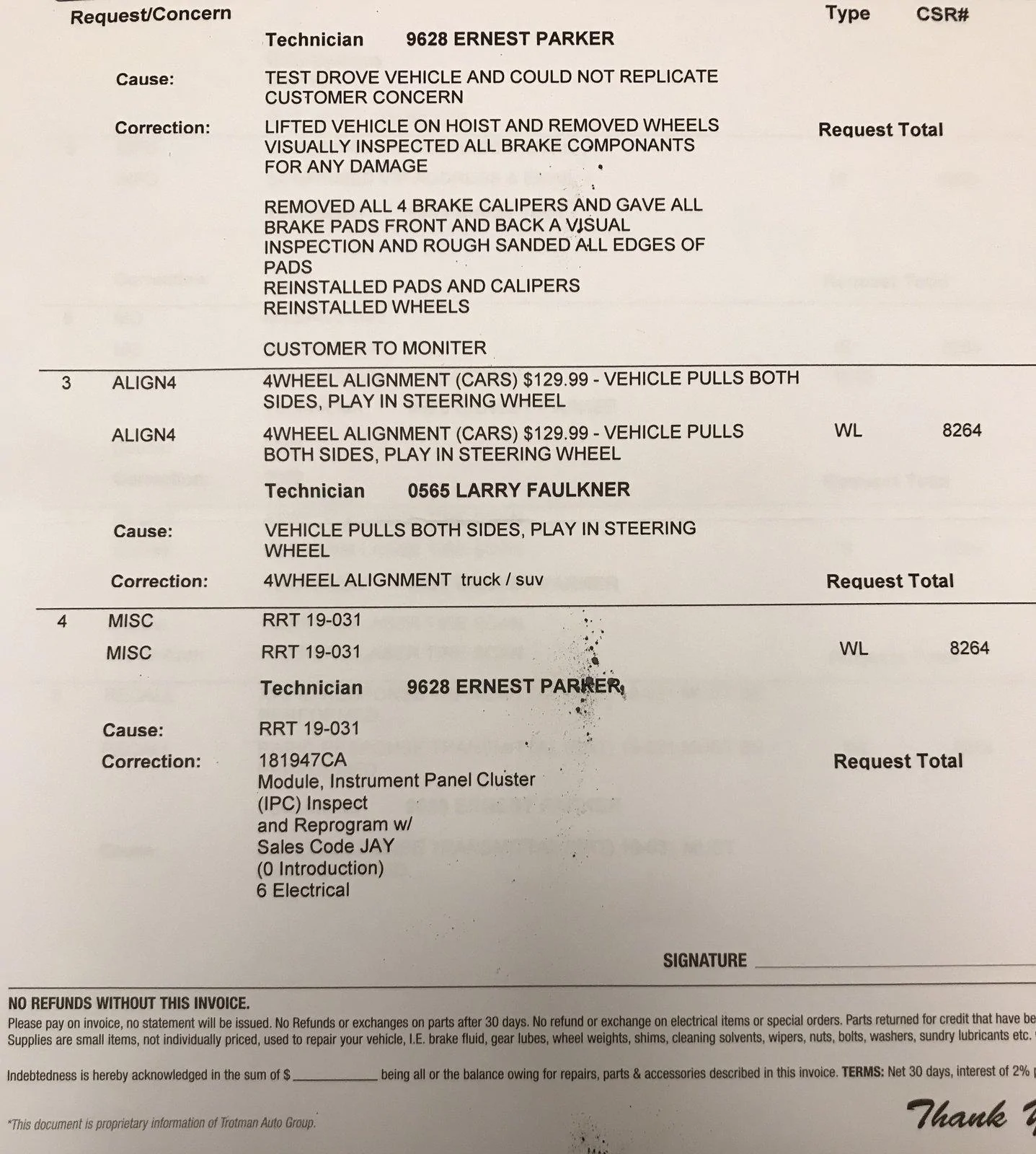

Lots of factors can influence brake performance. Certain pad compounds will squeal until they get a little heat in them. If the Jeep is parked outside in a high humidity area, possible rust film on the rotors would have to be scrubbed off on the first few braking cycles each day. Generally the only reason to replace rotors is for uneven wear, but this would result in a braking shudder, not squealing.
Now that we have offered penance, interested in the balance of your issues - especially the reasoning behind replacing the water pump and hoses. Did they determine that maybe the alternator was not the source of drag causing the belts to squeal?
