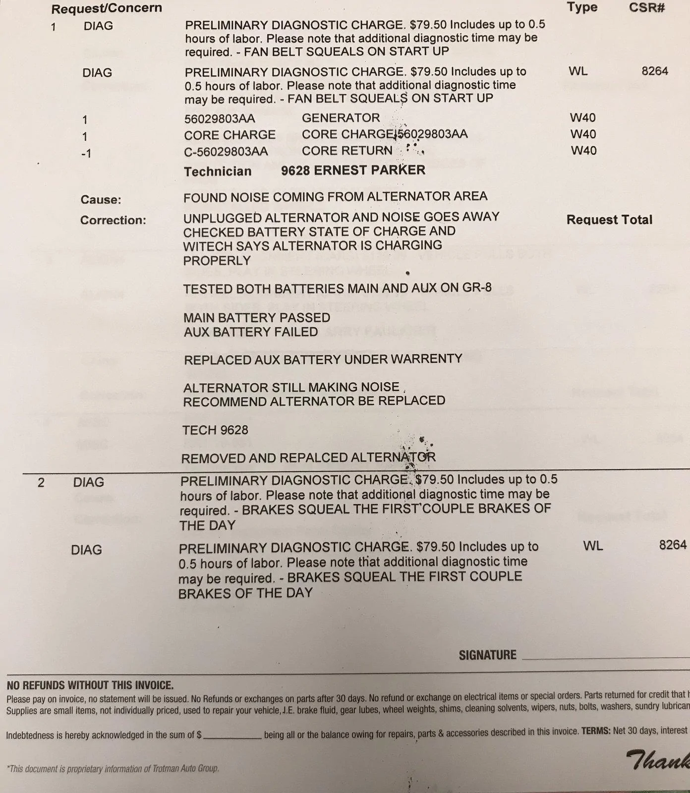

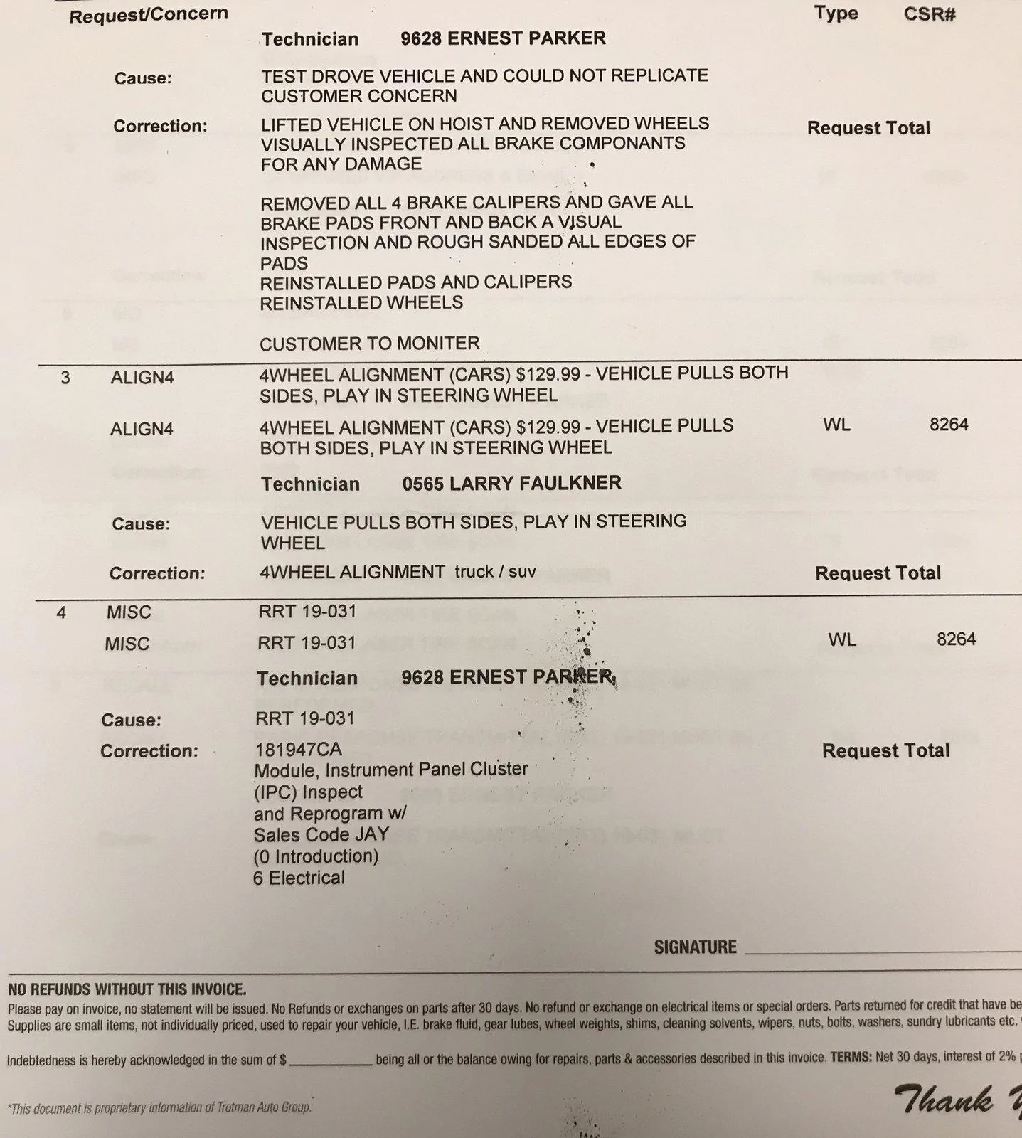

Seemed like you just have a faulty alternator that fried your aux battery and blowing the issue out of proportions. Other issues are non-issues to be honest, squeaky brakes? Quiet normal, your rotors and pads are fine. mine does the same in the morning. Wheel alignments? Well I agree that’s a known issue there but has been covered to death on this forum anyways.

Seemed like you just have a faulty alternator that fried your aux battery. Other issues are non-issues to be honest, squeaky brakes? Quiet normal, mine does the same in the morning. Wheel alignments? Well I agree that’s a known issue there but has been covered to death on this forum anyways.
Well it’s not just squeaky brakes now they are changing them, putting on new rotors and they have also found a problem with the water pump so they are putting on a new water pump and hoses, been at the dealership for the last 2 weeks going on three, waiting for parts that are nowhere to be found.

I think I read somewhere that because of the materials used, these brakes will squeak when cold, or when wet. So let us know if replacing rotors and pads did anything at all. They all squeal after driven for a while, there is a long brake squeal thread here on this exact issue.

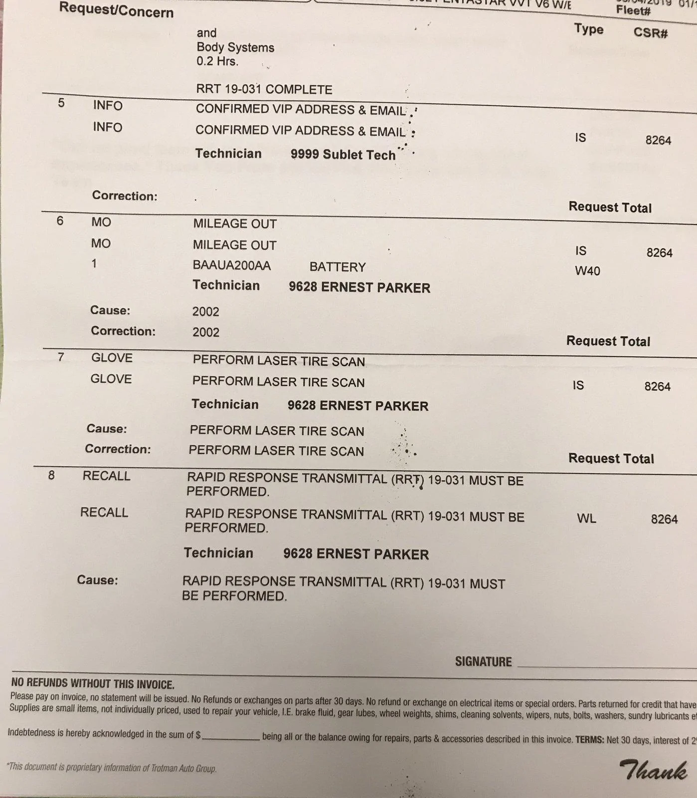

I bought my 2019 Wrangler Unlimited Sahara in January since then they have replaced the stop/start module, alternator, second battery, it’s now in for front brakes, rotors, water pump, hoses, tubes and who know what else.. I just took it in for fan belt squealing and wandering ...
hmmmm all with 6 months and it only got 3000km
Not Good!
I'm curious. I know you're in Canada, but it took over a month and a half to get my alternator off of backorder. I assume you did not have this issue?

I will also put my BS flag back in my pocket. Still only see a faulty alternator from initial work orders, though. Something else is afoot. Very possibly an inept service tech also. Dealerships have been know to play "parts darts" by throwing replacement parts at a problem in the hopes of getting lucky.
Lots of factors can influence brake performance. Certain pad compounds will squeal until they get a little heat in them. If the Jeep is parked outside in a high humidity area, possible rust film on the rotors would have to be scrubbed off on the first few braking cycles each day. Generally the only reason to replace rotors is for uneven wear, but this would result in a braking shudder, not squealing.
Now that we have offered penance, interested in the balance of your issues - especially the reasoning behind replacing the water pump and hoses. Did they determine that maybe the alternator was not the source of drag causing the belts to squeal?

Hmmm, is your service department trying to get a fat check for "warranty" repairs?:movember:
I liked that "$79.50 diagnostic fee" plastered all over the work orders, despite it being in for warranty work.
